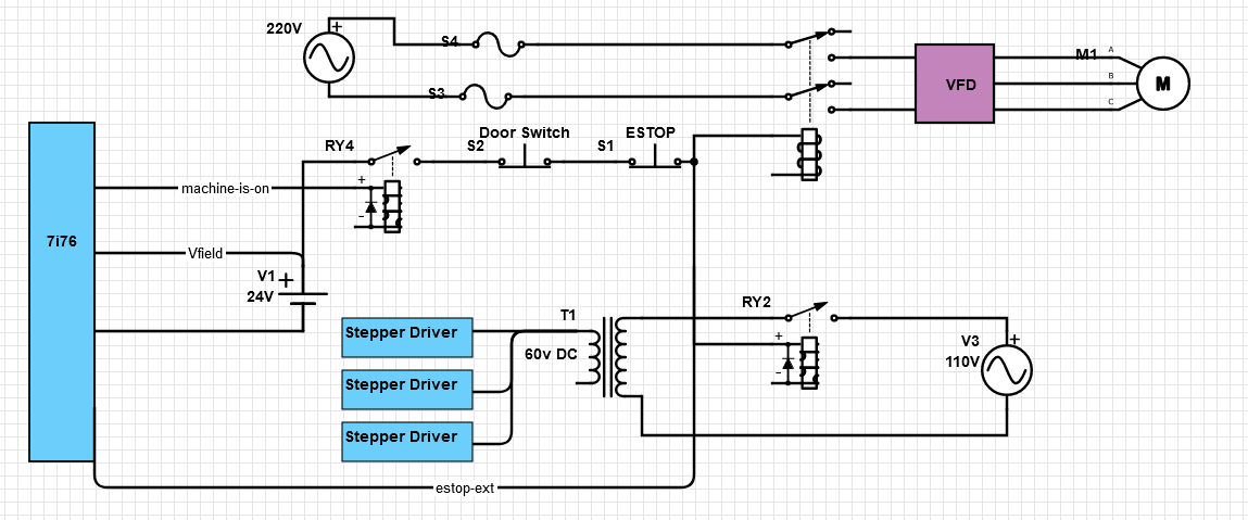

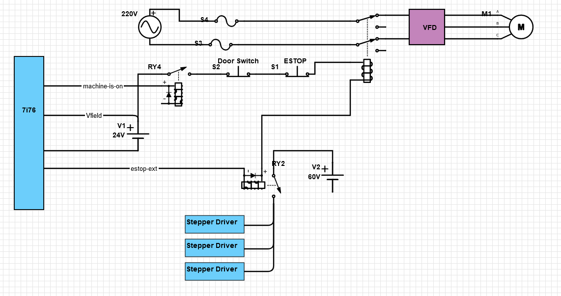

04 May 2021 22:28 #207888
by rfrey
Replied by rfrey on topic First steps for re-doing electrical
It seems like the e-stop circuit is the hardest, and if I get that I'll have it licked. That's probably naive but I'm going with it.
estop-ext will be tied into the estop-latch component that I've read about here, so that either the software or the hardware can trigger the estop, but if it's triggered it will have to be cleared on both hardware and software.
Does this look reasonable? Am I missing something?
- Posts: 18093
- Thank you received: 5325
04 May 2021 22:40 #207890
Replied by PCW on topic First steps for re-doing electrical
The AC VFD contactor is in series with the step motor power relay (should be in parallel)
Also its likely that the step motor drives will not like switching their DC power.
its better to switch the AC side of the step motor power supply.

04 May 2021 23:29 #207901
by rfrey
- Posts: 18093
04 May 2021 23:38 #207904
That looks good.
