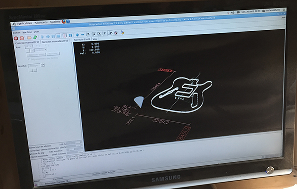

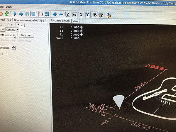

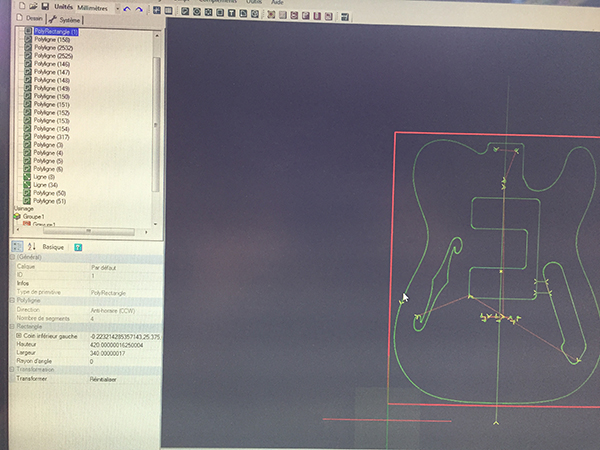

I got a Telecast body in Cambam (the program that came with my CNC machine). I created a Gcode and when I took it to my LinuxCNC to have it made, the CNC just got crazy.
Why?
Because my 42cm or so turned out to be transformed in 13m long body...
I sent a request to the cambam forum where some more expert people than me said the Gcode is fine. So the trouble, according to them, is LinuxCNC that just don't convert metric-inch or inch-metric stuff...
Do you have an idea? I just don't know what to do and I hope someone there coud help...

04 May 2021 18:55 #207861
Replied by andypugh on topic LinuxCNC seems to make cambam nc way too big
Looking (hard) at the last screenshot I think it looks like the program there begins with a G20, whereas the one you posted has a G21.
G21 is what it should be.
Are you perhaps not opening the file you think you are opening?
- takeitslow
- Posts: 7
04 May 2021 19:01 #207862
by takeitslow
Replied by takeitslow on topic LinuxCNC seems to make cambam nc way too big
Dear andypugh,
If you see something like this it's just because I tried once to make the CNC running. It went crazy. I stopped iit in a hurry, maybe made a picture... Tried again and then came back to Cambam to try to find out what was happening. Then I created a new NC program, tried again and had the same error. Then I took another picture thinking that i was a problem with Cambam (and went to search advice on the Cambam forum)... They told me that it was probably the Linux...
It was really something like that about the pictures so maybe its not completely "picture one" going with "picture 2 or 3" but I have now only one NC and that Cambam...
