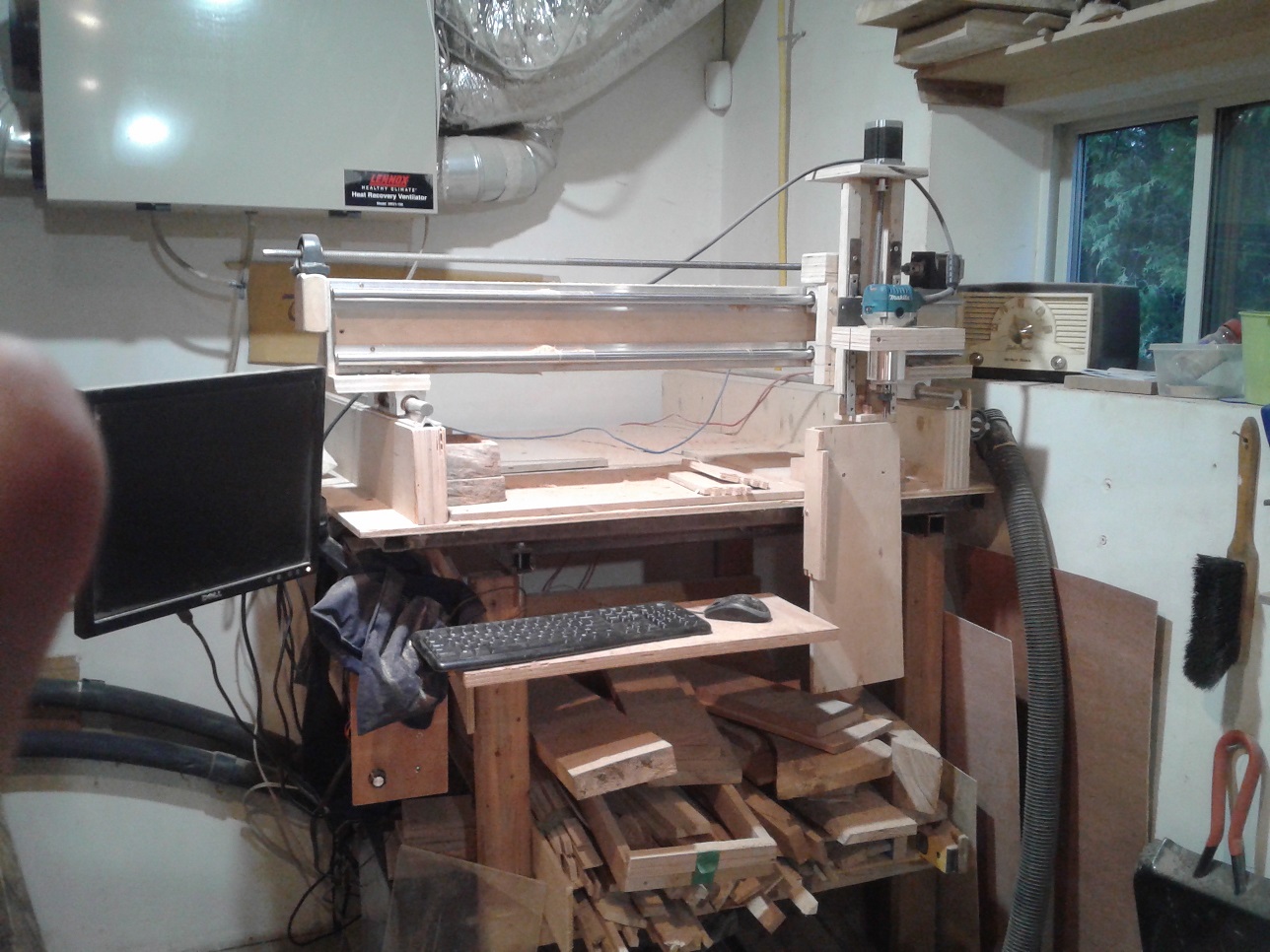

I have a functional home built cnc machine. I have read up on settings but lack understanding or checklist to test aspects of the machine to configure linuxcnc the best for this machine. Also testing feed rates and jog / max speeds. I did a simple circle test with 5 passes .125 z drop per pass. 30 in/min as a feed speed works nice but 40 I miss y steps. Now I have an issue with the y with a very slight bend in the lead screw which I am blaming the issue limiting the speed on. Also when I try and vcarve text the z drops and loses 0. Might be a lot of things but this is why I am looking to understand testing configurations. Any resources to help with this would be great to know.
Description of my Machine.
Simple gantry X,Y,Z machine. 24V Nema 23 Motor's, 1/2 inch acme lead screws, 8:1 screw. Old Dell computer with parallel port. Mikita compact router for spindle
Any direction or help with a checklist to test from the bottom up would be great.

Pictures, motor size and torque, weight of the moving parts, etc, etc?

Attached are pictures of my setup. Shamefully I do not know the weight of the z fixture and gantry. I need to replace the y screw so when I pull it apart I will weigh the units. Also shamefully the picture of the wiring leads me to believe I have no self respect but I was leaning toward getting the cnc running and do plan to rewire it as I need to add limit switches. I understand I asked a question about specifics when I haven't done the leg work so all I can do is revisit this after I do more research. If you are wondering what the thing in the picture is, it's a vertical mount as the z axis can stick out 3ish inches from the front. I was doing finger joints for a box and was experimenting with joinery. Thanks.

A quick and dirty fix for lost steps when the machine is marginal can be to reduce the acceleration limits. In some case lower acceleration will actually allow you to increase the max velocity.
Though, it can often be the accel that sets the cycle time if the G-code is many short segments.
