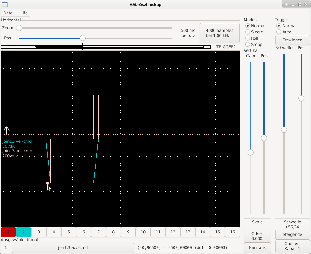

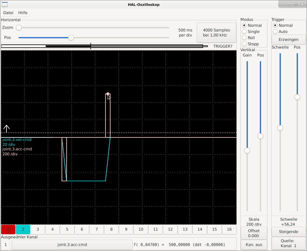

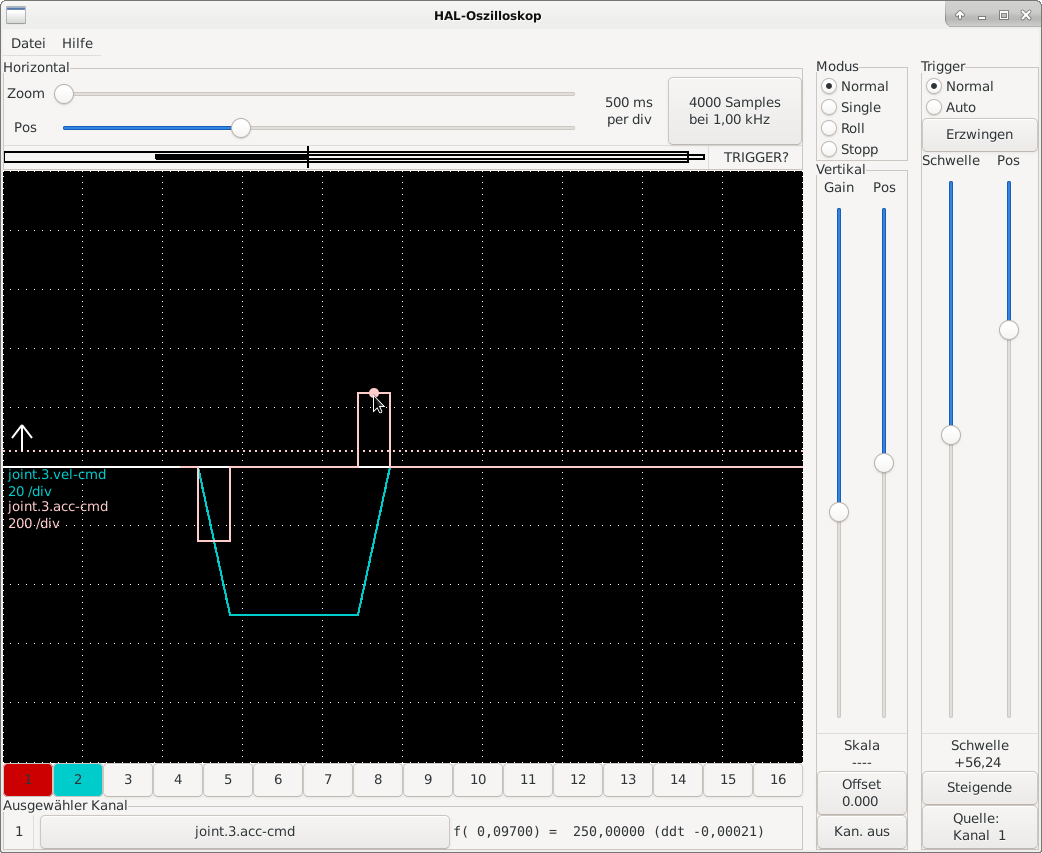

We've noticed this behaviour too. Try running some gcode and plot current-vel. it will be as expected
Then do it from MDI. I think the trapezoid will have a different slope. (different accel)
- roland

27 May 2021 10:58 #210435
by roland
Replied by roland on topic Deceleration distance too long
- roland
- Posts: 140
- Thank you received: 64

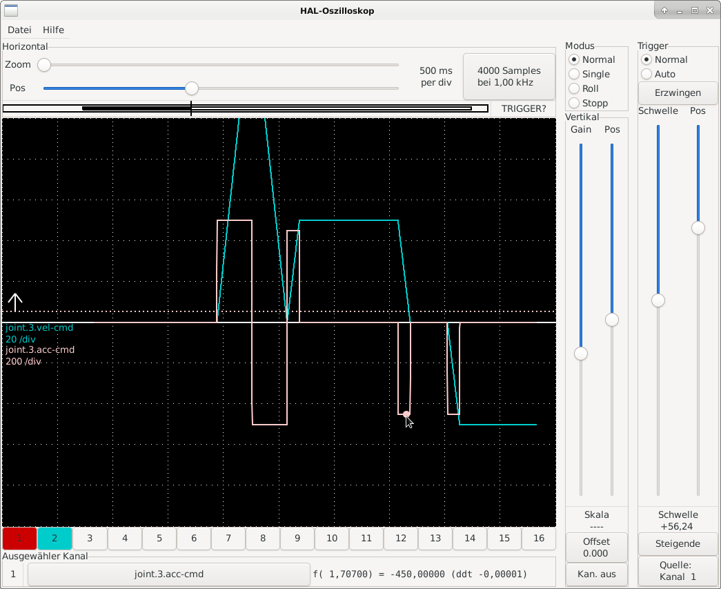

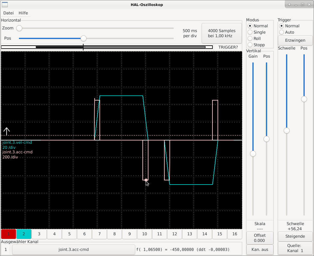

27 May 2021 18:10 - 27 May 2021 18:11 #210458
by roland
it makes a difference if G61 or G64 is active
In G61 mode:
MDI acceleration is 500 -> ok
program acceleration is 450
in G64 mode:
MDI acceleration is 250
programm acceleration is 250
In G61 mode:
in G64 mode:
Last edit: 27 May 2021 18:11 by roland.

I can really influence the acceleration at this point.
I don't understand why the acceleration has to be reduced. But I suppose, this reduction is not built in for no reason.
So I'll look for another workaround

I think that the half-max accelleration is required in the single-segment lookahead planner just in case the machine has to stop during the next (as-yet unseen) segment.
I note that the moves shown are joint 3. Which axis is that?
If it is one of X,Y, Z then I am a bit surprised, as those should not be using the paraboilic blend, but should be using the circular arc blend and the large lookahead planner.

joint 3 is Z axis
- Posts: 19896
- Thank you received: 4648
30 May 2021 17:39 #210705
Replied by andypugh on topic Deceleration distance too long
Then I am not sure why (or if) it is using parabolic blending.
Do you see the same with joint 0 ?
