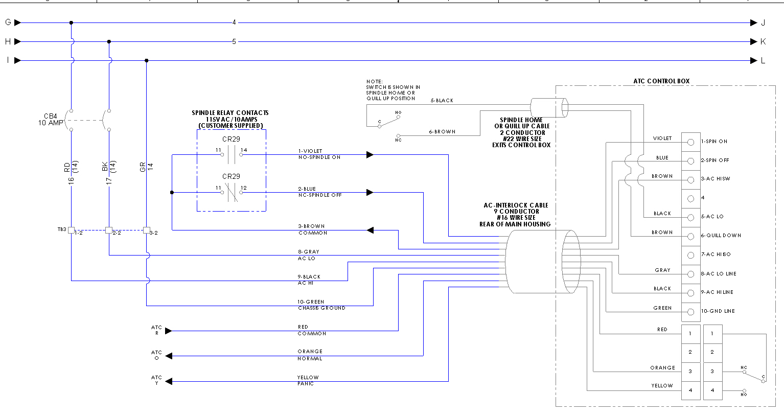

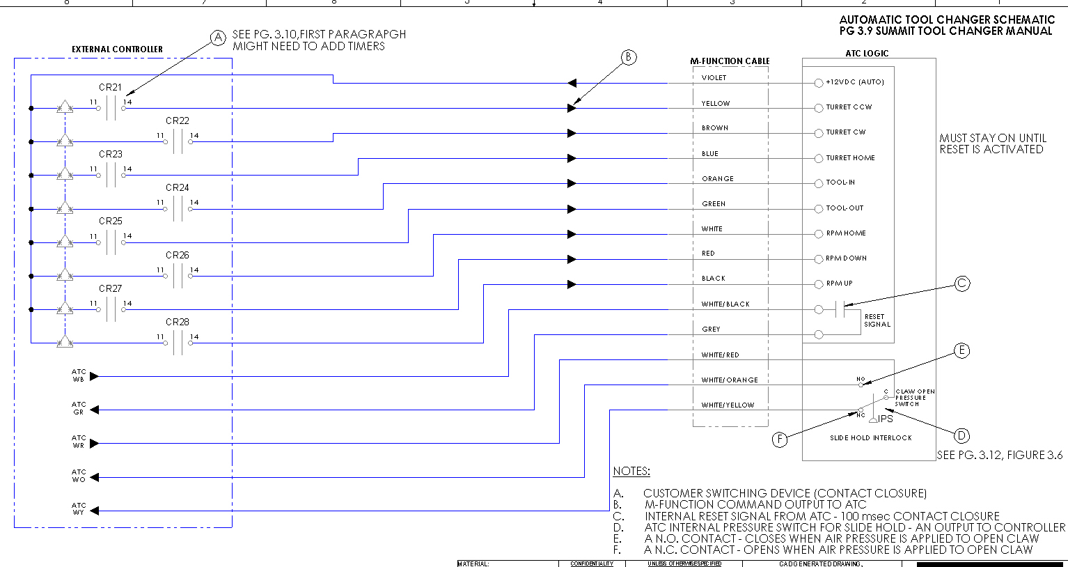

Hello everyone,
I am trying to get advice/ideas on how to get Linuxcnc to control the ATC on my Shizuoka AN-S (1979). I am aware of the following options in Linuxcnc: iocontol pins, carousel program, or remap M6 with custom program.
The problem I am facing is that I only have one feedback signal from the ATC. This feedback signal is just a reset sent back to the external controller (Linuxcnc). Maybe this is very simple and I'm just not seeing it. This is all very new to me.
Below I have included a brief explanation of how the ATC and its signals work. You don't have to read the explanation. I'm just including it for your convenience. I have also include two pdf files that give a more detailed explanation. Each is 3 pages long (6 pages total). There are 4 pages of reading with a diagram and a list of M codes.
I have also attached three pictures that show a part of my schematic that deals with the ATC.
Lastly, I am using the following hardware on my machine. Mesa 5i25, 7i77, and 7i84 (for extra I/O).

The following is a paragraph from pg. 3.7 of the operations manual "Summit_Toolchanger.pdf." It explains how a M20 - Tool-out command works.
Using Figure 3.4 (you can use "LDSHIZANS R02 PG 15 of 18.jpg" instead) lets simulate a tool-out function in the AUTO mode. The external controller must contain a switching device which will close when a command is given to the controller to perform tool-out. The switching device will then connect or tie the green wire with the violet wire. Voltage will be applied from the violet wire through the green wire of the M-function cable to the logic circuits of the tool changer. The switching device must remain closed so the voltage will continue to be applied through this wire until the tool-out function is complete. When the tool-out is complete, the tool changer returns a reset signal to the external controller by closing the white/black and gray wires for a duration of approximately 100 milli-seconds. When the external controller receives the reset signal, the controller must immediately "Open" the switching device that connected the green to the violet wire to accomplish the tool-out function.
I apologize in advance for the lengthy post. I'm just trying to provide as much detail so you guys can possibly provide the best course of action without wasting your time.

I think that you missed something from your list of options, and it might be the right thing to use: Classic-Ladder. It is a ladder-logic package built in to LinuxCNC (soft PLC). I believe that it excels at this sort of thing, but I admit that I have never used it.
Alteratively this sequencing could be done in G-code, if you are comfortable with G-code. basically set an output, wait for the reset, do the next thing. There is a sample G-code sequencer here:
github.com/LinuxCNC/linuxcnc/blob/master...hange/toolchange.ngc
That uses the carousel component, but that probably isn't necessary with your setup. You would just keep sending digital signals to trigger the next part of the process. (in effect the carousel functions are built in to the tool changer)

Hi Andy,
Thank you for your recommendations.
I tried the Classic-Ladder method, unfortunately it did not work out the way I wanted it to.
However, I have had more success with the G-code sequence method example you provided. It seems to be working the way I want it to so far.
Lastly, I do have another question. What is the purpose of the "[1]" after "endsub?" It this a parameter? Where is it going?
