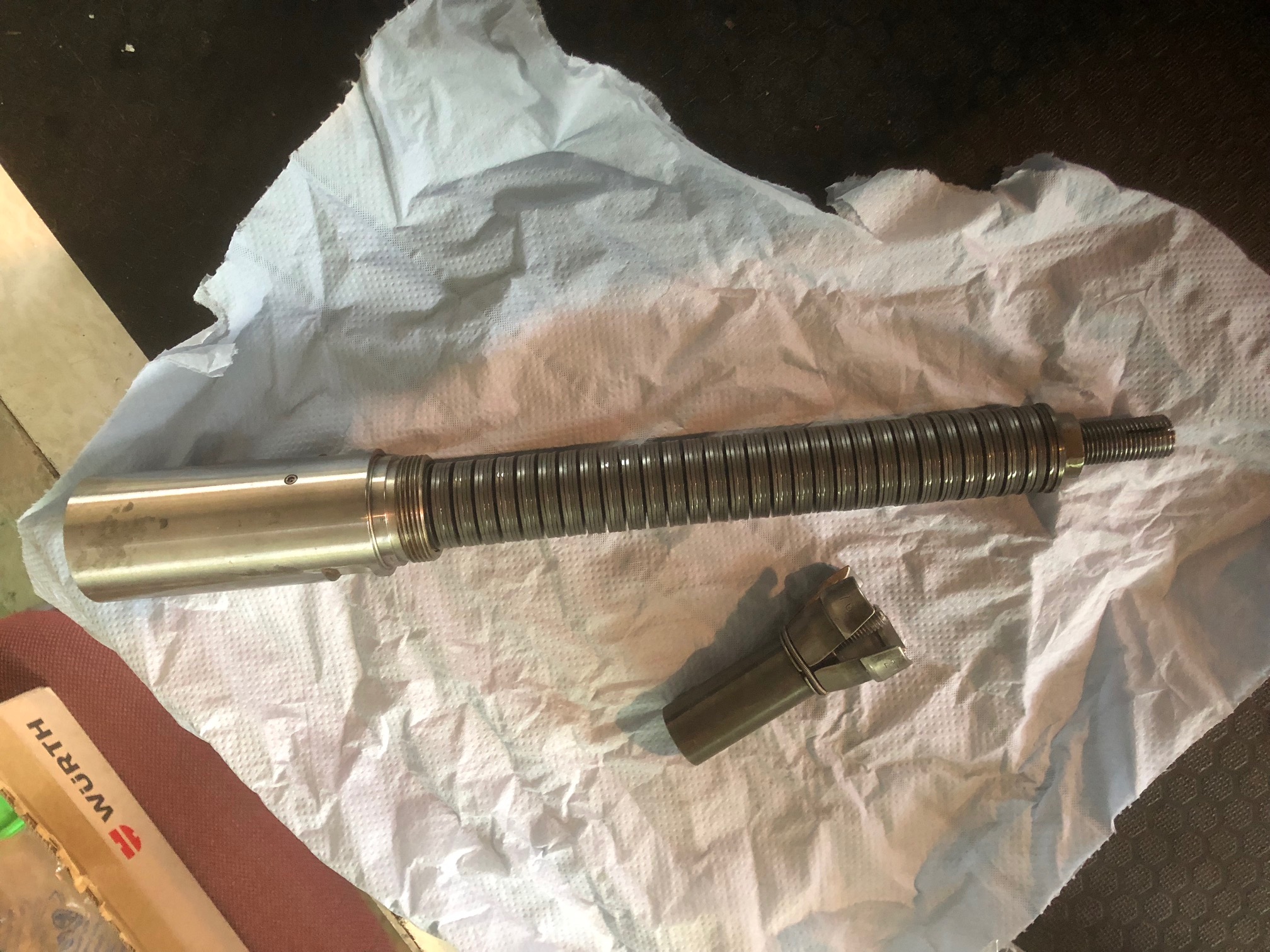

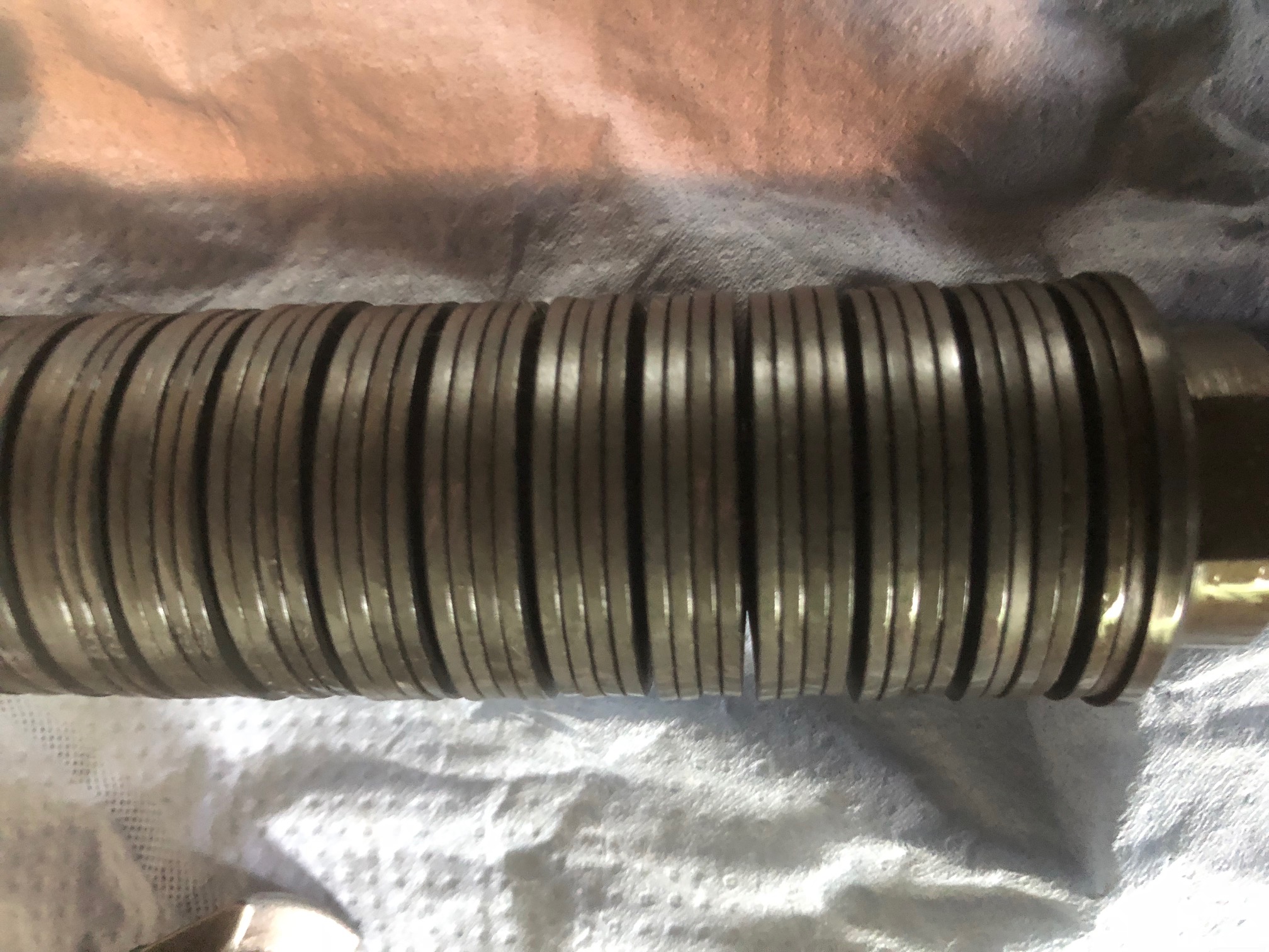

This is certainly a risk. It is possible that you might be able to rent the tool by the day.
But also be aware that the measurement will be with an assumed nominal tool, presumably with the correct pull stud. Variation in the holders themselves can have as much, or more, effect than the drawbar adjustment. I have one tool that does not pull up tight in mu (home-made) drawbar, and some others that seem to engage possibly _too_ early, ie there is no visible motion upwards as the collet retracts.
Replied by andypugh on topic Maho 700 C Horizontal spindle tool clamping problem
Further, you can purchase a gauge that measure the tension of the tool clamping. Without such a device it seems you could have a draw bar with insufficient tension and the tool could fret / chatter.

Hello Andy
Sorry, I had not checked this Forum for a while. Your photos are a great help.
I will try and locate and hire the device for checking drawbar tension on both the spindles. Do you happen to know the size and where I can procure the Belleville washers. I can see I am possibly going to have to dismantle and reassemble the spindle twice or have the machine out of action while I source the washers. Further, are the washers a standard or a Maho special non standard part.
Thank for your answer. Kind regards Chris McMullen NZ

the washers can you purchase at "ott Jakob" www.ott-jakob.de/en/contact/ .
They build your drawbar... Unfortunaly they have no office in Australia / New Zealand.
tension has to be ~12kn.
The springs are probably ISO standard disc springs.
If you are lucky you need one of these three sizes: industrialtooling.co.nz/collections/disc-springs
I got mine from www.springmasters.com/disc-springs/
For about 1/20 the price from the place in NZ above. I would suggest shopping around, but the data at Springmasters is probably helpful to work out what you need.

I have purchased them for this site
www.bellevillesprings.com/
They have been very helpful
Edit : it looks like its the same company
