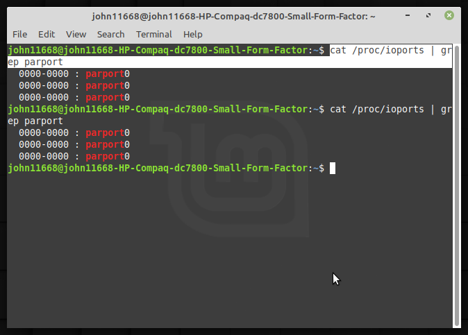

Right ! so next problem ( there is always another )
Have tried to follow this guys advice even though he does not seem to be brimming with confidence
So I go to the lspci -vv command and open a get something not a lot different to him but no clear parallel port in the screed
have tried adding a couple options into my hal file saved , then opened gmocappy
In one case come up with a screen which barrs the reset button so went back to original
In second case it comes up with parallel port not found at 1012
File is attached:-
Can anyone see from this what I need to add to my hal in order for my second parallel port to be seen by EMC
File is attached:-

Who, or what is Sudo ??
- Posts: 21750
- Thank you received: 7433
06 Jun 2021 20:56 #211352
Replied by tommylight on topic Installing second parallel port
sudo cat /proc/ioports | grep parport
The following user(s) said Thank You: john11668

06 Jun 2021 21:26 #211356
by john11668
Replied by john11668 on topic Installing second parallel port
Will try this shortly and report.
