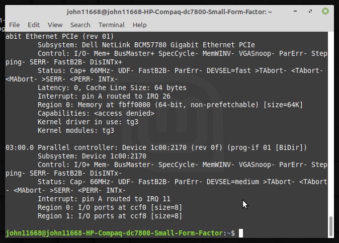

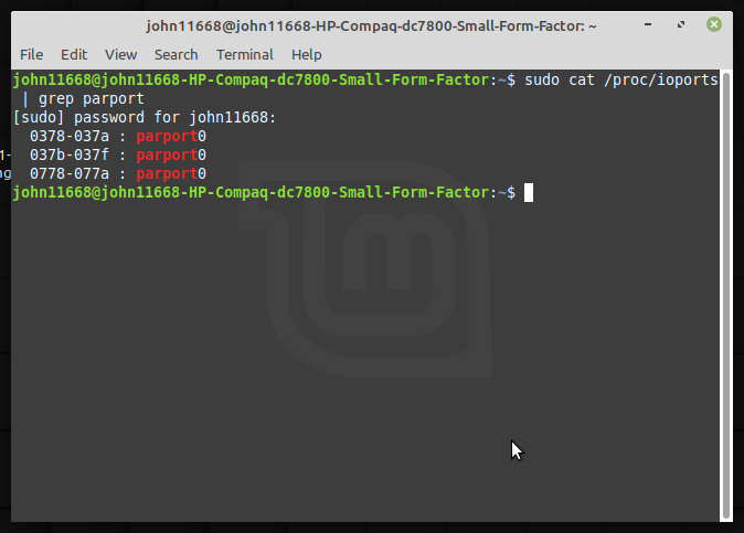

So did try my PCI card in the next slot
lspci now seems to see a parallel device
Sudo cat etc
So doesnt look like this has taken me forward at all
Unless you guys see any different.
Have tried a couple of local workshops for PCI/par cards but no joy there
Gonna contact a local outfit who do one armed bandits and games machines but no luck getting hold of them yet.
Have explored the joystick controller card route and there do seem to be a lot of options . Suggestions for a good (proven one would help.

Am going to try a different PPcard . hope it performs better .

10 Jun 2021 09:41 - 10 Jun 2021 09:42 #211681
by john11668
Replied by john11668 on topic Installing second parallel port
I did.
0xccf0 in 0xccf8 out
gmocappy told me parallel port not found

10 Jun 2021 12:17 #211690
Replied by tommylight on topic Installing second parallel port
Not both addresses, only one of them is used.I did.
