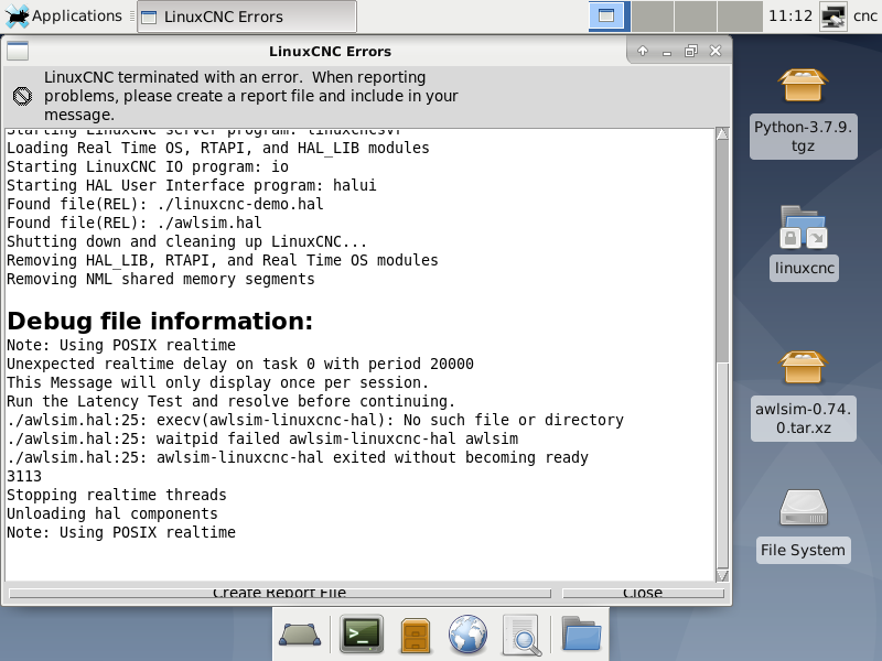

I am having a little bit of trouble configuring this setup. I cannot figure it out at all.
When I go to setup a machine, there's no option to import the HAL file that comes with the package from: github.com/mbuesch/awlsim
I have no idea where to start with this configuration.

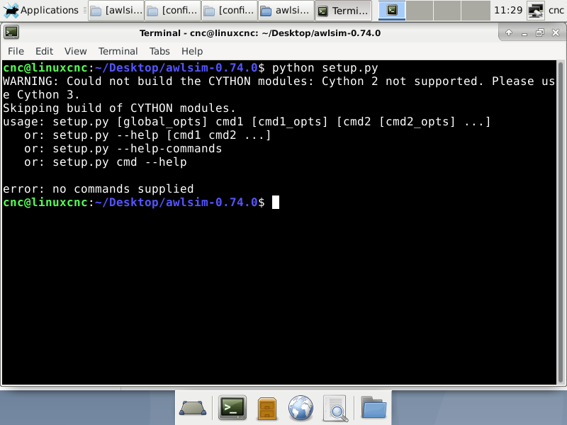

I have successfully installed AWLSIM on linuxcnc 2.8.0 buster. This required a couple of things added to the OS, I had to update python to one of the latest versions, install that, make some config changes, etc.
I have no idea where to go from here to get it so that there's a machine config able to use AWLSIM to communicate with a machine that uses rs485.
I am fairly certain that the machine uses PLC as it has an AWL file in about exactly the same format as the sample awl file from the awlsim package.
The slight differences can probably be attributed to the fact that this EMCO machine is from the late 1990's.
Any help would be greately apprciated, and I'll be sure to document everything for future lurkers

Go into your ini file. Under [HAL] add halfile = awlsim.hal (or whatever the name of the file is.

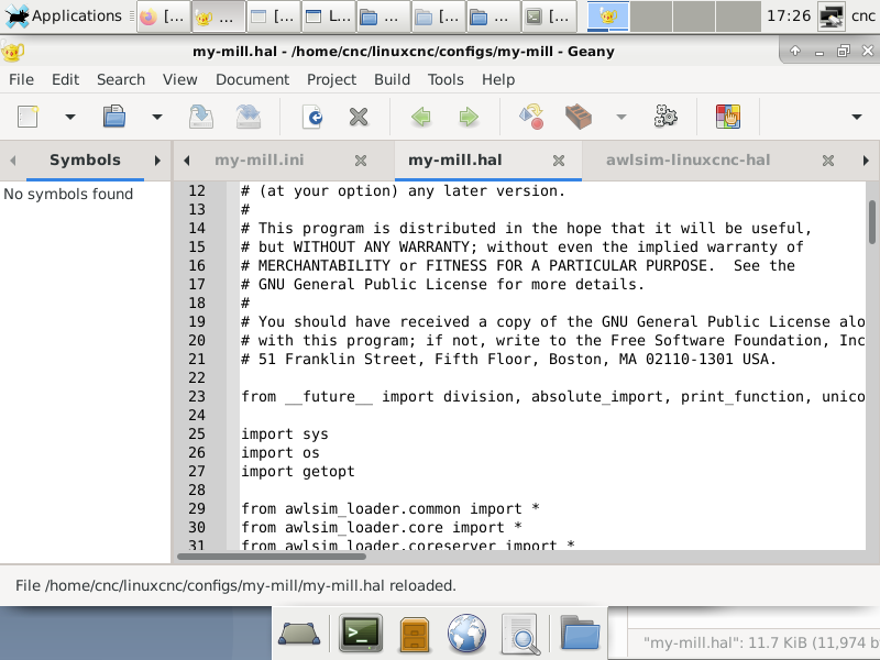

Does not seem to be a hal file, more like python .

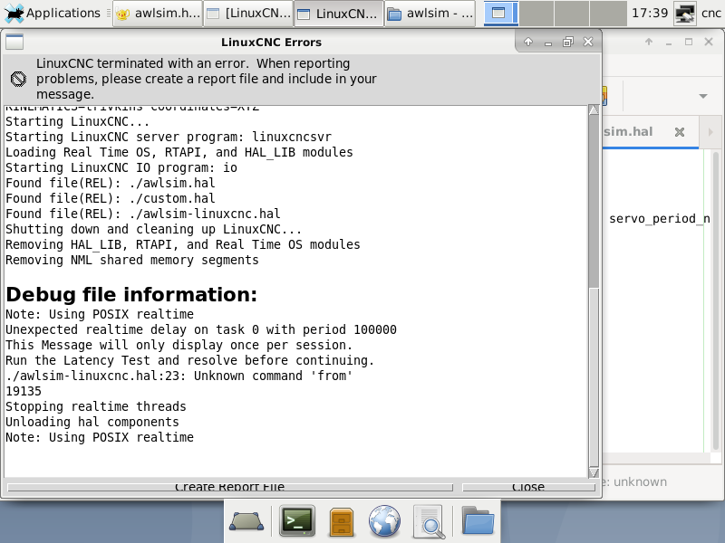

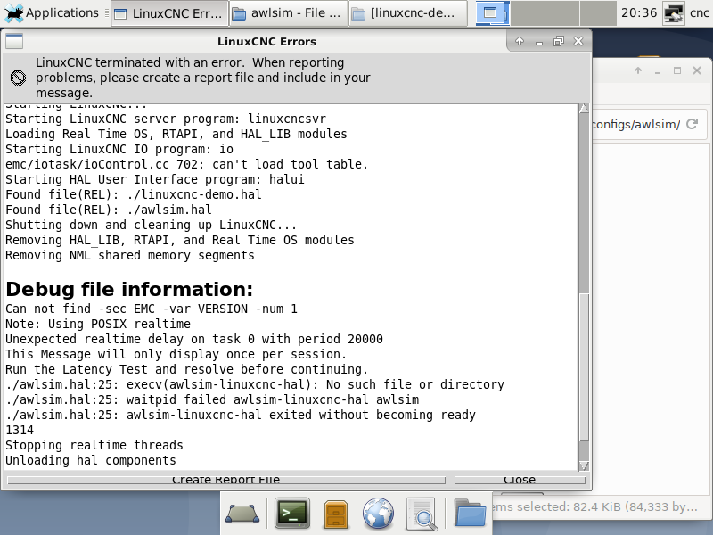

Ok I was able to get the previous issue sorted out. Here's the issue I get now:
As far as the GITHUB it is confusing, but if you search through it you will find the following folder for linuxcnc:
github.com/mbuesch/awlsim/tree/master/awlsimhw_linuxcnc
There's a further example setup here:
github.com/mbuesch/awlsim/tree/master/examples/linuxcnc-demo
When I load every example file to a config folder, I get the error listed in the photo above.
The specific files for linuxcnc that I am currently trying to use are exactly as posted in the examples section. I think if I can get the example to work past the posted issue in the picture, I can modify my files to make them work.

It may help to post your complete configuration directory as a compressed file.

The hal file tries to set up a userspace component but cannot find the correct file.
This is the command:
loadusr -Wn awlsim awlsim-linuxcnc-hal --listen localhost:4151 linuxcnc-demo.awlpro
