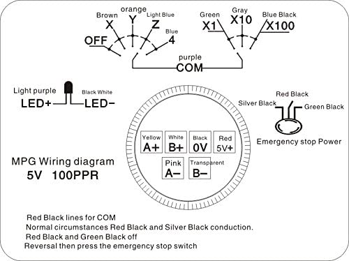

Hey all,
I am fairly new to Linuxcnc and I need help installing a MPG pendant. I copied and pasted a pendant hal file from the internet file to my custom hal file and I am getting an error when trying to start Linuxcnc. I have tried to attach the error log as well as my hal and ini files. I could not get the error report to attached so I pasted it below. I also attached the pendant i am tring to install. Any help woill be appreciated.
Steve.........

./Pendant.hal:22: addf requires at least 2 arguments, 1 given
2152
