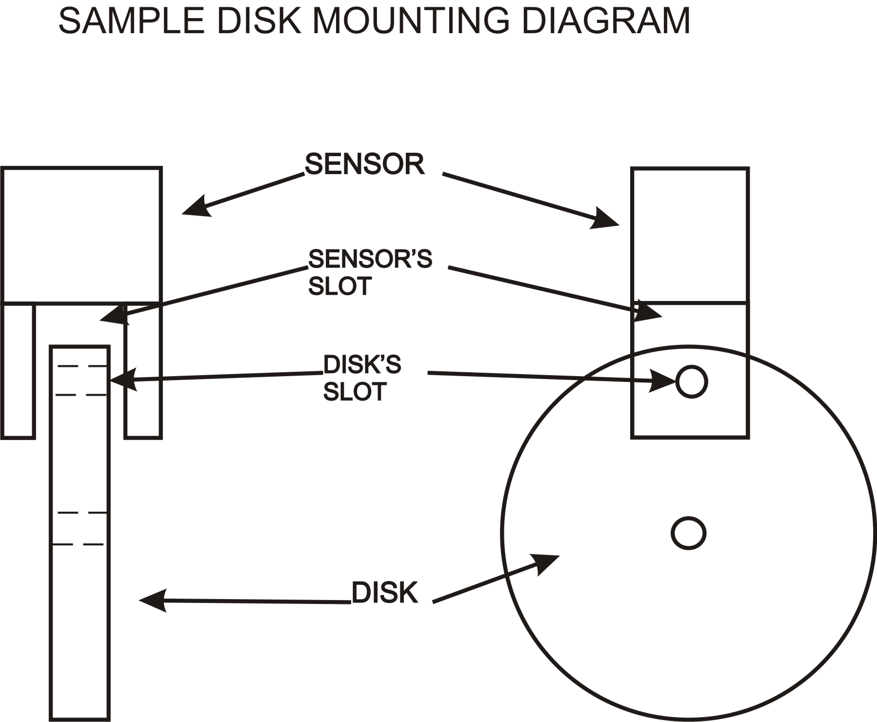

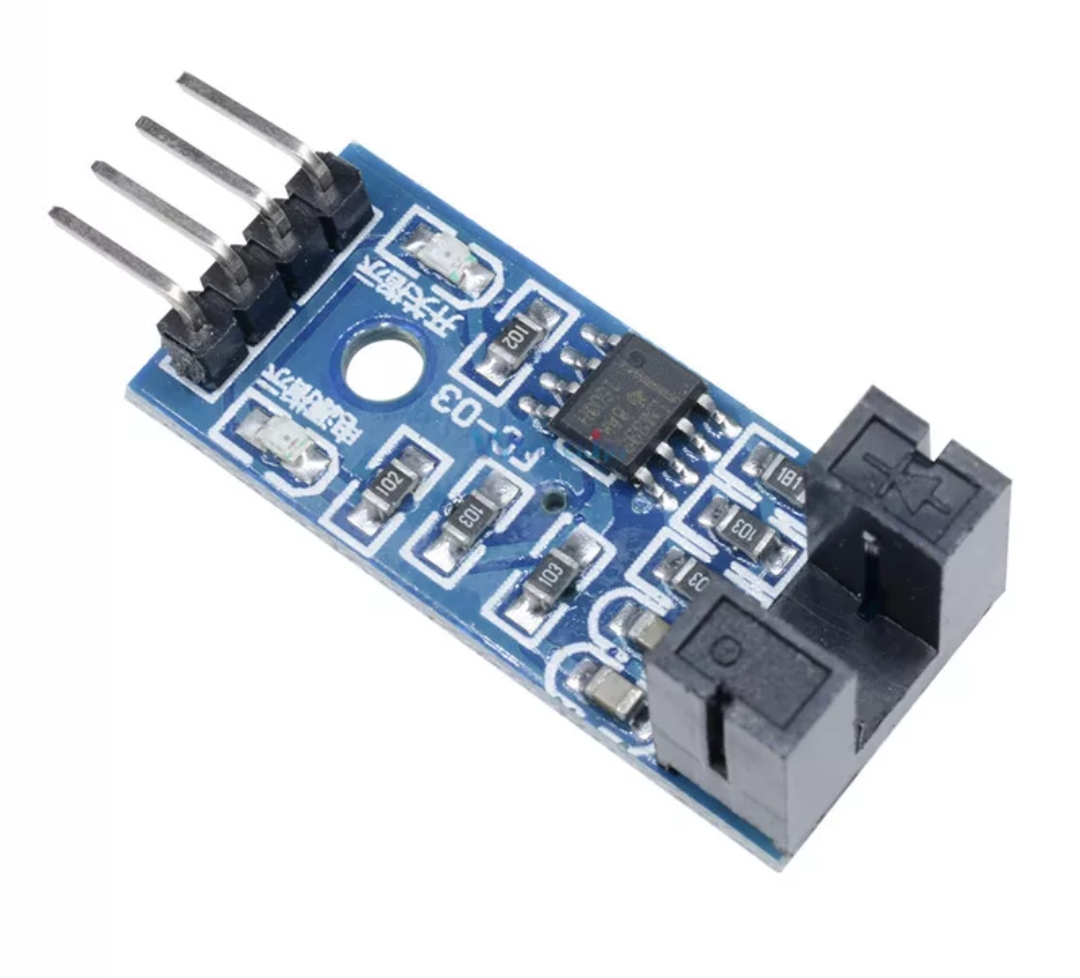

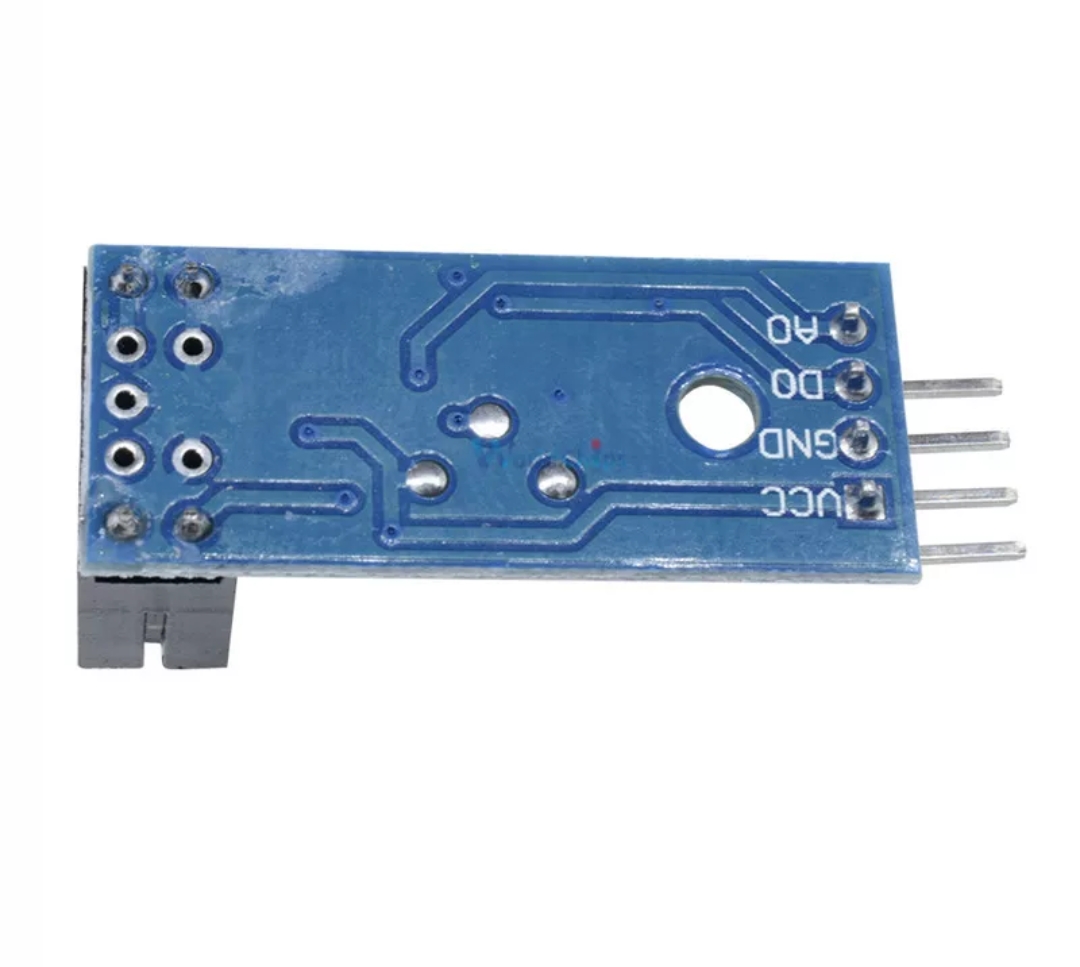

21 Jun 2021 07:34 #212540
by rohit269
Replied by rohit269 on topic Lathe spindle feedback
- Posts: 19896
- Thank you received: 4648
21 Jun 2021 23:43 #212616
Replied by andypugh on topic Lathe spindle feedback
The connection of the single pulse to both A and Z encoder phases is purely a HAL connection, ie in the software. A single sensor channel and a single IO pin is all that is needed.
(I really must get round to adding missing-tooth index to the encoder component)
