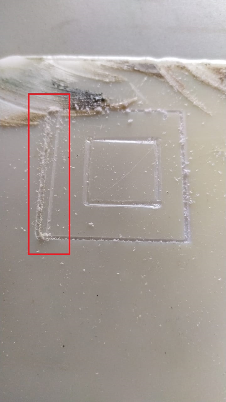

I created a G code for her to machine a 2mm plastic square ('plastic'
photo file), to test the machine and set it up to go removing 0.5mm of
material at each step and in the third step, she lost step machining
in stitch incorrect and maintained this positioning until the end, is
highlighted in red in the photo.

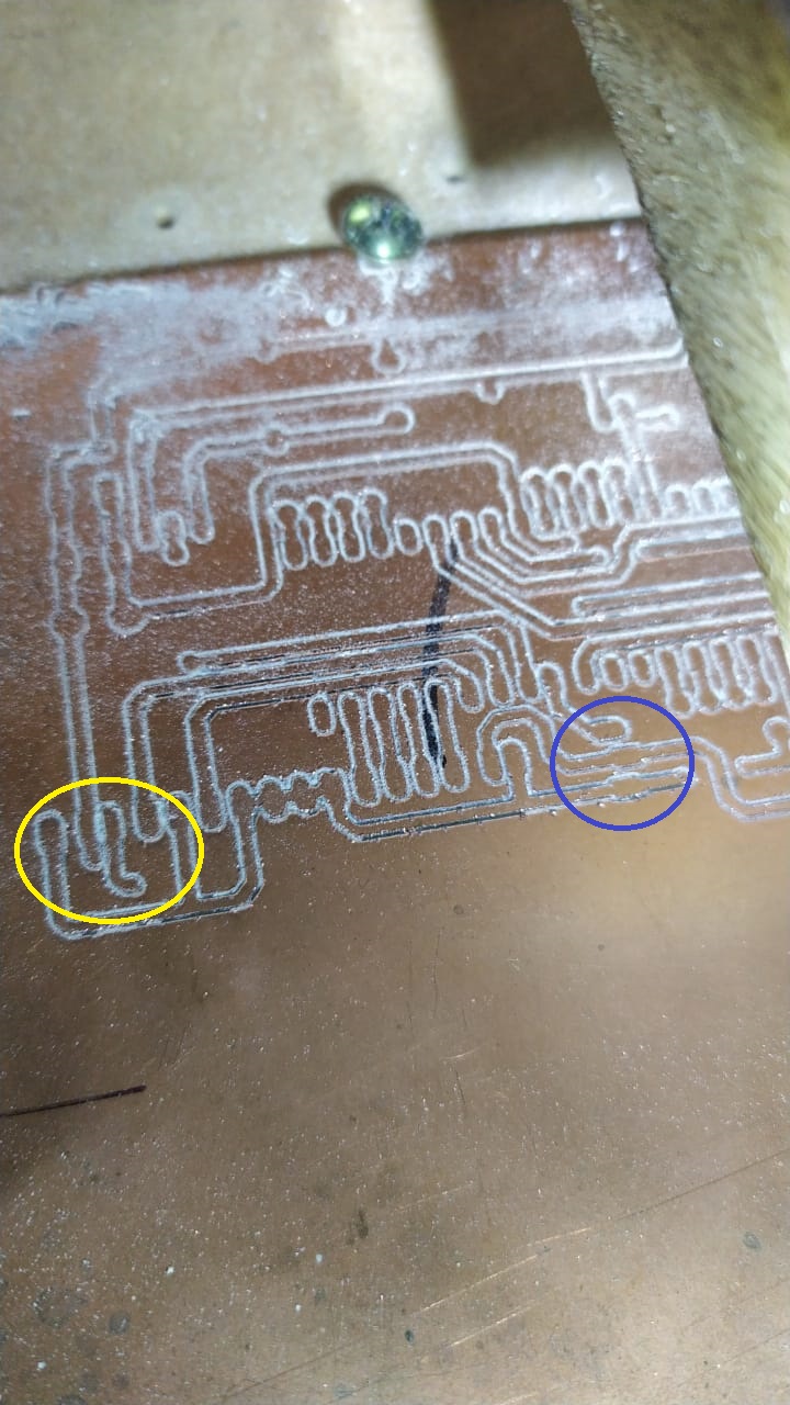

I generated the code to machine a pcb through Eagle 7.4 and
PCB2Gcode, when I tried to machine the board it also lost positioning,
overlapping the tracks as highlighted in yellow and blue in the photo,
which was where the problem was more visible.

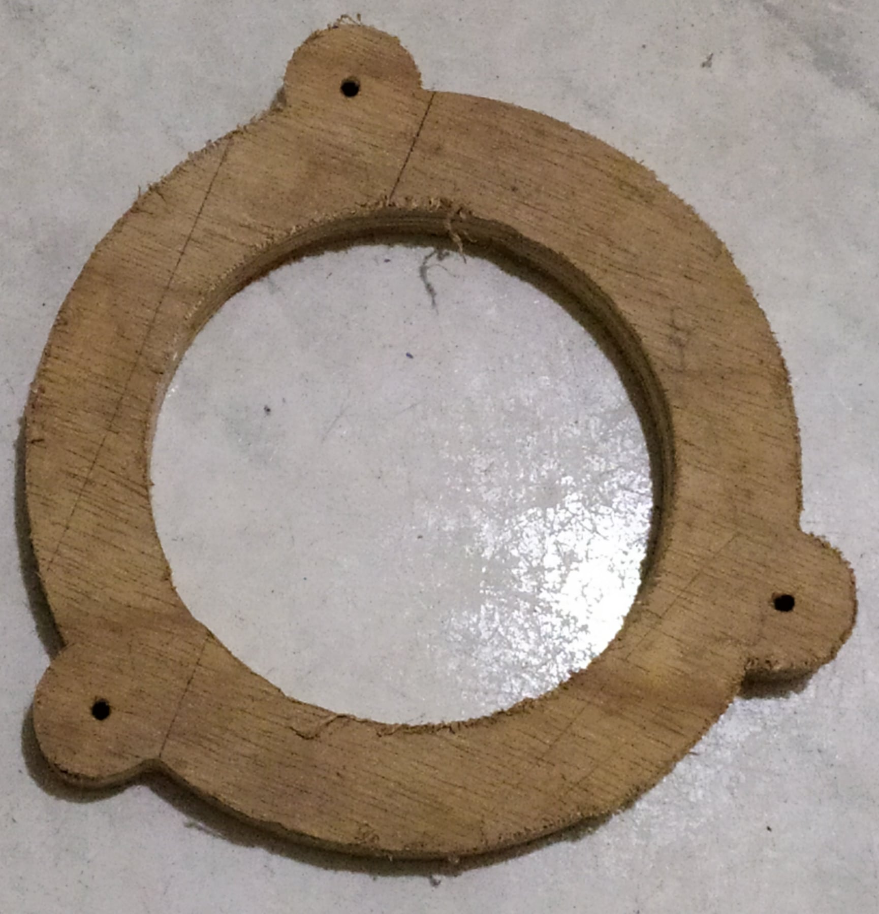

Some time ago I machined a wooden frame (naval plywood) to put a
speaker, the machine machined without problem and it can be seen in
the "wood" photo. I used Autocad to draw the part and then Artcam to
create the Gcode.

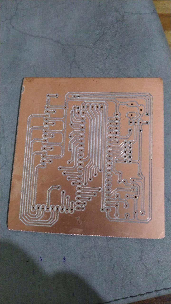

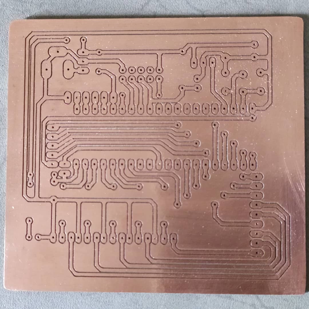

I also machined some pcbs and had no problem, it's
in the picture "pcb ok", which incidentally, I'm trying to machine
another identical board using the same gcode file and now it's giving
the problem I'm reporting.

It is possible that a coupling is slipping under load. Make a reference mark on the coupling and shaft to check this.
The error in the plastic part looks to me more than a single step, but it is possible that the motor stalled for a moment. It looks like it might have stalled at a point where both motor were turning, is the power supply adequate to run both motors at full current (This should not actually be necessary, there is some wiggle room as generally you don't run all the motors at full current at the same time)

From what it seems to me, the error only occurs when a single axis is moving, in the pcb on diagonal tracks, there was no problem.

I didn't quite understand the reason for the red message. I ran the manual test, leaving several programs open with about 7 glxgears windows and latency did not exceed 33us.
This control board I use is a chopper with L297 and 74LS09 connected to the PC's parallel port.
News:
I made some changes, changed the L297 default values in the time setting:
Step time L297 500ns > Step time 2000ns
Step space L297 4000ns > Step time 4500ns
Direction hold L297 4000ns > Direction hold 4500ns
Direction setup L297 1000ns > Direction setup 2000ns
And I ran this code 3 times in a row, making the machine go to zero point just before starting to run the first time, at the end of the third time it ran, it returned to zero point correctly without losing position at any time.
As it is now late here to do more tests, tomorrow I will try to machine another pcb and see what happens.

Looks like it got better, I made the board just now, the tracks were ok, I just think I set the forward speed too high and ended up breaking a little piece of the tip of the V bit.
