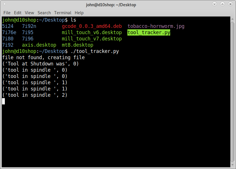

Hi All,
I'm trying to get this python script to work so that I can keep track of the tool in the spindle and if Linuxcnc closes for whatever reason the information is retained.
My issue is despite commanding the offset using:
cmd.tool_offset(old_tool,
s.tool_table[old_tool].zoffset,
s.tool_table[old_tool].xoffset,
s.tool_table[old_tool].diameter,
s.tool_table[old_tool].frontangle,
s.tool_table[old_tool].backangle,
s.tool_table[old_tool].orientation)
Linuxcnc is reporting s.tool_in_spindle = 0, despite at the bottom edge of the screen in axis it shows the correct tool, offset, and diameter. and I need something like an M61 Qxx for the tool_in_spindle to show a value. What is also weird is if I do an ATC change my GCode based changer is able to find the correct tool using #<_current_tool>.
Thanks in advance.
(Linux CNC 2.8.1)

Close Linuxcnc, with a tool loaded.
When you re-open Linuxcnc you will see it will set the tool in axis. Then once it enters the loop it will write tool 0 to the file because despite axis showing a tool loaded offsets and all. The tool in spindle value is 0.
That or open and close linuxcnc 3 times in a row. The third opening tool will always be 0.

Thanks for your feedback Chris, in this case the status.tool_in_spindle is returning 0 even though linuxcnc accepted the command to update the tool info.
I’d just MDI up a M61 but it can’t issue MDI commands until the user homes the machine.

Unfortunately, I don't think that would work with the mesa 7i40 drivers, as the encoder counts are cleared from the FPGA at startup. Plus there is no way to be 100% sure the machine didn't move while being powered down. It's not a big piece of iron so someone could definitely bump the table .010"-.020". I'm trying to hold .001" +/- between homes.
Does anyone know if this is a bug or is my implementation wrong? I guess I could wait for the machine to be homed and then issue a G61 to finish the job. Then update the text file. Seems a little wonky...
