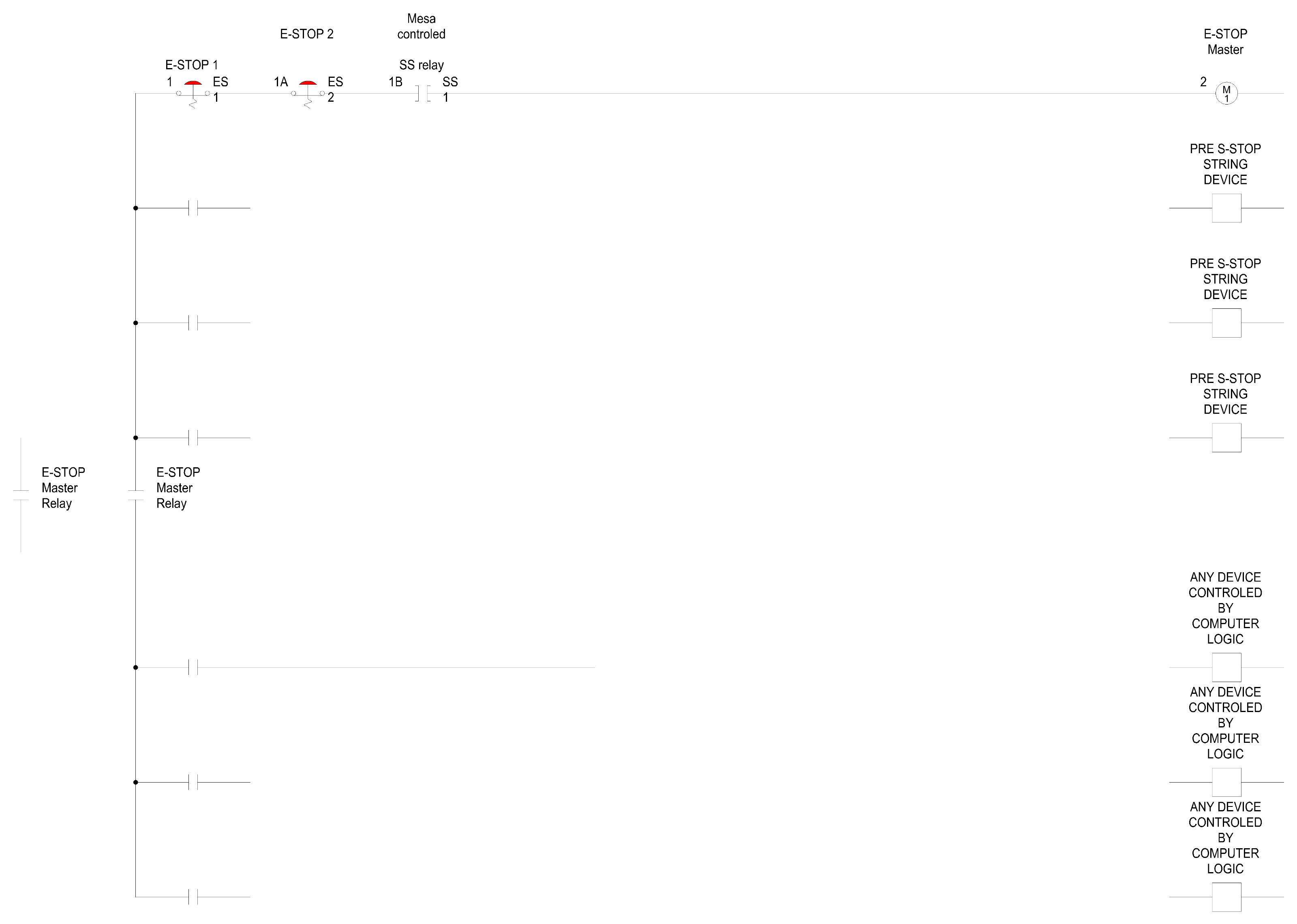

Replied by rodw on topic Emergency STOP on mesa card 7i76e
looks right. AS my MAchine grew, I did not run the mains power to subsequent estops and used an estop-latch chain. THe motor disable relay still disbales motion if its pressed.(one is on a wireless pendant.)

Replied by scotth on topic Emergency STOP on mesa card 7i76e
I use the E-stop output from the mesa board to drive a solid state relay in the E-stop string.
Then I use the enable output to enable drives.
Your drawing should work.
Scott
Scott

16 Nov 2022 15:02 #256863
by scotth
Entertaining the Boss last night. I will need to move to the Windows system to see if I can draw up an example.
- scotth
- Posts: 242
- Thank you received: 61

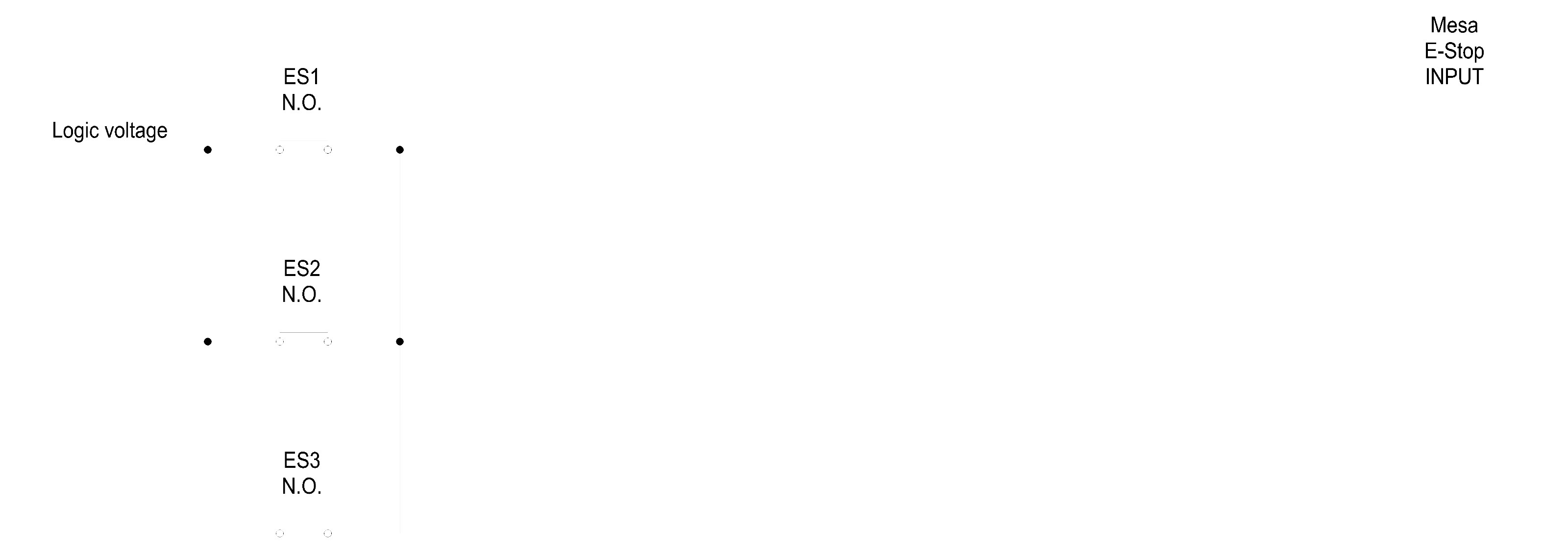

16 Nov 2022 17:19 #256873
by scotth
Well, not as fast or neat as it should be. I added ES3 as an example, you could add 100 switches if needed. N.O. switches form an or gate. N.C. switches form an and gate. Master E-STOP relay controls all power you need switched off to protect your LIFE!!!
