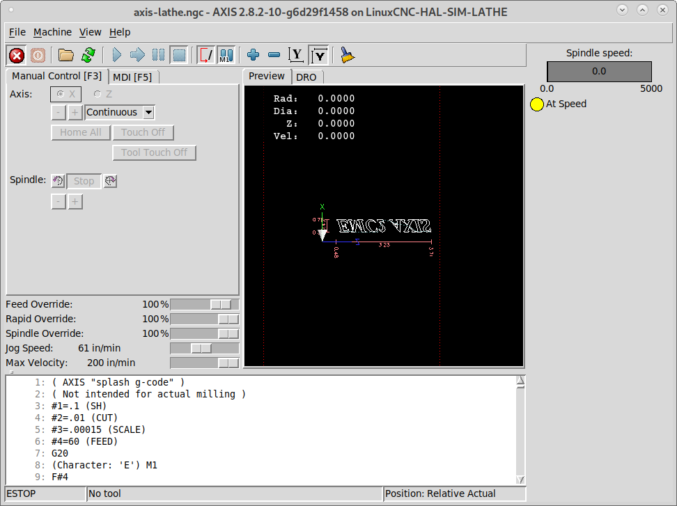

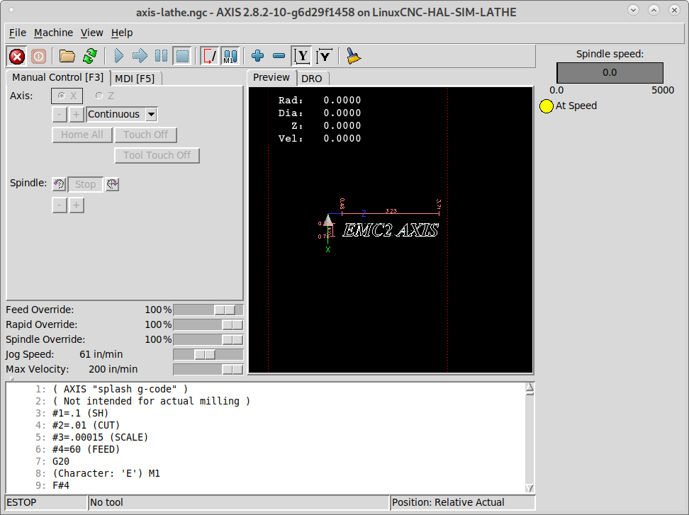

31 Jul 2021 11:49 #216446
by BigJohnT
Replied by BigJohnT on topic Back tool lathe
Front Tool Lathe ini
JT

- BigJohnT
- Posts: 3990
- Thank you received: 994
31 Jul 2021 11:50 #216447
by BigJohnT
Back Tool Lathe ini
Are you not seeing this?
JT
[DISPLAY]
DISPLAY = axis
PYVCP = lathe.xml
LATHE = 1
BACK_TOOL_LATHE = 1 #uncomment for back tool lathe

- Henk
- Posts: 408
- Thank you received: 92
31 Jul 2021 13:01 #216450
by Henk
Replied by Henk on topic Back tool lathe
Hi. It doesn't work in 2.7.15. that may be the issue. I'll update to 2.8 and report back
- Posts: 7361
- Thank you received: 2173
31 Jul 2021 17:13 #216468
Replied by cmorley on topic Back tool lathe
Don't overwrite your original system 2.8 is very different from 2.7. You may want to go back until you iron out the details.
The following user(s) said Thank You: Henk
