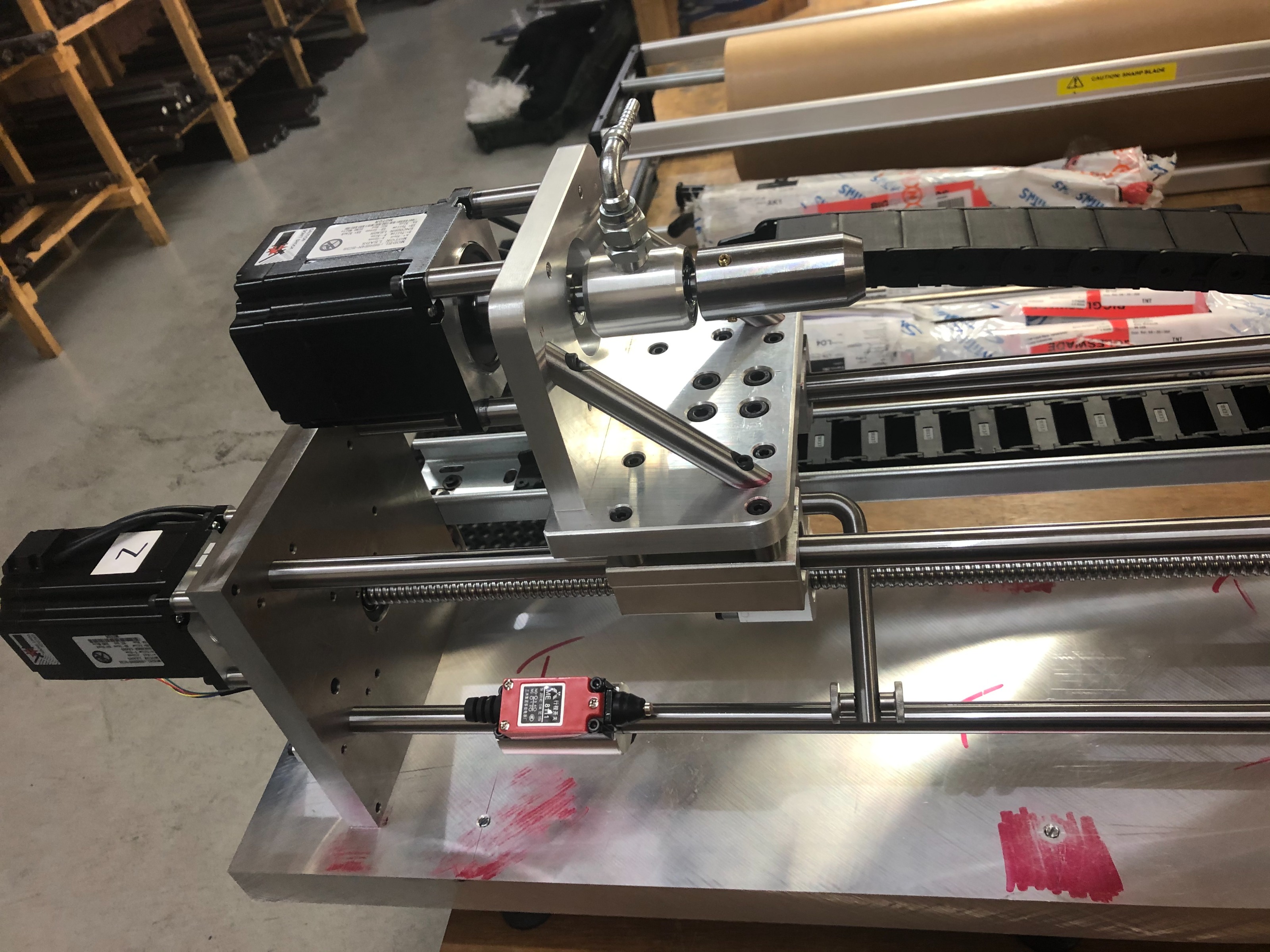

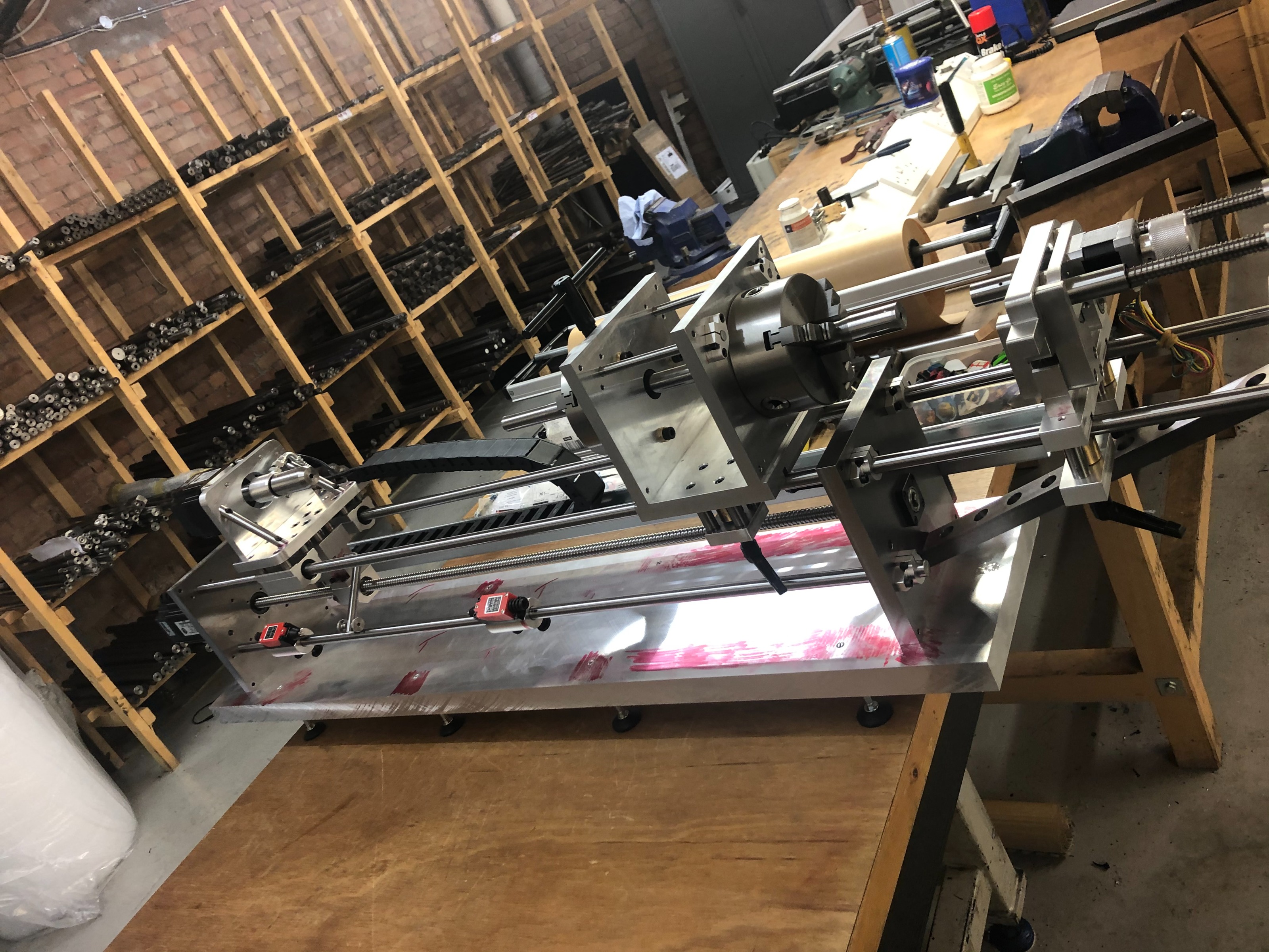

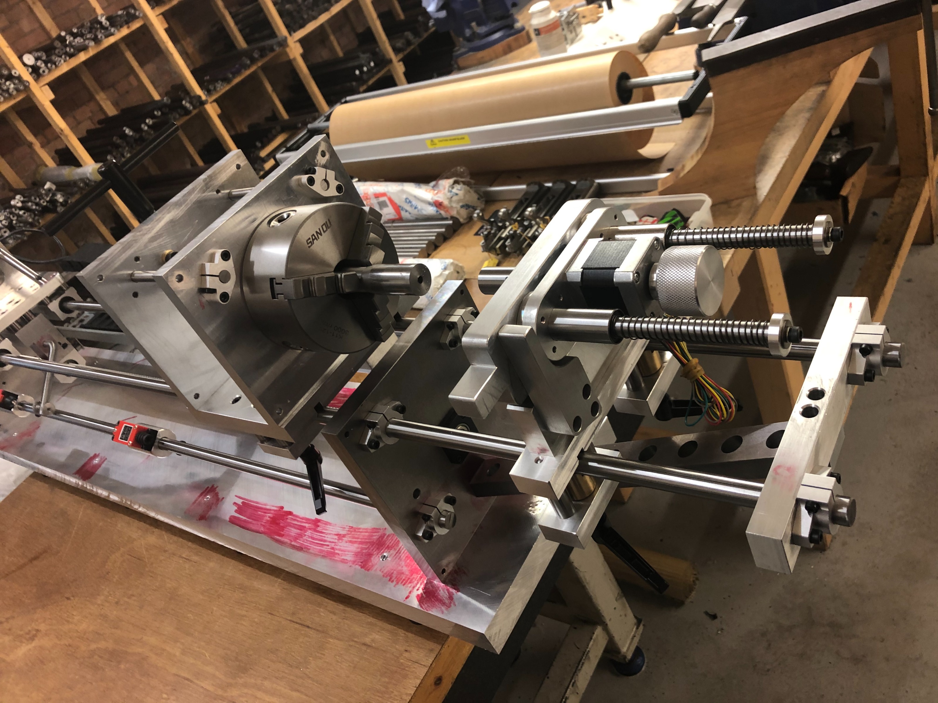

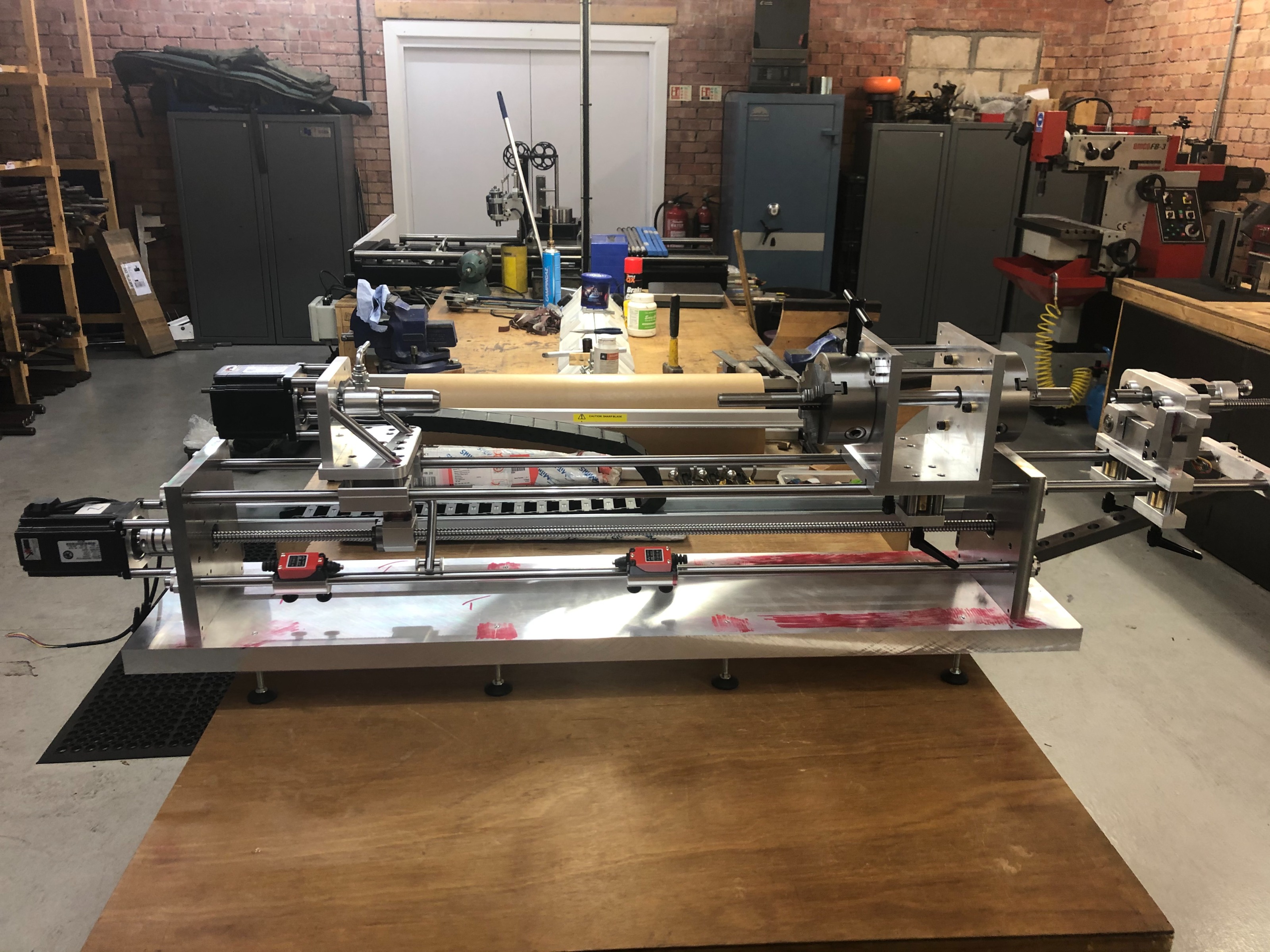

11 Aug 2021 09:49 #217551 by SPC89
Replied by SPC89 on topic Cut Rifling Machine Help
Few Pictures of the machine being built

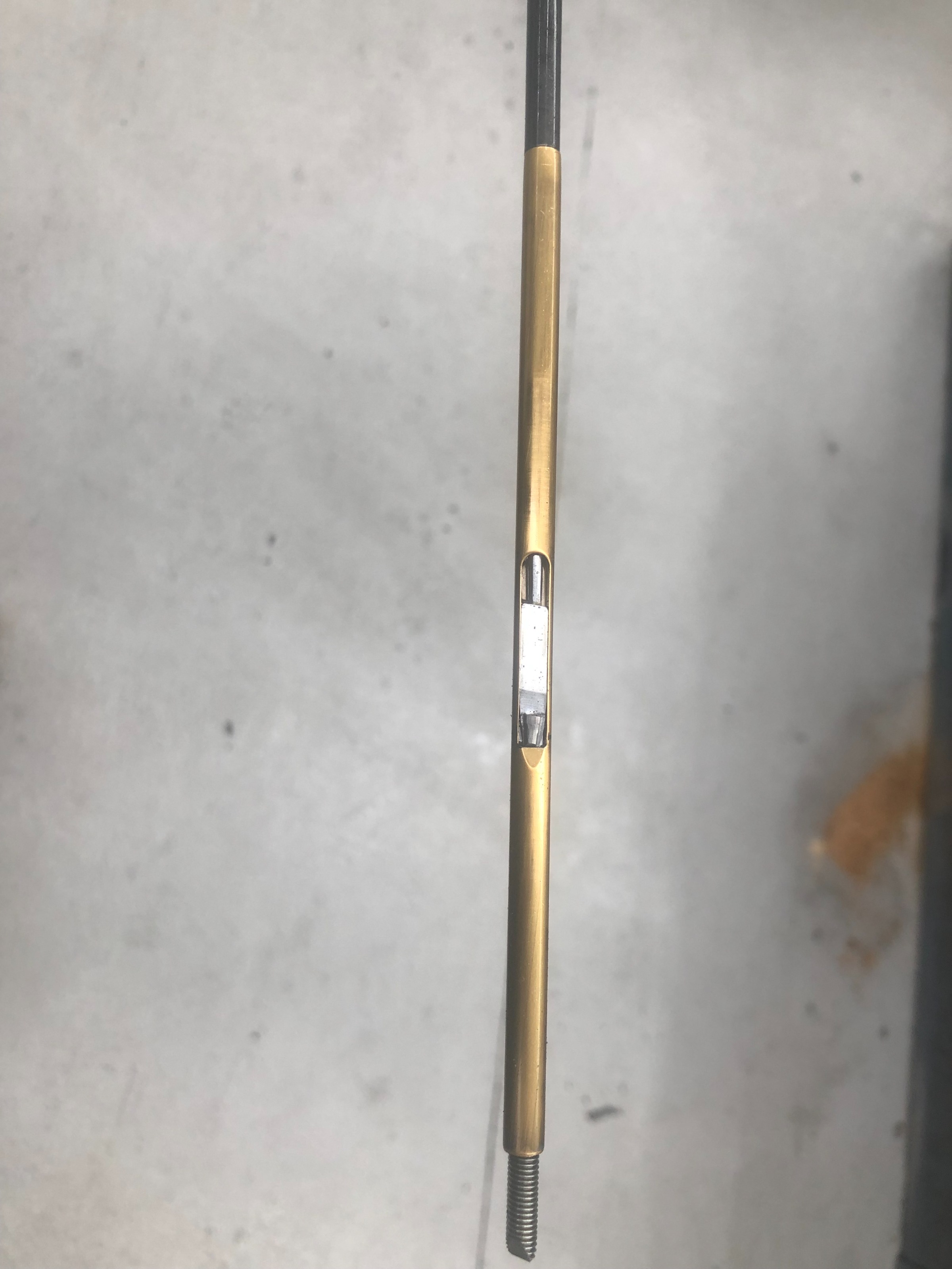

Yes it is a cutting process. The tool is removing about 0.0001 every pass it makes. Once it has done a cycle of grooves say 4 it then gets raised by a mechanism that rotates a screw in the tool that pushes on a wedge that raises the cutter up.
A rifling button doesn't cut it swages the metal to the right shape. Puts alot of stress in the metal so we heat treat it afterwards.
below is a cut rifling tool we use on our machines. A piece of carbide is used to do the cutting work and ground up with correct angles for any given twist as such.
