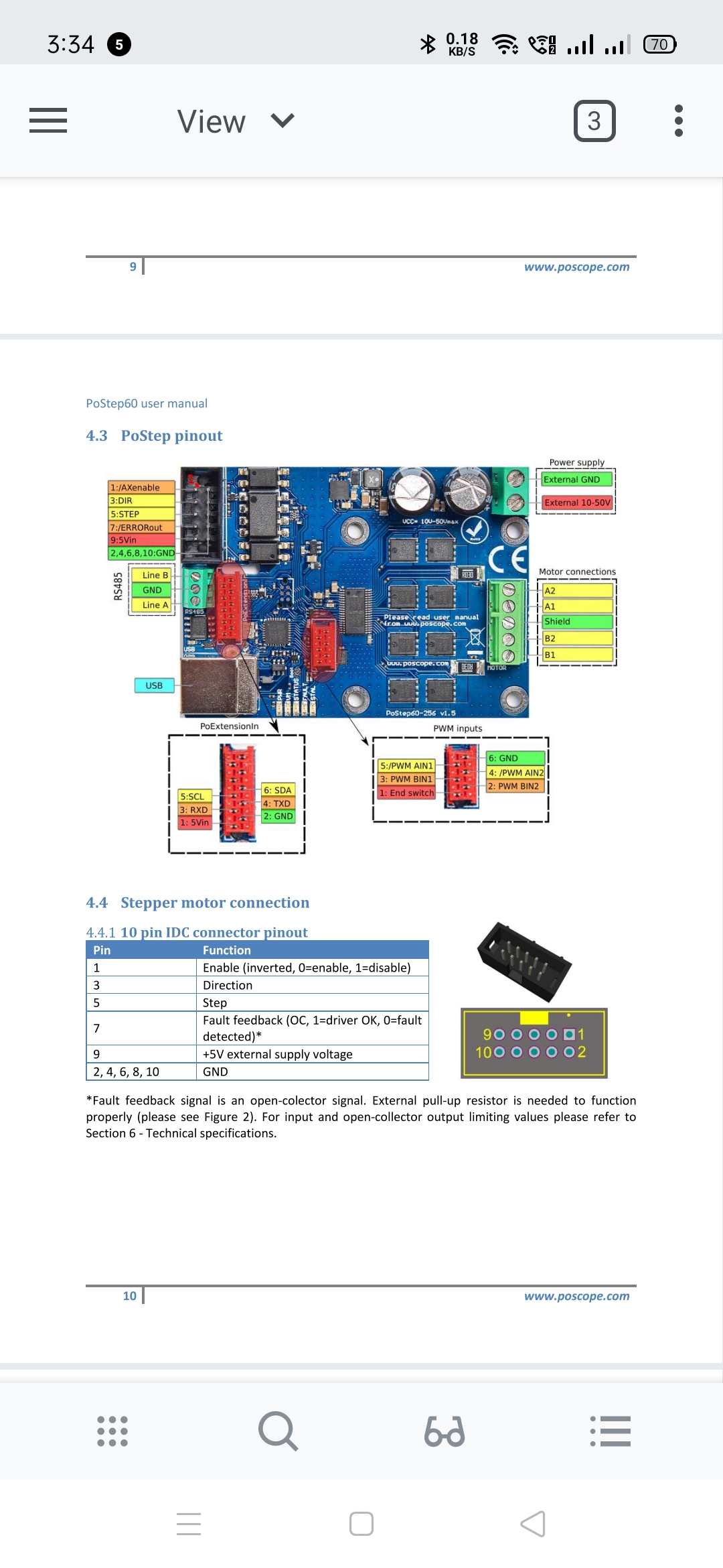

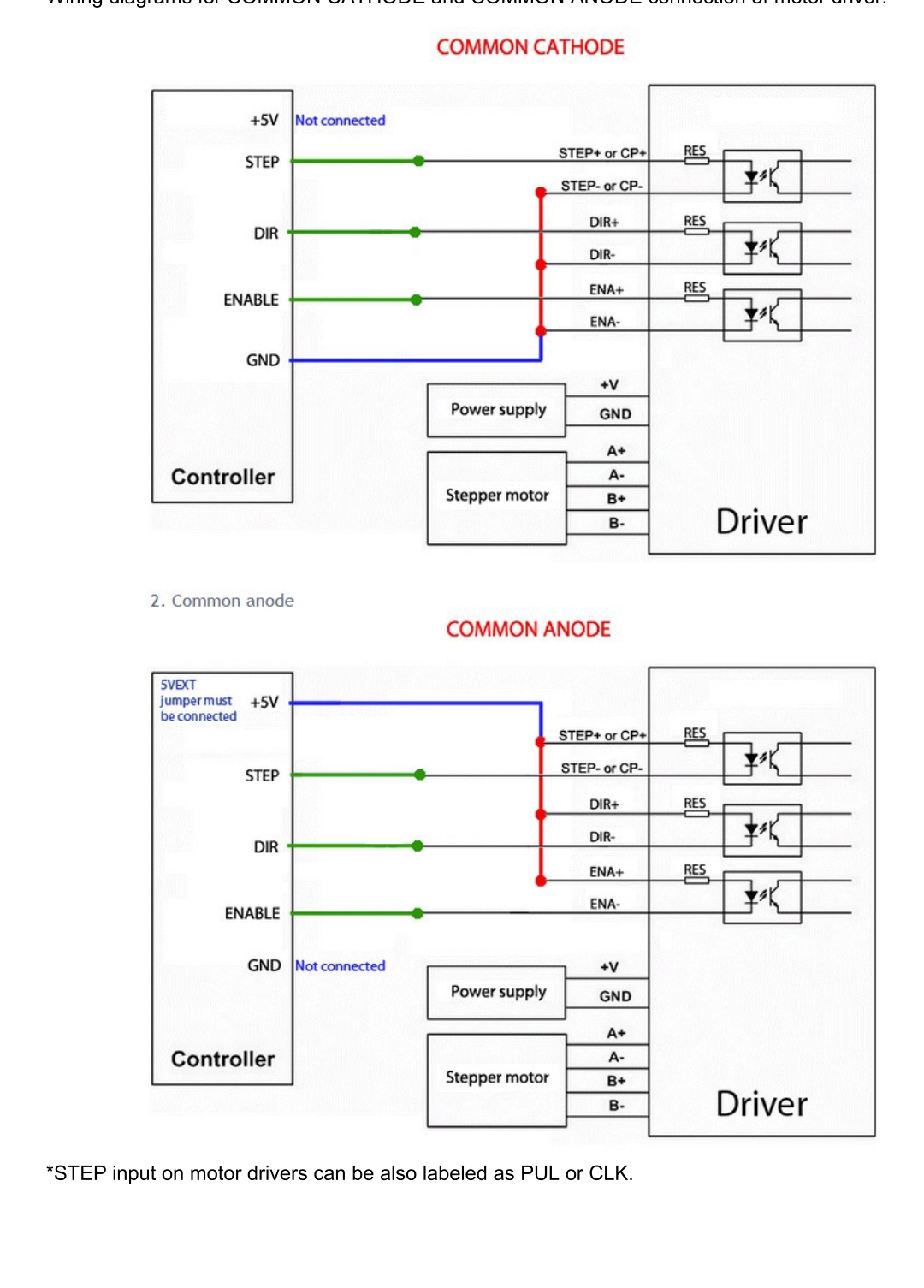

Sir,
Please see attached file and tell me how to connect this stepper driver in 7i96.
Thanks and regards,
Rohit Gupta
Thanks and regards,
Rohit Gupta

3 & 5 Step & Direction from MESA.
from MESA you have STEP + & -, Dir + & -.

Sir
Many thanks for the quick reply, but our stepper driver (postep60-256) required digital enable signal (not normal 5V) for activating this driver so please tell how provide digital enable signal from 7i96 to activate this driver.

How is this digital signal different from a 5V logic signal?

The enable is shown as a 5V signal
I would probably wire all drives enable+
to one of the 7I96's SSR - outputs (in parallel)
and connect the corresponding 7i96 SSR + output
to +5V (and all drives enable- to ground)
