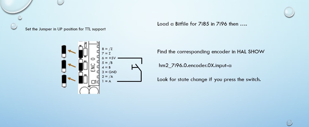

7i85s+7i96 was created by rohit269
Last edit: 16 Aug 2021 11:46 by rohit269.
- Posts: 18084
- Thank you received: 5317
16 Aug 2021 13:51 #217884
Replied by PCW on topic 7i85s+7i96
DB25 pin 8 will reflect the inversion of encoder
0 input A when DB25 pin 7 is low and the inversion
or encoder 1 input A when DB25 pin 7 is high
Note that your switch as wired will not change the state
of the encoder input since the inputs have pullup resistors
and will rest at 5V when unconnected. For TTL inputs
you must ground the encoder input to change its state.

- rohit269
- Posts: 63
16 Aug 2021 14:24 #217887
by rohit269
Replied by rohit269 on topic 7i85s+7i96
Sir,
Many thanks for your reply but my encoder have only had A+, B+, 5V, 0V (TTL,5um) so in this situation can this work.
Thanks,
Rohit Gupta
Thanks,
Rohit Gupta
- Posts: 18084
16 Aug 2021 16:19 #217893
It should work
You should check that the encoder inputs have
valid low and high states
( < 0.8V when low and >2.4V when high )
