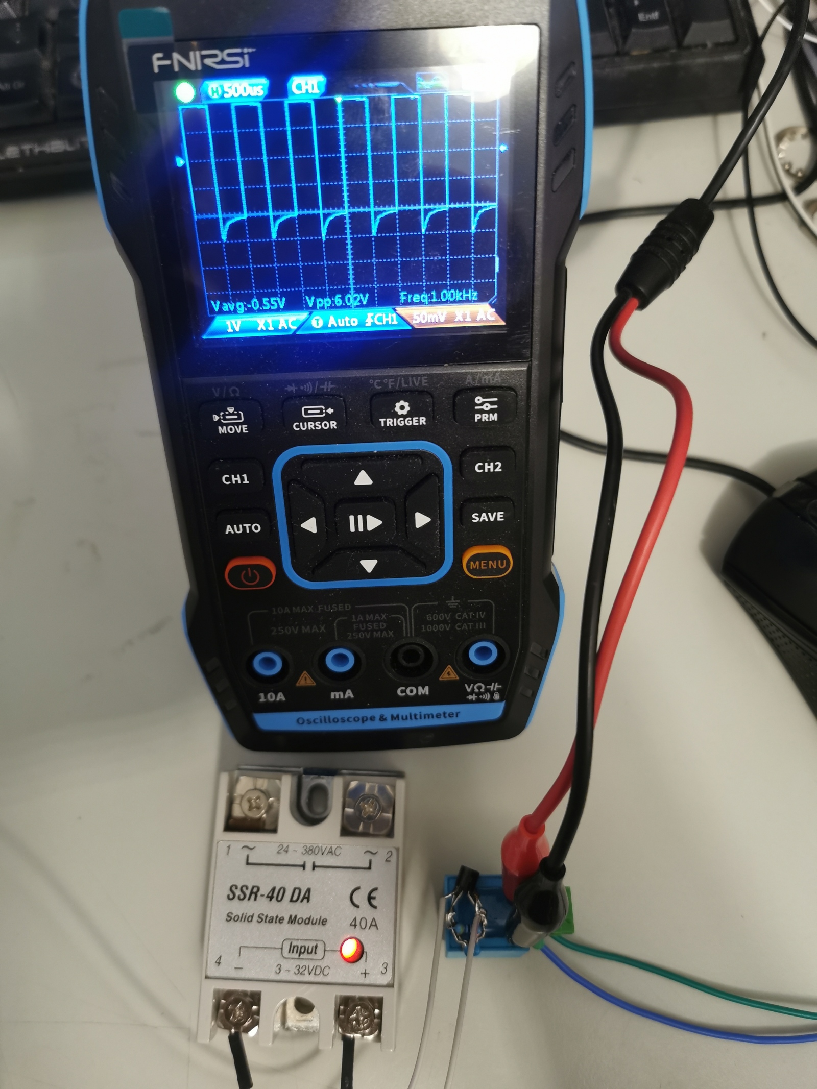

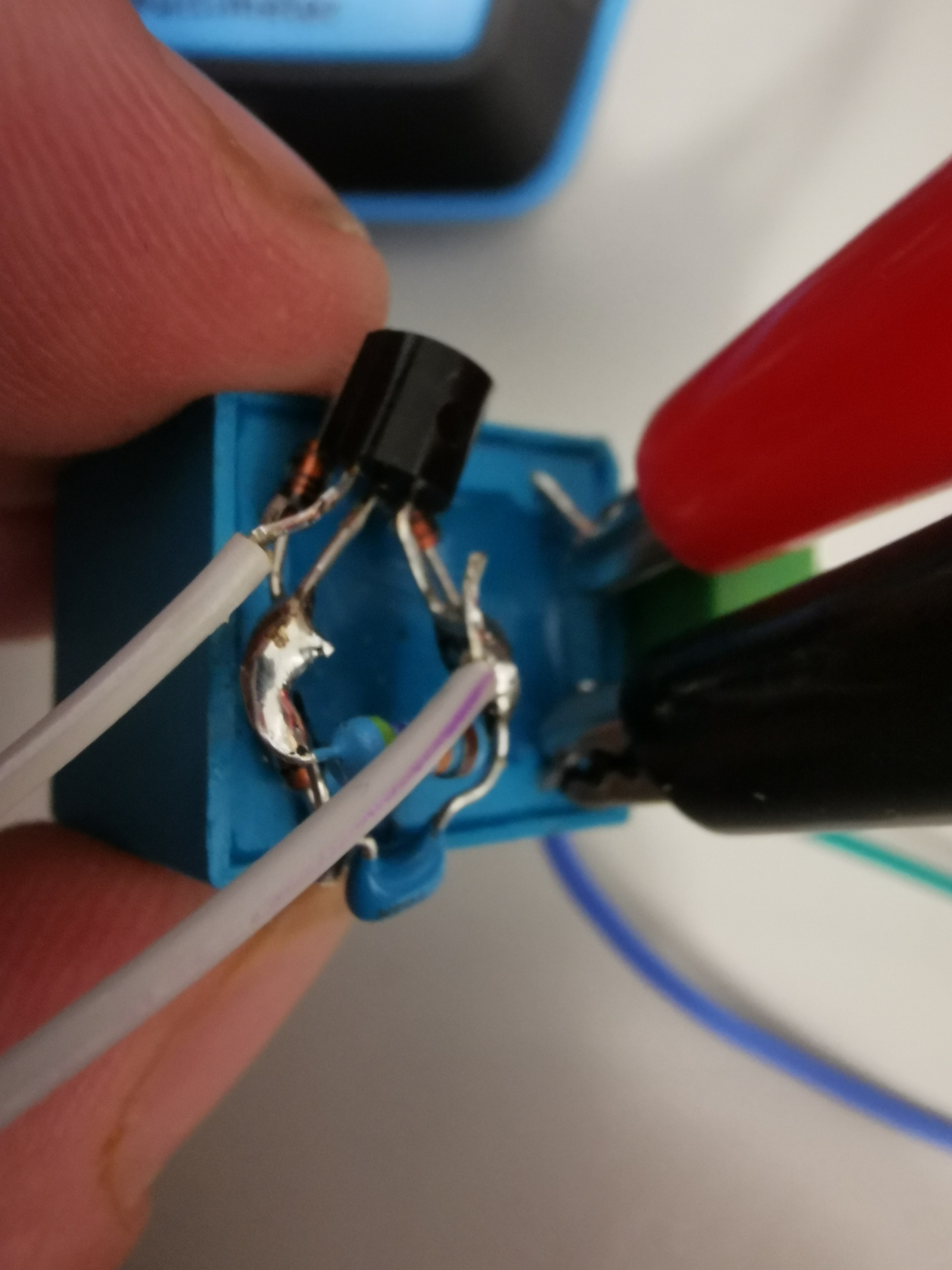

by COFHAL
Replied by COFHAL on topic Charge Pump
I just found this on AliExpress: Please help me choose!
$16.15 | MACH3 Charge Pump Module, Delay Control Module, 2 Pulse Delay Control Sensor
a.aliexpress.com/_mt0MzMv
