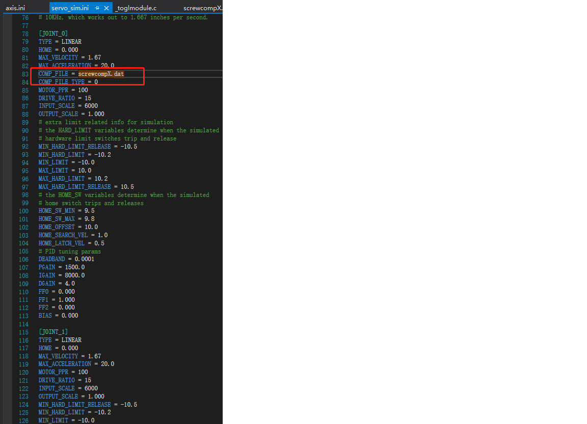

15 Sep 2021 09:25 #220686
by curran209
Replied by curran209 on topic Does every joint need to config COMP_FILE?
there is no compensation effect,why? I added comp_file as it is descripted in linuxcnc.org/docs/devel/html/config/ini-...t__lt_num_gt_section

17 Sep 2021 04:55 #220857
by curran209
don't work
