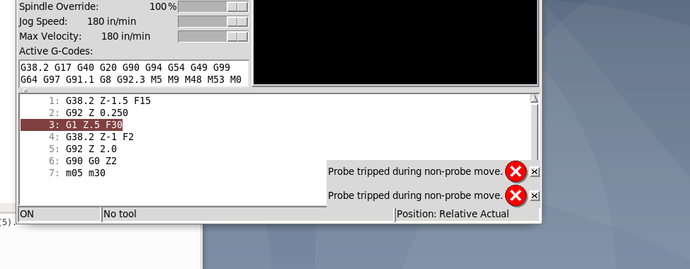

Hi GuysI have a simple question, I am using the Axis Gui and I would like to use a G-code touch off for the router bits I use. I have connected with pin #9 for the Probe input and it works very well, but there is a small problem in I get an error just after the touch off and first move up to about .5”. I have attached a screen shot of the G-code and the error I get and the line showing where it stops. I have used this routine on other tables for router bit positioning. I wonder if there is a Debounce setting in the Axis Gui. I have looked in the manual and on-line and the Linuxcnc web page for any info but cannot find a solution. I did find a similar routine but it seems it is written like a Macro with other additional code for other files. This seems like using a bowling ball to kill and ant. The main difference using the Linuxcnc is the probe g-code command is different. Mach and Uccnc both will recognize the G31 for probing where Linuxcnc uses a G38.2 to move the Z axis for this task. Have funTom

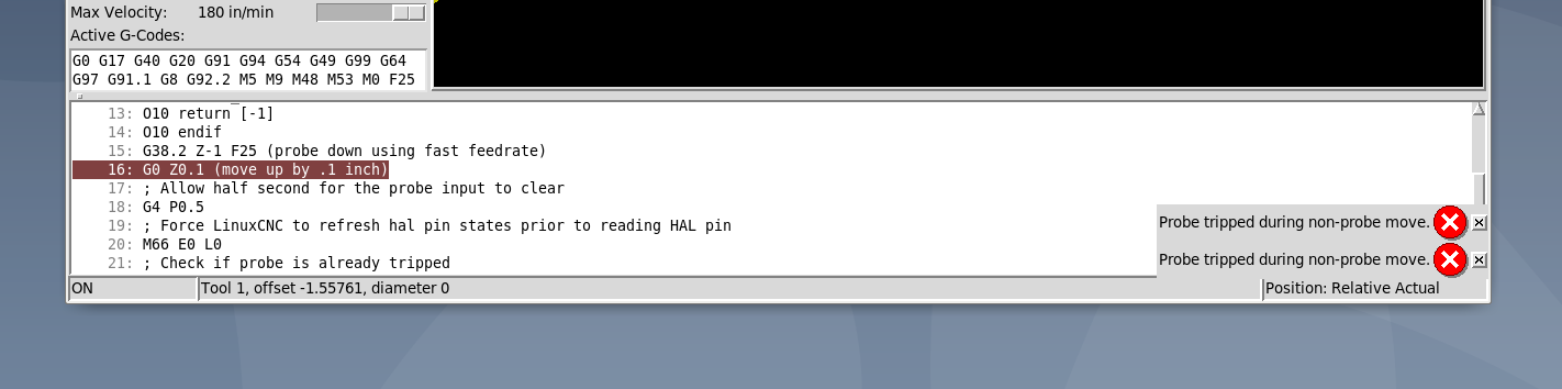

This is the gcode routine I use for setting Z height on my gantry router. It's mostly just a copy/paste from a probe routine at diycncdesign.com. Works perfectly. They also have instructions on how to add a button to call this routine without using a separate gcode file, but I haven't gotten into that far.

I went to the shop and loaded the G-code and it stops just about in the same location. Just after the torch rise off the metal.
Just something I checked under QTPlasmaC if I click on the Probe test button it moves down touched the metal plate moved back up to the value in the tool window (0.150"). It shows that value in the DRO. Then there is a pause and then it moves back up to where I set the DRO to 0.0 before the start of the test. the line in Hal reads #---probe-in ---
net probe-in <- hm_7i76e.0.7i76.0.0.input-9 Hal show shows it working for the probe in.

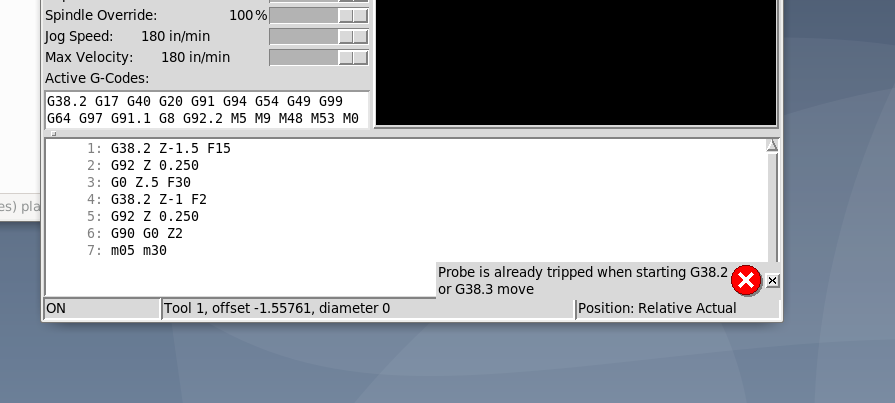

net probe-in <- hm_7i76e.0.7i76.0.0.input-9-not

thanks for the input Tommy, it show what I expected with the change of state for the input. It errored out stating the probe was tripped at the start and not movement of the g-code. This happened with either the short G-code shown and with the one Rob sent.
I am open to try other things if someone has an idea to post to get this going.
