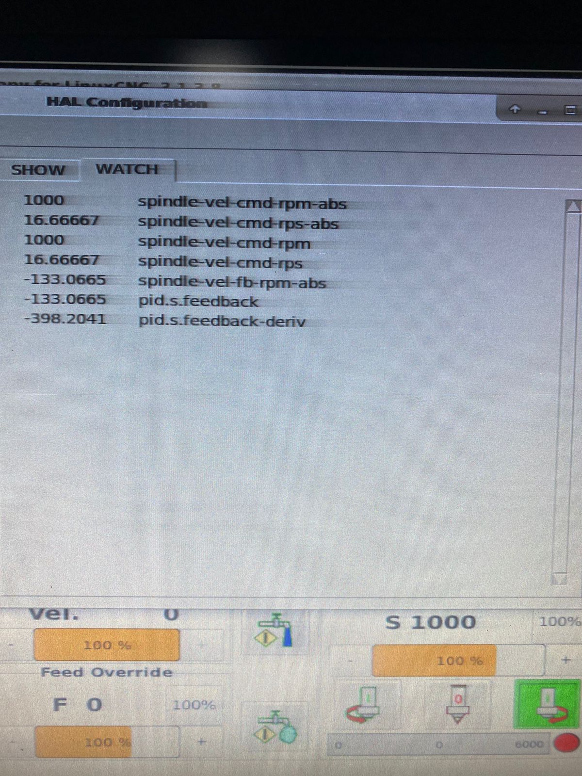

Hello, today I spent a few days trying to do the spindle encoder feedback, I was looking at other posts right here on the forum until similar problems but not the same and old too. I'm making a lathe, using Gmoccapy, a 7i76E board connected 1000ppr encoder (E6B2-CWZ6C) to the motor. The encoder works from 5-24vdc, NPN, A, B and Z signals. I did the pin signals tests there at Halshow and they are arriving perfectly from the board. I do the rotation test with or without the encoder it doesn't make any difference (I feel like I can't read) I physically turned off the encoder it obeys the frequency inverter rotation, as before. It has a small rpm range but it does. My question how do I effectively test closed loop? Is there any way to view it on the screen too?

14 Sep 2021 00:38 #220537
by Ingo
Replied by Ingo on topic Spindle encoder feedback
Today I was finally able to read my encoder feedback signal. Before, I could only see the signal from the Mesa board through Halshow, now I can see it through the PID.S (as attached). Could someone confirm me if the scale (resolution) is right? I'm thinking it's wrong, my encoder is 1000 ppr and in the ini file I also put 1000, the spindle rotation turned on 1000 rpm, but the motor rotates at 2000 rpm because it has a 1:2 reduction. Is this feedback value correct? Another thing also the sign Z (index) is not informing either, by the board Mesa arrives more appears, this one I couldn't understand. Is this signal needed to make thread synchronization? Thanks for the help thanks to you things are evolving.
