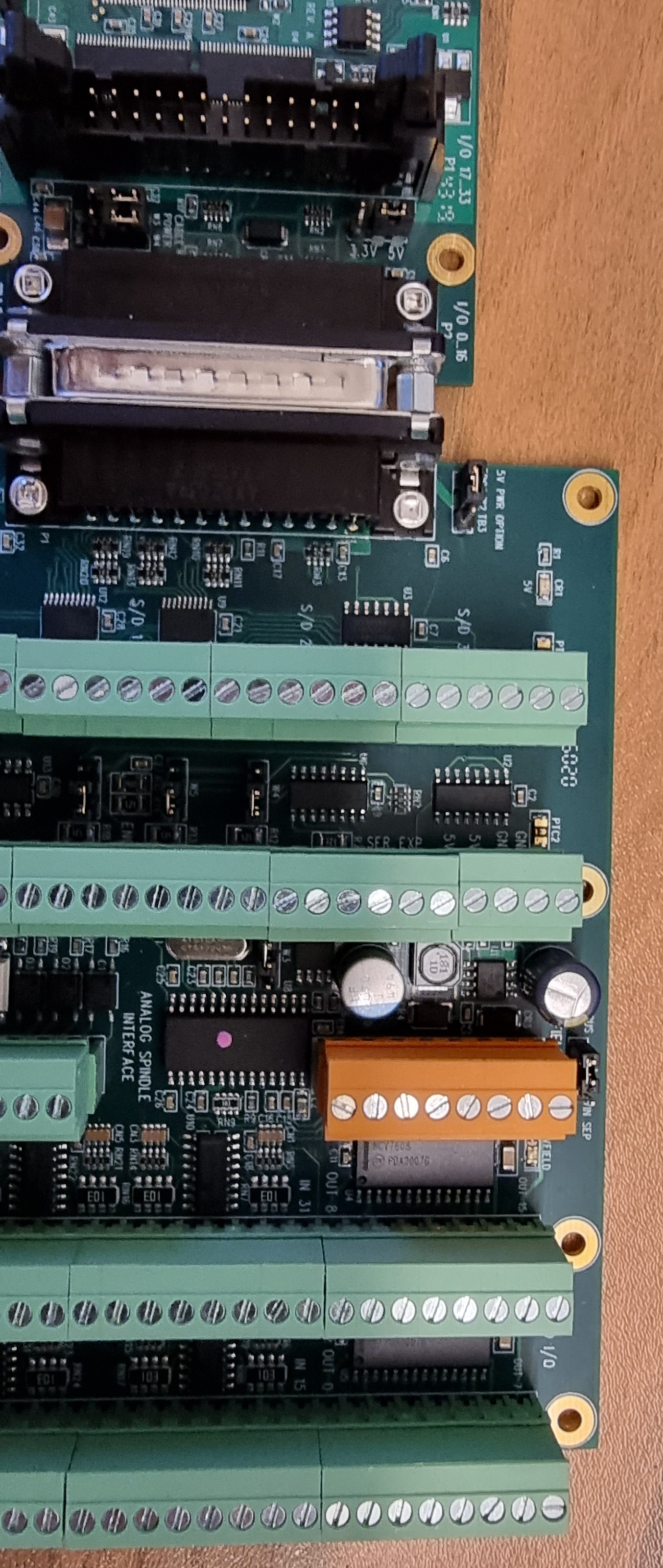

Hey there, im about to setting op my 7i76 for filed power, its connected by 7i92M who delivere 5v by the fpga ( 7i92 = W3,W4 UP BREAKOUT POWER ENABLED) and (7i76= W1 in left hand position, VIN=VBUS) so is this setup correctly, so i can connect 24vDC onTB1 pin5 (VIN) and ground on pin 8, ?
i just don´t want to burn the cards :O

That's correct. Make sure your 7i92M has the correct firmware.
