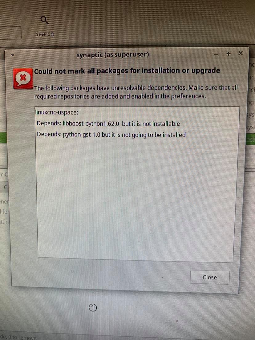

Linux mint 19, 4.19.3 rt kernel, Linuxcnc buildbot repo wont install was created by bevins

LinuxCNC Master has moved on to Python 3, so we are out of luck for now.
In the mean time have a look at Snowwy's Linux MX install how to, should work for QtPlasmaC as he uses it:
forum.linuxcnc.org/9-installing-linuxcnc...rd-new-windows-users
P.S.
You can google those two packages on the Debian site or google, use the links with pckg in the name, the normal Debian package search does not find anything.
