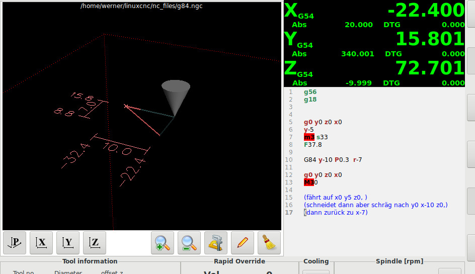

I just wanted to programme a G84, with G17 active and infeed axis in Z it was no problem, it worked straight away.
But now I would have to insert horizontal threads.
With the horizontal spindle of my Maho.
So G18 active
Infeed axis Y
I didn't manage to programme a G84.
now ask for a simple example?

- MaHa
- Posts: 540
- Thank you received: 240
05 Oct 2021 15:57 #222285
by MaHa
Replied by MaHa on topic G18 Plane and G84
If you look at machine configurations, you are limited to machining in Z direction for boring cycles. If you can do a separate config for horizontal machining, just swapping Y and Z configuration.
Otherwise, there is 'spindle synchronized motion with return' G33.1 with machining axis selectable.

05 Oct 2021 16:22 #222287
by DoWerna
Replied by DoWerna on topic G18 Plane and G84
g33 is not an option (yet) because I don't have an encoder on the spindle.
Ok so all (?) drilling cycles work only in G17?
Is now also no big deal, just wanted to know if I did something wrong or it simply not implemented
