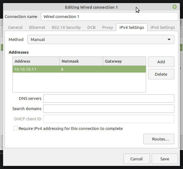

Replied by PCW on topic linuxcnc 2.8.2 no nm connection edit
Can you post the result of running this command:
ip a
Thanks!

Hello agin it is not attached itry to insert:
uhu@uhu:~$ ip a

2: enp1s0: <BROADCAST,MULTICAST,UP,LOWER_UP> mtu 1500 qdisc pfifo_fast state UP group default qlen 1000
link/ether 38:d5:47:16:f9:a3 brd ff:ff:ff:ff:ff:ff
inet 10.10.10.11/8 brd 10.255.255.255 scope global noprefixroute enp1s0
valid_lft forever preferred_lft forever
inet6 fe80::2265:82f9:7b9c:c6d0/64 scope link noprefixroute
uhu@uhu:~$
i hop you will find the problem thank you very much

I don't think a /8 netmask will work, you should use /24
(netmask 255.255.255.0)

Replied by tommylight on topic linuxcnc 2.8.2 no nm connection edit
Ip range 10.n.n.n uses /8 netmask normally, can be set to /16 or/24 to isolate intra networks.
But the netmasks are in the following format:
255.0.0.0 = /8
255.255.0.0 = /16
255.255.255.0 = /24
While broadcasts are:
10.255.255.255
10.10.255.255
10.10.10.255
Fixed the netmask in my reply
but still think /24 netmask is needed
(Need to check the 7I92s netmask logic)
If it helps, almost all my machines use 7i92 and all use the /8 netmask, never had a single issue.
Even the big Hurco uses 7i92 and same IP setup.
Oh goodie, found a PDF :
At some point the 7I92s netmask got changed from fixed
to EEPROM based. I need to check what this is set to.
OP:
Is the situation still the same? That is, what does:
mesaflash --device 7i92 --addr 10.10.10.10 --readhmid
report?
OP:
report?

Replied by bevins on topic linuxcnc 2.8.2 no nm connection edit
I always use an 8 bit mask now with a 10.0.0.0 network, but I do remember having issues with one of the mesa cards and when I set it to a 24 bit mask it worked.
/edit subnetting makes my head hurt so I don't do it anymore....lol
