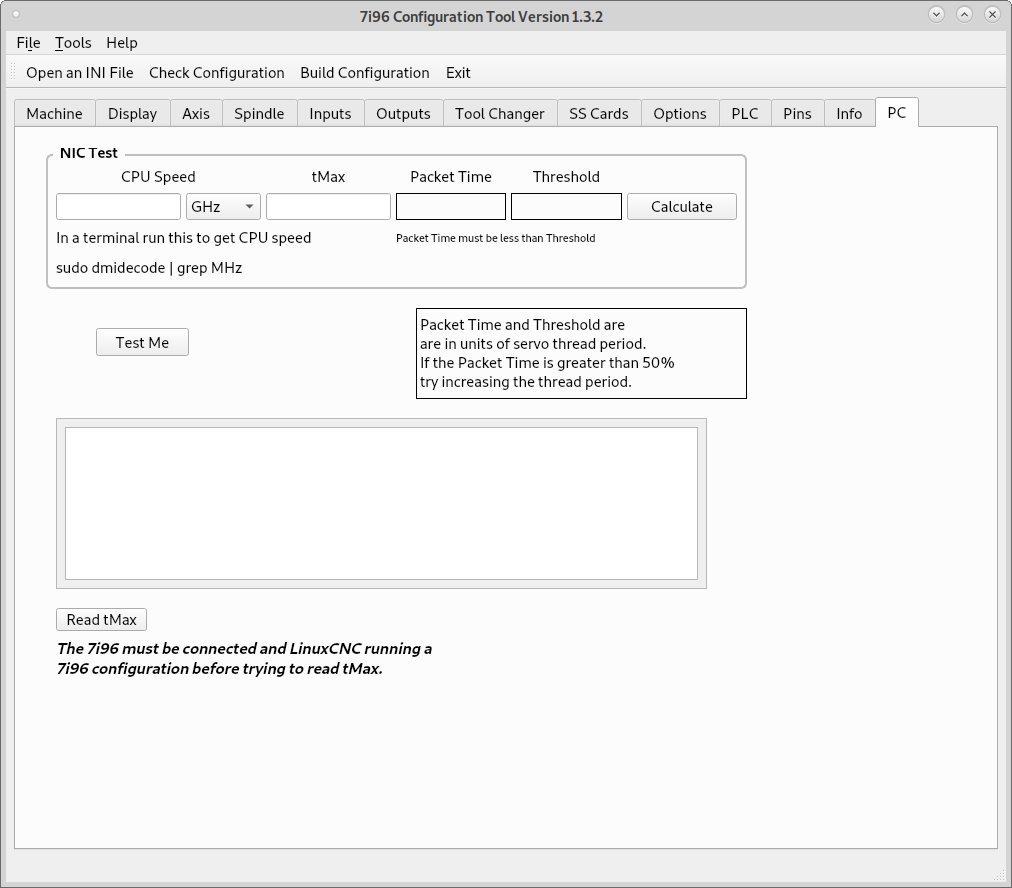

As far as I understand, pretty much all time values reported by HAL and Mesa cards are CPU clock counts instead of actual time (e.g.: thread time, thread max-time, hm2 *.tmax params, ...).
To convert these values to milli-seconds, I use the TSC tick rate calculated by the kernel, which can be extracted with:
For example, if the param read.tmax from my Mesa 7i96 is 300'000, the value in ms would be 300 * 1000 / tsc_khz.
Is this the correct way to do it?

My goal here is simply to make sense of the *.tmax values from my Mesa card, to check how much headroom I have for the servo thread rate.

10 Oct 2021 22:35 #222802
by BigJohnT
Replied by BigJohnT on topic Converting CPU clock values to wall time
- BigJohnT
- Posts: 3990
- Thank you received: 994
10 Oct 2021 22:36 #222803
by BigJohnT
The following user(s) said Thank You: tommylight, johnbl
- johnbl
- Posts: 42
- Thank you received: 5
11 Oct 2021 11:55 - 11 Oct 2021 11:55 #222849
by johnbl
Replied by johnbl on topic Converting CPU clock values to wall time
Nice! Didn't know about that feature.
