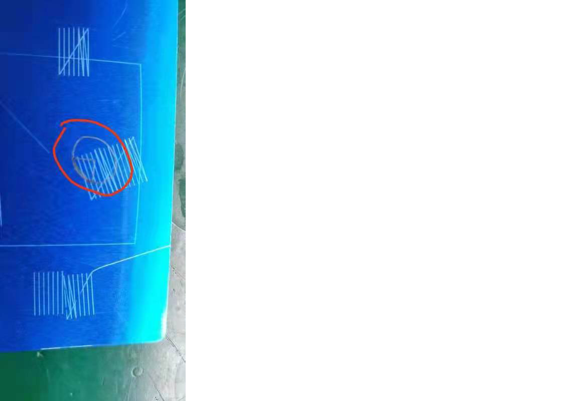

We use laser to draw circle on a aluminum sheet. Trajectory planning is round, but the circle drawed is not round.
Why the circle drawed by "G2 X390 Y-280 I5 J0" not round?

Very low acceleration or mechanical issues.

x & y axis not square

This could be simple geometry. Is the laser controlled by a galvanometer or is it moving on a cartesian axis?
If it is a galvanometer then the only place that a circle will be circular is exactly under the centre of the galvanometer.
This can presumably be corrected by a kinematics module.

The laser binded on the Z axis. Laser is on all the time. Draw this circle by moving the X and Y axis of servo motor.

@tommylignt I increased acceleration, but it didn't to be good.
Excluded mechanical issues, because another CNC has not this issue.
@RNJFAB x & y axis is square

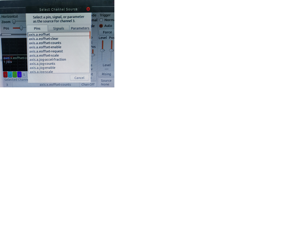

Can you use Halscope to plot the X and Y following errors?

sorry, can you tell me how to download Halscope and use it?

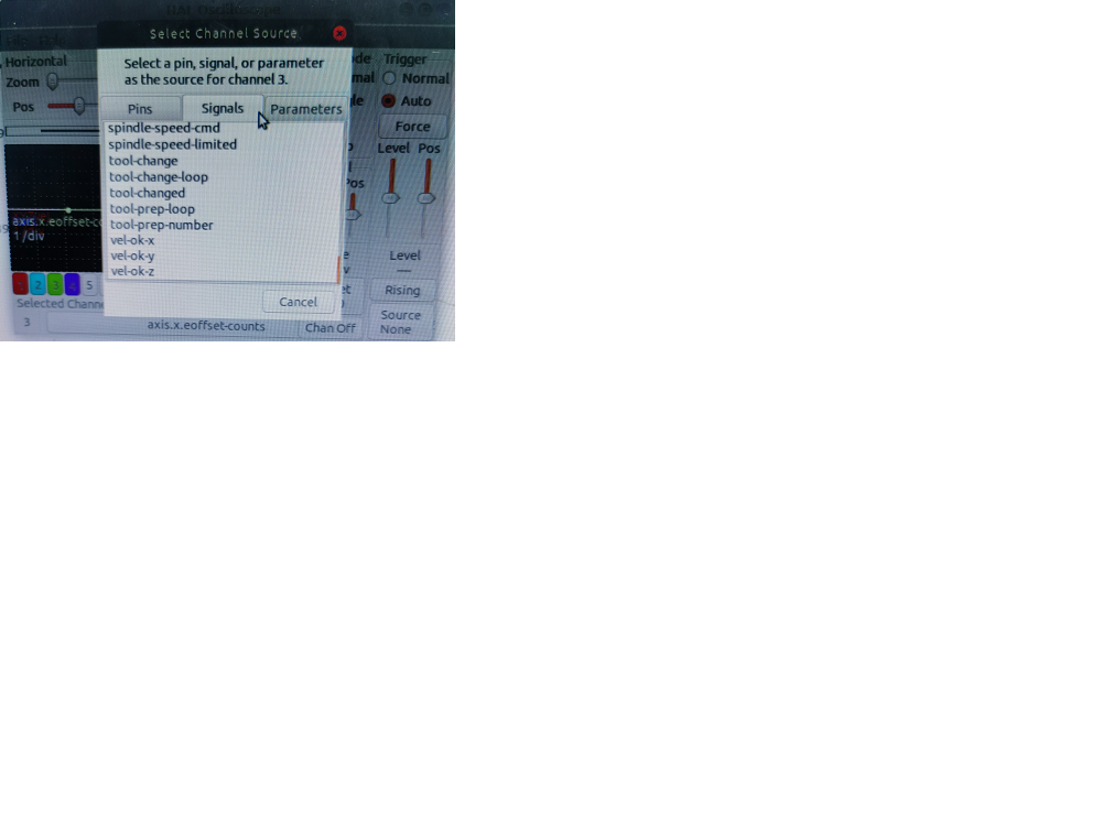

It's part of LinuxCNC.
linuxcnc.org/docs/2.8/html/hal/tutorial....ec:tutorial-halscope
Most GUIs can open it from the menu, or you can open it from the command line as described above.

Replied by curran209 on topic Why the circle drawed by "G2 X390 Y-280 I5 J0" not round?
