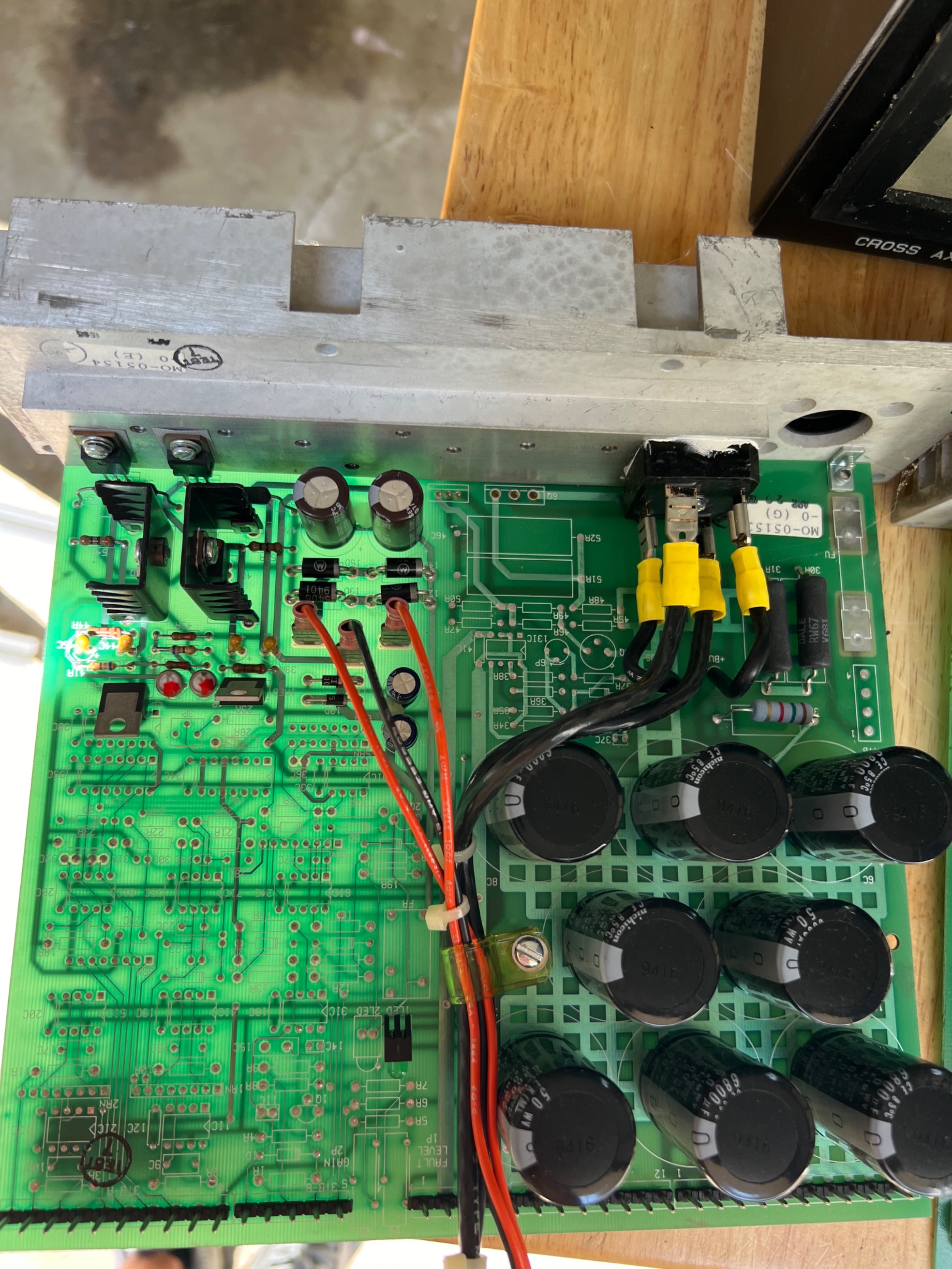

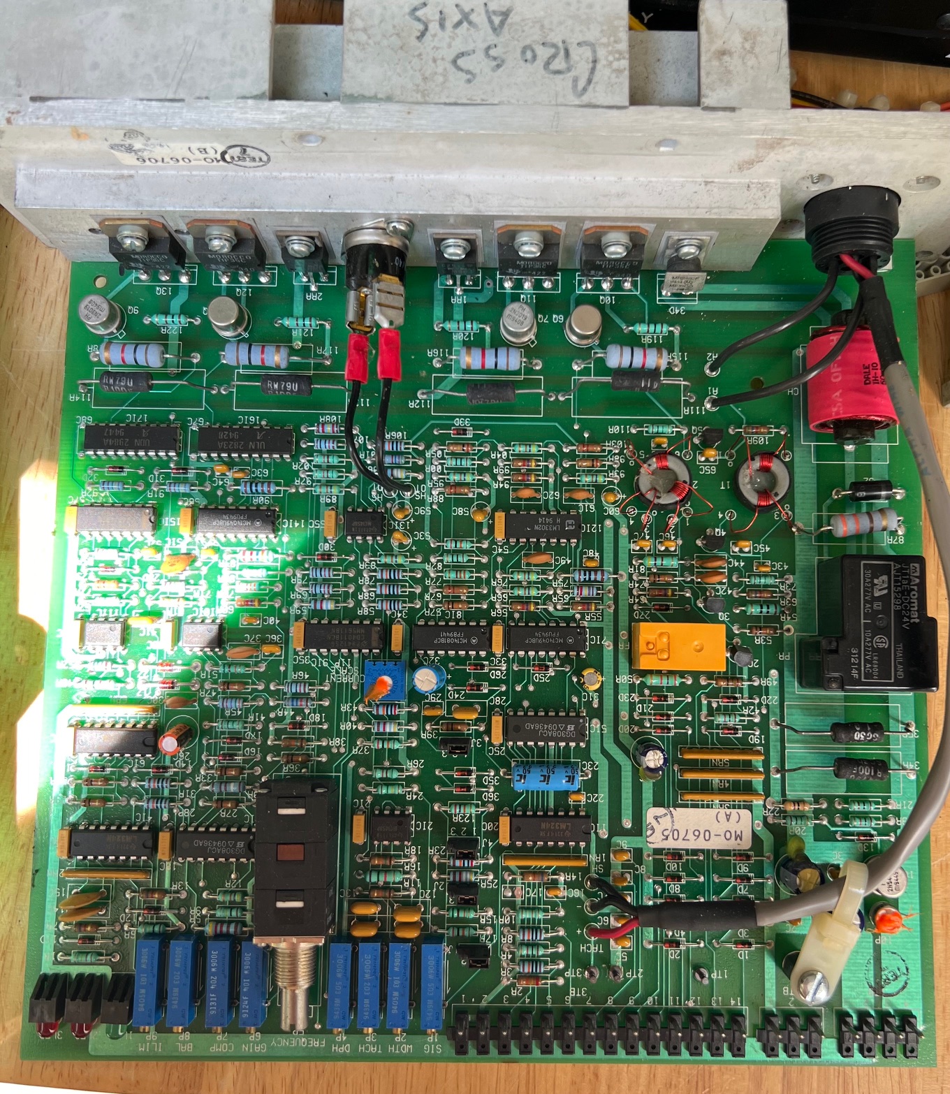

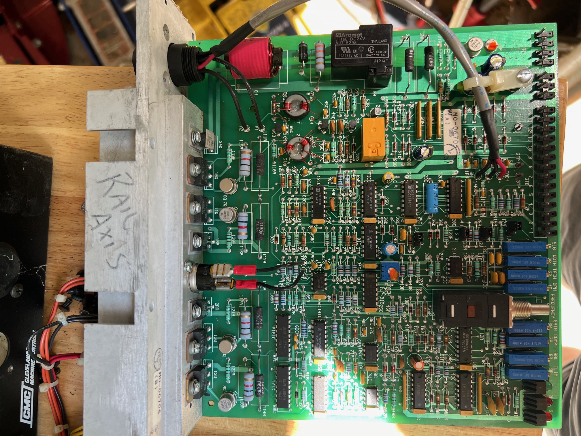

10 Jul 2024 15:00 #304844
Replied by PCW on topic Newb retrofit question
Those look like standard analog drives,
The real trick is figuring out the 14 pin connector pinout
The D41-17443C seems more common and probably has
the same pinout
Have you tried contacting CMC?
the same pinout

12 Jul 2024 08:14 #304993
by Ricoch3T
Replied by Ricoch3T on topic Newb retrofit question
I have not yet. I’ll give that a shot for a wiring diagram.
Interesting in the different board. They look almost identical. This machine was for sheet metal only so maybe that would be the difference.
