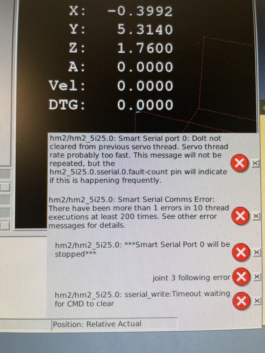

Another annoying after effect is that once these errors pop up, then the "Recycle Machine Power" button stops having an effect, and I need to restart the whole computer in order for the CNC board and the Linux machine to start talking.
Otherwise, if I don't restart the computer but I try to just restart LinuxCNC, the LED lights on the drivers keep staying red.
Previously, when on an occasion I got some error, I was able to just click the "machine power" button, I think it's F2, and then the LED lights would go back to green.

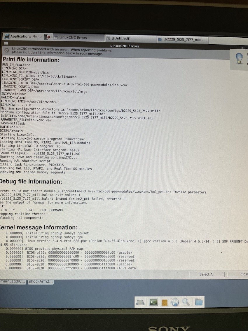

The debug errors indicate that LinuxCNC could not detect the 5I25 card,
Some likely reasons for this are:
PCI slot dirty or 5i25 card not full inserted:
Make sure card is full inserted and secure.
Clean slot and 5I25 fingers with 99% IPA.
Failing ATX power supply, 3.3V rail < 3.1V will prevent the
5I25 from coming out of reset state:
Replace power supply

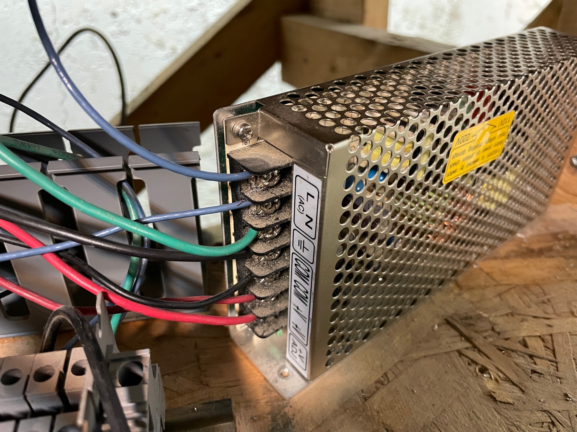

The power supply is something I neglected to mention in the first post.
A few weeks ago when it failed for the first time, I observed the green LED light on the power supply flickering.
So I attempted to replace it with another one, but was not successful and put back the original one, retightened the wires.
I don't observe the flickering of the green LED any more, but will replace it anyway.
If the 3.1V is the lower limit that I need to pay attention to, is there an upper limit I need to not exceed?
Is there a model/brand for power supply that is proven to be better?

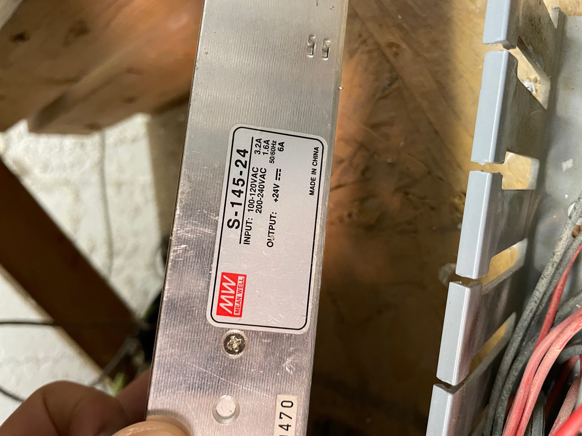

Thanks tommylight ! Here is the power supply I currently have. It used to run with this for a year since I have it, but I don't know how long it has run before. I attempted to find a replacement power supply online, but for some reason when I replaced all the cables it didn't even light up... there was no electric power at all. So I just put this old one back, but I want to replace it.
Can you please advise on what power supply would be best to buy?

I did decide to "test" the little screw on the power supply right next to the LED light. I thought it might bring that voltage above the low limit. But that didn't seem to do anything. I tried to put the screw back in original position, but it still only throws errors on start up. Before it used to occasionally start the LinuxCNC application, but now it just gives the error.
I definitely want to change the power supply. If anyone has an advice for a model, please share a link.
