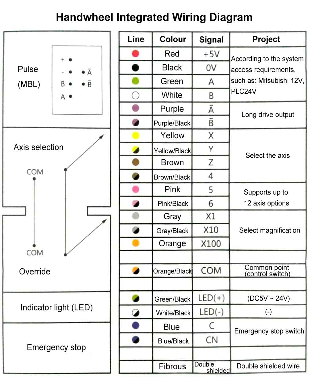

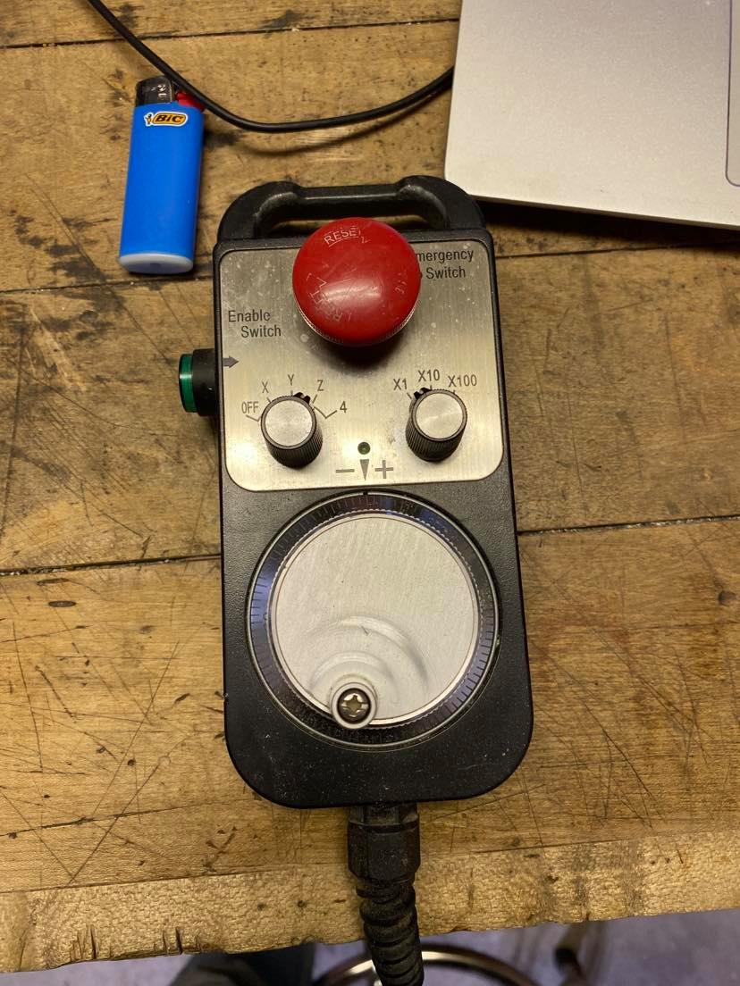

I don't know why but for the life of me I cannot get this working. The mpg came from a machine that was working with a 7i76.Can someone take a look and see if I am not
doing something obvious?

AHH... /HeadSlap..... I didn't check the jumpers. They are probably in Differential mode. I think I need single ended as I only use A and B.
Does jumpers W4 W5 W6 affect the encA and encB also or just the enc0 and enc1?
The thc is working with thcad so I dont want to mess with encA

I am using the 5v from TB2 for the mpg. Is this an acceptable behaviour? Are they isolated so where it has no ref to the inputs 16/17? Should I connect directly to the 5v power supply for the mpg? I also have puulups to the 5V power supply.
Replied by bevins on topic MPG not working with 7i76
ok so I am good there. The thc is working so I don't have to worry about those. So I am not getting anything on the mpg pins.Only the high speed encoder input (TB3 pins 7 .. 15) is affected by the single/differential mode jumpers .
The 7I76 MPG inputs (on TB5 pins 1,2,3,4) only support single ended inputs
TB5:
1 MPG Enc0A
2 MPG Enc0B
3 MPG Enc1A
4 MPG Enc1B

You need to have the 5V MPG power ground connected to the field power common
because the MPG inputs on TB5 have field power common as their ground reference
