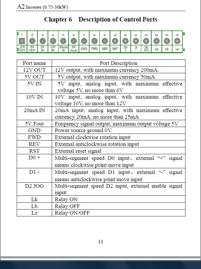

Hey guys,
I´m back with yet another problem I been facing.
First of all I ordered a Huanyang VFD but I seem to have gotten a clone. So, thats what I´m stuck with now.
I read here that it shoud be possible to control that VFD with my 7I96 instead of my now useless USB to RS485 adapter.
I also read that the 7i96 can give out PWM signals wich I could convert to 0 to 10V signals with a converter.
I need to get one of those converters.
What I dont understand is, where on the 7i96 do i get the PWM signals?
Do I need to assign them in the Pncconf wizard?
What exactly do I need to assign an how do I wire this stuff?
I added the connection sheet of my VFD down in the attachments.
Would be awesome if someone could help me with this.
Greetings, Mike

As I understand from this, I take one of the unused Stepgens for the pwm control for the spindle?
What firmware do I need to run on the 7i96 then?
I run a 7i85s aswell. I read somewhere that it has the abillity to output pwm signals aswell?

I don't think there is standard firmware for this (7I96+7I85S+PWM).
but I can make a bitfile. Where do you prefer the PWM output to
be connected?
be connected?

Does my current wiring setup change when I flash a new bitfile to my mesa combo?
My connections are currently as follows:
7i96:
TB1 Ste0, Step1, Step2 are for the X Y and Z axis
7i85S:
TB3 Enc0, Enc1, Enc2 are for the encoders fromthe X Y and Z axis.
Wiring wise, it would be nice to have the PWM signal on the 7i85s
TB1 Diff. Out 4 , 5
But any other place would do aswell as long as I know where it is ^^
That would be awesome if you could make a bitfile for me.
Thank you very much in advance.

Replied by PCW on topic Help with A2 Series VFD control with 7i96
This adds 1 PWM gen instead of the last stepgen on the 7I85S
I had to drop one more stepgen on the 7I85S for space reasons
Thia should not change any existing connections

So I got my analog to pwm board yesterday, I flashed your firmware on my card, Everything is still working like before.
I wrote some stuff in my hal and ini files.
I set num_pwmgens=1
But where in my 7i84s do I connect the wires that go to my pwm to analog board?
You said that you put the pwm generator on the last stepgen.
I assume that this is would be on the connector TB1 Diff 6,7 ?
Connector Pin 9 to 16, do I need to use the QA QB or ID pins?
In my hal I had setup the spindle as follows:
loadrt hm2_eth board_ip="10.10.10.10" config=" num_encoders=4 num_pwmgens=1 num_stepgens=4 sserial_port_0=0xxxxx"
loadrt pid names=pid.x,pid.y,pid.z,pid.s
# SPINDLE
setp pid.s.Pgain [SPINDLE_0]P
setp pid.s.Igain [SPINDLE_0]I
setp pid.s.Dgain [SPINDLE_0]D
setp pid.s.bias [SPINDLE_0]BIAS
setp pid.s.FF0 [SPINDLE_0]FF0
setp pid.s.FF1 [SPINDLE_0]FF1
setp pid.s.FF2 [SPINDLE_0]FF2
setp pid.s.deadband [SPINDLE_0]DEADBAND
setp pid.s.maxoutput [SPINDLE_0]MAX_OUTPUT
setp pid.s.error-previous-target true
setp hm2_7i96.0.pwmgen.00.scale [SPINDLE_0]MAX_OUTPUT
net spindle-index-enable <=> pid.s.index-enable
net spindle-enable => pid.s.enable
net spindle-vel-cmd-rpm => pid.s.command
net spindle-vel-fb-rpm => pid.s.feedback
net spindle-output <= pid.s.output
net spindle-vel-cmd-rps <= spindle.0.speed-out-rps
net spindle-vel-cmd-rps-abs <= spindle.0.speed-out-rps-abs
net spindle-vel-cmd-rpm <= spindle.0.speed-out
net spindle-vel-cmd-rpm-abs => hm2_7i96.0.pwmgen.00.value
net spindle-enable => hm2_7i96.0.ssr.00.out-01
net spindle-enable => hm2_7i96.0.pwmgen.00.enable
net spindle-cw <= spindle.0.forward
net spindle-cw => hm2_7i96.0.ssr.00.out-02
net spindle-ccw <= spindle.0.reverse
net spindle-ccw => hm2_7i96.0.ssr.00.out-03
net spindle-brake <= spindle.0.brake
net spindle-revs => spindle.0.revs
net spindle-at-speed => spindle.0.at-speed
net spindle-vel-fb-rps => spindle.0.speed-in
net spindle-index-enable <=> spindle.0.index-enable
sets spindle-at-speed true
Did I forget something?
I checked every port on my 7i85 with a multimeter and I can not find where Axis turns on or of the spindle / pwm signal.
Would be great if you could help me here again.
Thank you and have a nice sunday.
Greetings Mike
