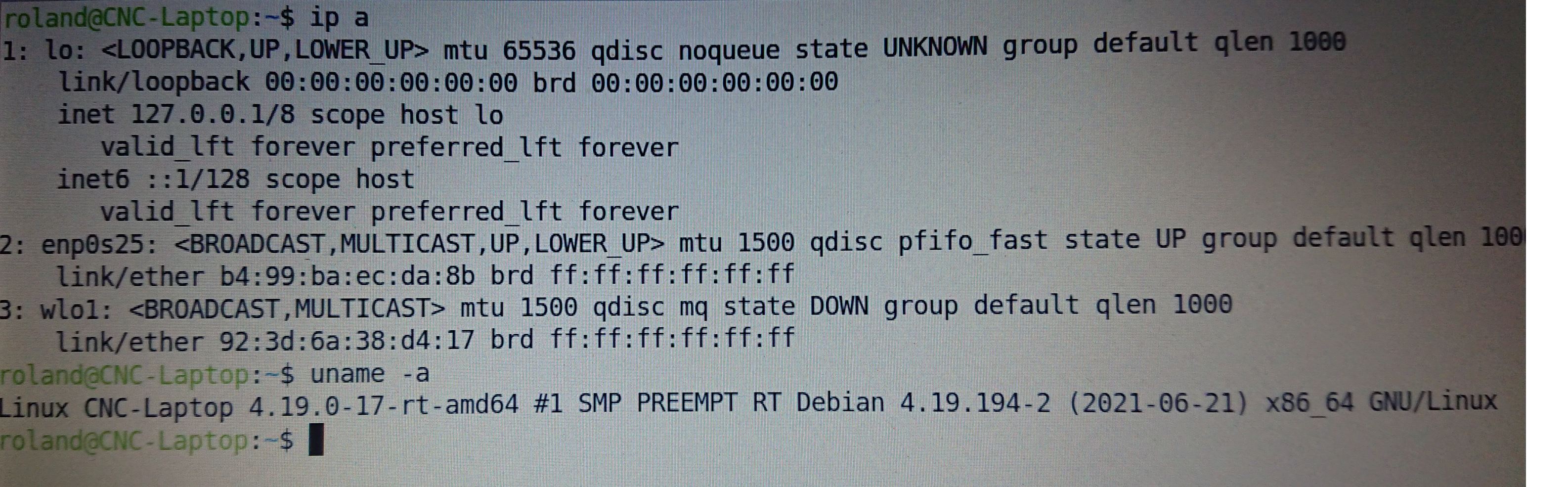

Hi
I run linuxcnc 2.8 and a MESA 7i76e(d) card. So far everthing up and running.
It happens that the ethernet connection gets randomly lost.
The ethernet connection is a 1-by-1 link to the Mesa card.
I tried the default IP and the 10.10.10.10 IP.
I tried the same setup on different computers with similar results.
any idea ?
any idea ?

- roland206
- Posts: 9
13 Nov 2021 15:02 #226323
by roland206
Replied by roland206 on topic Mesa 7i76e connection lost
Error report: System message
Coonection lost
no longer connected to 802-3-ethernet "Wired connection 1".
I added a dmesg
Coonection lost
I added a dmesg

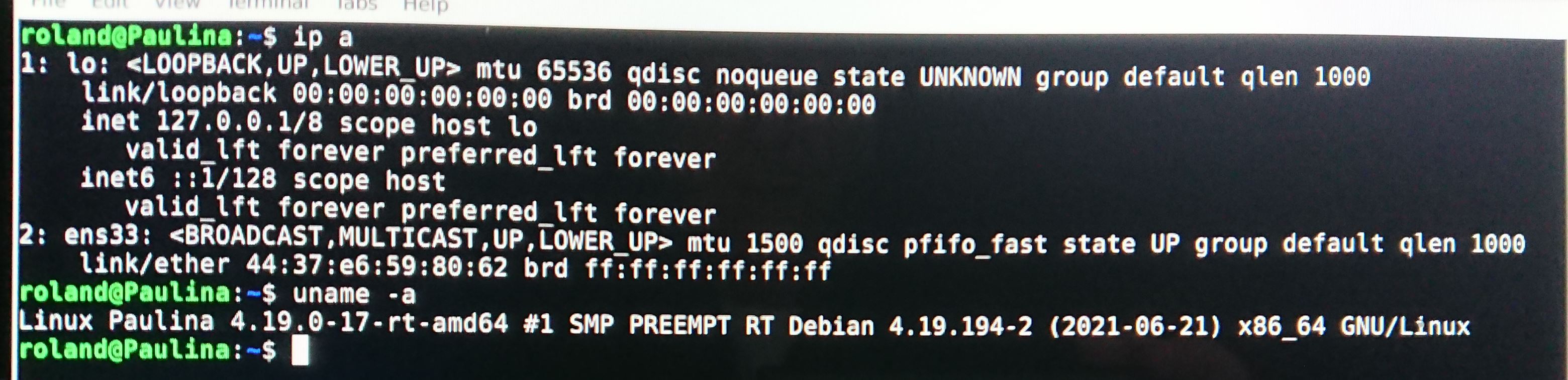

- roland206
- Posts: 9
13 Nov 2021 20:18 #226359
by roland206
Thanks for the reply.
However, as mentioned I have the same problem on another PC w/o WiFi.
Find attached the "ip a; uname -a" from the other PC with the same problem.
On the second PC it hapens less often (about every 3 minutes).
Anyhow, thx for helping
Roland
Roland
- Posts: 21870
- Thank you received: 7460
13 Nov 2021 22:42 #226378
Replied by tommylight on topic Mesa 7i76e connection lost
In booth cases the same issue, there is no network setup for use with Mesa board, PC must have a static IP address to communicate with Mesa, the manual refers to setting the board IP to default 192.168.1.121 or to set it to 10.10.10.10. Depending on the above, the PC network should be set to 192.168.1.100 OR 10.10.10.11.
Never used WiCD so no idea how to set it to manual, but a quick search should return plenty of results, search for Linux WiCD, not LinuxCNC WiCD.
