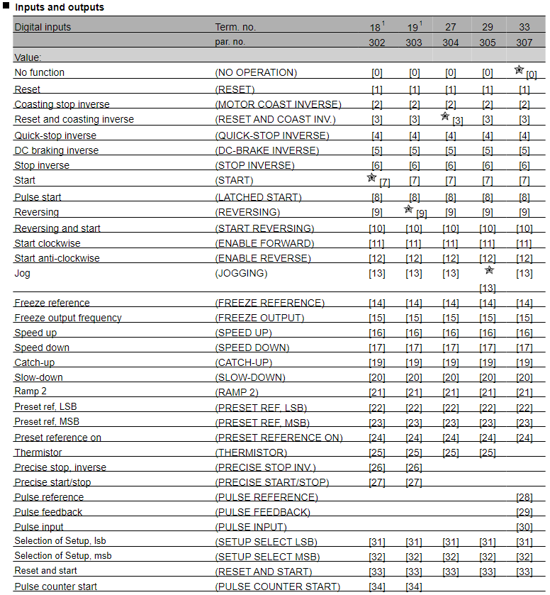

- FEMTO
- Posts: 8
28 Nov 2021 22:14 - 28 Nov 2021 22:46 #227851
by FEMTO
Replied by FEMTO on topic cant regulate the 0-10V TB4 Spindle output from Mesa 7i76e
The 10V output from the VFD is stable at 10.4V until i give M3 or M4 command. After the command it drops down to 0.7V. Maybe this problem comes from the wrong input start signals for the VFD. There is a possibility to change the parameters for the pins on the VFD, maybe someone fits for the 7i76e. i attach the page from the manual. start clockwise and start anti-clockwise maybe?
I found the information for the pin 27 on another forum, its something like an enable signal for the remote control of the VFD. Without this i was far from spindle movement.
Last edit: 28 Nov 2021 22:46 by FEMTO.
- Posts: 21756
- Thank you received: 7433
28 Nov 2021 22:18 #227853
Replied by tommylight on topic cant regulate the 0-10V TB4 Spindle output from Mesa 7i76e
That points to wiring issues.The 10V output from the VFD is stable at 10.4V until i give M3 or M4 command. After the command it drops down to 0.7V.
