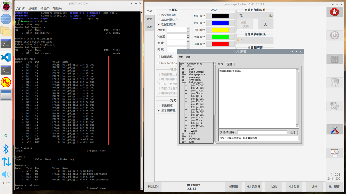

hello everyone
I found a project about raspberry pie on "GitHub", which allows raspberry pie to connect to the parallel port control board to control CNC.
This is the website of the project:
github.com/ChrisWag91/PI-LCNC
Thank Chris wag91 for his dedication. But I also have a lot of doubts about this project
This is a test system。
I have a big question about the GPIO components of raspberry pi
I enter in the terminal:
loadrt hal_ pi_ gpio
show all hal_pi_gpio
Why are the pins displayed in the terminal different from those displayed in "linuxcnc Hal configuration"

28 Nov 2021 08:48 #227803
by tjtr33
Replied by tjtr33 on topic PI-LCNC Project
Hello
they are not different
on left it says
hal_pi_gpio,pin-03-out
on right it says
hal_pi_gpio
|_ pin-03-out
it is same name, just formatted 2 ways,
1) as a full name
Fred Flintstone
2) versus family name, given name
Flintstone
|_ Fred
hth TomP

- tjtr33
- Posts: 170
- Thank you received: 54
28 Nov 2021 09:02 #227804
by tjtr33
Hello
maybe this will help...
please take care,
gpio pin numbers
are not
raspberry pi header pin numbers
---from the hal_pi_gpio.c file----
// elinux.org/index.php?title=RPi_Low-level...herals&printable=yes
// Rev 1 Raspberry:
static unsigned char rev1_gpios[] = {0, 1, 4, 7, 8, 9, 10, 11, 14, 15, 17, 18, 21, 22, 23, 24, 25};
static unsigned char rev1_pins[] = {3, 5, 7, 26, 24, 21, 19, 23, 8, 10, 11, 12, 13, 15, 16, 18, 22};
// Rev2 Raspberry:
static unsigned char rev2_gpios[] = {2, 3, 4, 7, 8, 9, 10, 11, 14, 15, 17, 18, 22, 23, 24, 25, 27};
static unsigned char rev2_pins[] = {3, 5, 7, 26, 24, 21, 19, 23, 8, 10, 11, 12, 15, 16, 18, 22, 13};
// Raspberry2/3:
static unsigned char rpi2_gpios[] = {2, 3, 4, 5, 6, 7, 8, 9, 10, 11, 12, 13, 14, 15, 16, 17, 18, 19, 20, 21, 22, 23, 24, 25, 26, 27 };
static unsigned char rpi2_pins[] = {3, 5, 7, 29, 31, 26, 24, 21, 19, 23, 32, 33, 8, 10, 36, 11, 12, 35, 38, 40, 15, 16, 18, 22, 37, 13 };
for the raspberry pi you are using ( one of 3 sets above)
the upper line is the gpio number
the lower line is the rpi header pin
so try Halrun
and use setp to turn on and off gpio pins
and a voltmenter to see where the rpi pin is
i wrote a different driver that only uses rpi header pin number
because thats the thing i can probe and connect to
It wasnt popular ;-/
HTH tomp

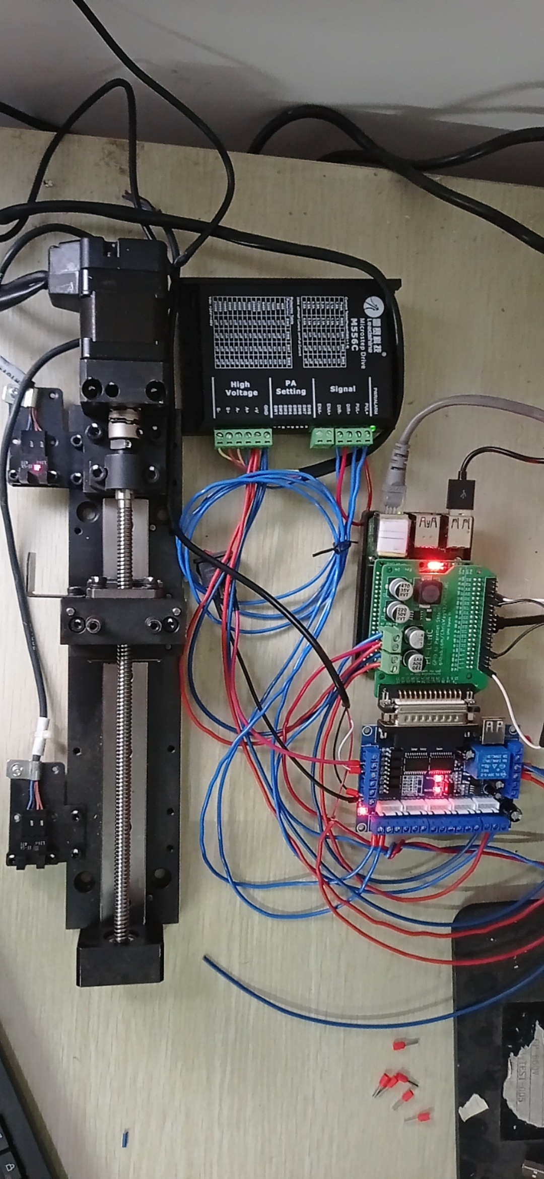

- tuzki
- Posts: 48
29 Nov 2021 17:28 #227929
by tuzki
I use "setp hal_pi_gpio.pin-40-out 1" to control the pin output, but nothing happens, and the pin voltage is still 0V.
I think the GPIO pin printed out by the terminal is the number of the Raspberry Pi header. I did not forget to enter "halcmd start", but nothing happens to the Raspberry Pi pins.
I don't know why.`(*>﹏<*)′`(*>﹏<*)′
