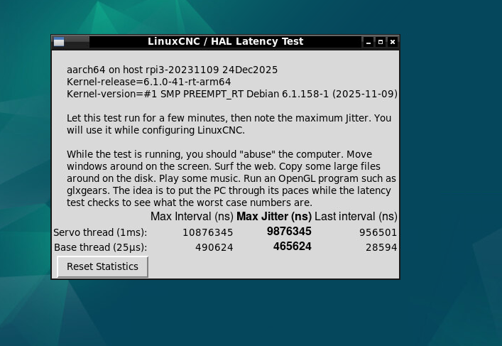

20 Dec 2025 05:16 #340342
by unknown
Replied by unknown on topic Linuxcnc Image for Raspberry Pi 3
There are no premade RPi3 images available for download.
You have a couple of options.
1: Someone maybe able to make one, but it would require that person having access to a Rpi3.
2: Find someone with Linux knowledge who can also speak english and is willing to help.
3: Have a go following someone's instructions, all is not lost if you make a mistake.
4: Look into using grbl.
A bit of a warning regarding the RPi3, you may have latency issues, which there may not be a solution for fixing it. Increasing thread period may not give smooth operation.
Saying that you don't understand all the time wont help. I'm sorry I really wish it was different.

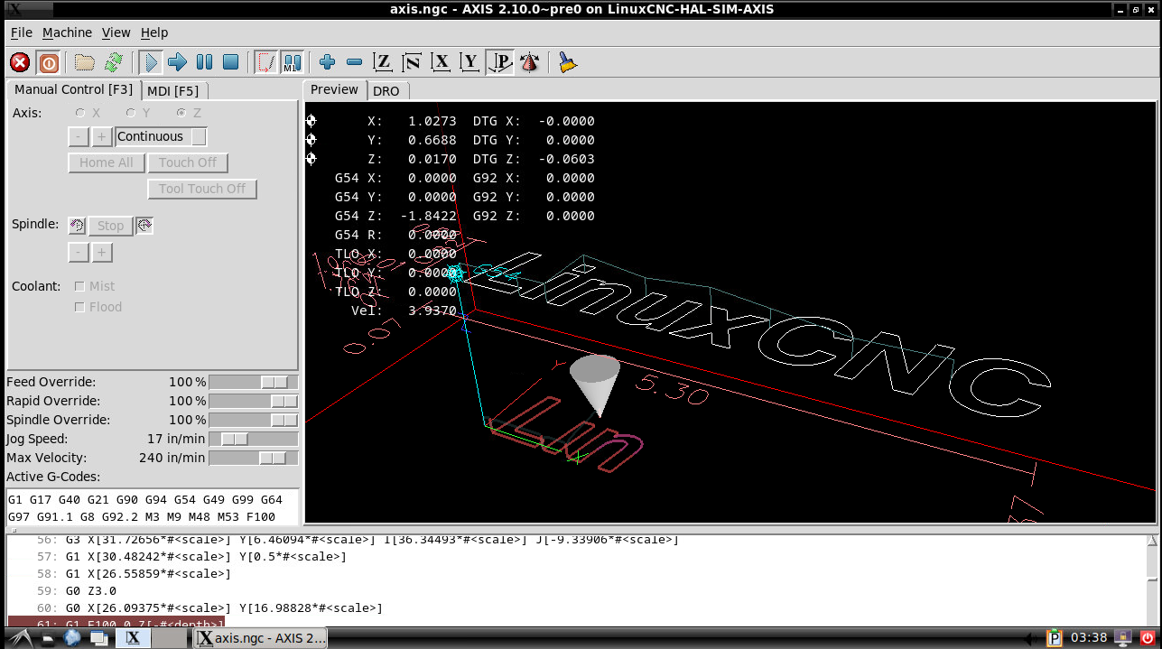

23 Dec 2025 22:12 #340452
by NWE
Replied by NWE on topic Linuxcnc Image for Raspberry Pi 3
Wow, I can hardly believe I did this to a pi 3. The simulation is running. Next I want to check if gpio and a couple other basics work. The latency numbers look a bit sad.
Still no luck starting QtDragon.

23 Dec 2025 23:19 #340454
by NWE
Another latency test. The previous one I shared was run a couple minutes with nothing else running. This time I gave it the works. How about 10mS latency.
