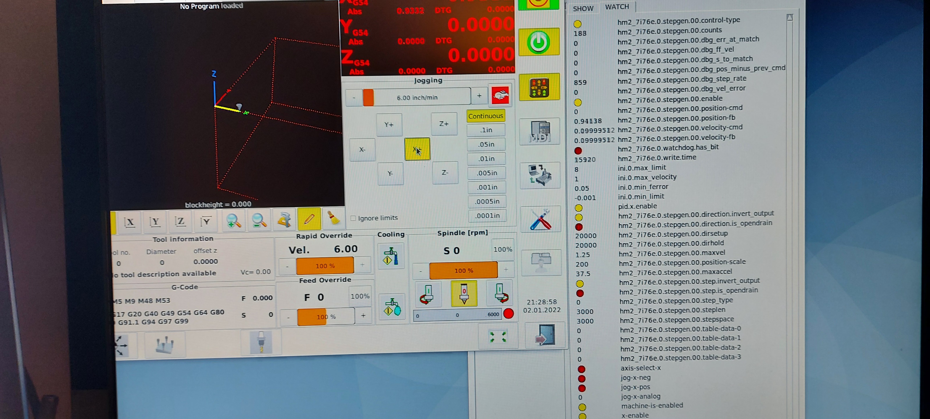

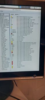

I did watch and no it did not.Here are some pids taken while moving x+.

- Posts: 18080
- Thank you received: 5316
03 Jan 2022 02:43 #230610
Replied by PCW on topic No steps Mesa 7i76e
Did you try 20000 on the steplen?
Does the direction signal change when you jog in alternate directions?
What are the static voltages on STEP+, STEP-, DIR+, DIR- ?

03 Jan 2022 23:47 #230694
by ggsxx
Replied by ggsxx on topic No steps Mesa 7i76e
So i did try putting 20000 on the steplen and nothing.I changed the step type to quadrature. The pid for stepgen positon-cmd doesn't change but the pid for stepgen position-fb does change. Also i'm not shure what you mean by static voltage at step+, step-,dir+,dir-.
