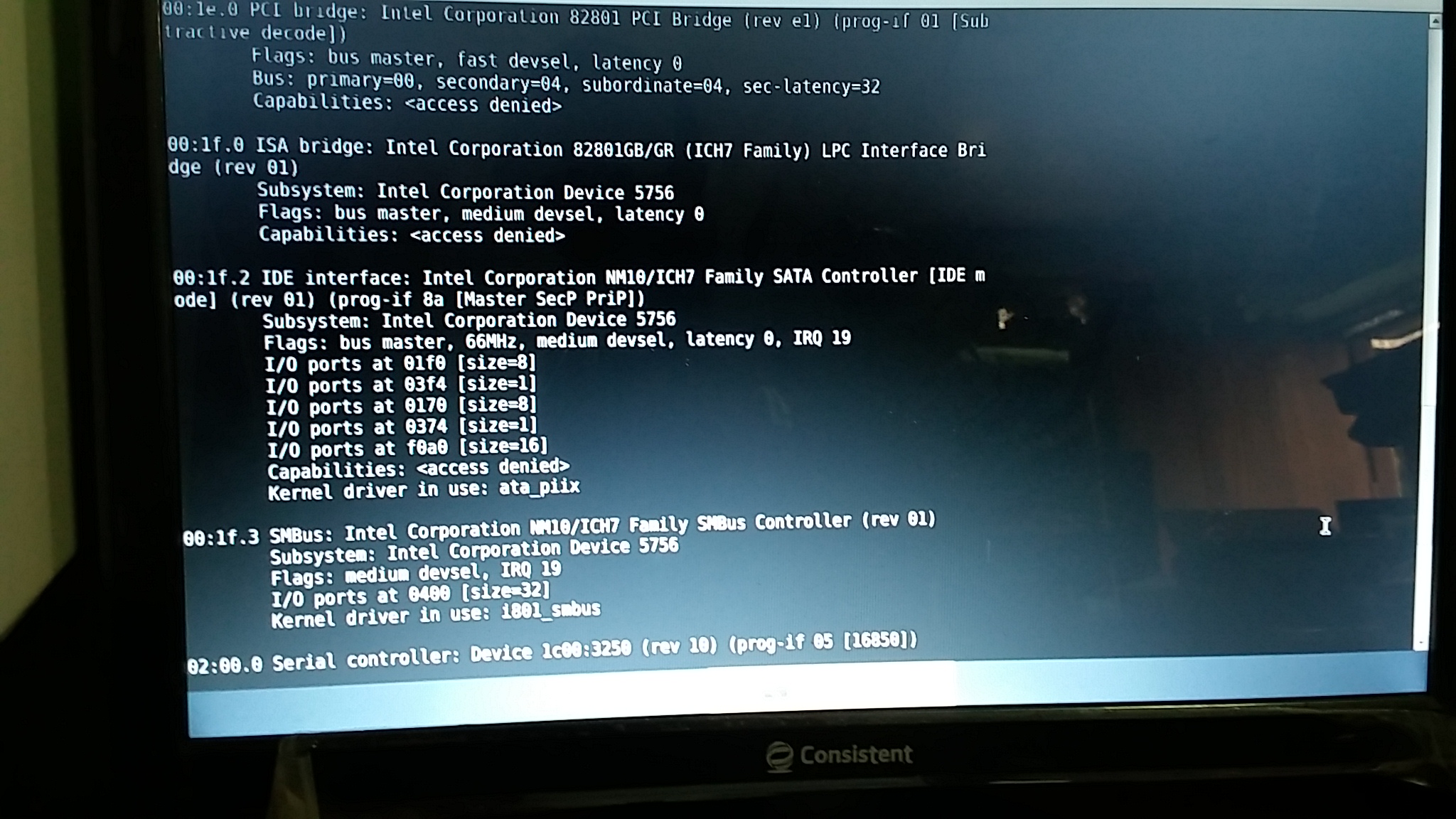

Dear Friends,
I installed linuxcnc 2.7 wheezy with RTAI. Earlier I was doing Linuxcnc 2.8.2 buster RT-Preepmt, but latency became the barrier. With RTAI , Latency is below 17000ns.
Now with RTAI, the parallel port error occurs.
The parallel port is enabled in bios. In my PC, one Parallel port is on motherboard itself, other is on PCIE slot.
The lspci -v screen and linuxcnc error message is attached.
I have already tried rmmod lp, rmmod ppdev & rmmod -f parport_pc. but no luck.
How to get rid of this.?

Please attach your hal, ini & linux debug files and the screens shots you supplied do not show anything regarding the parallel port.
Screens shots are very difficult for debugging as other users have to read through the logs rather than using grep or some other tool to look for the info they need to debug.
This thread here has information regarding how to get some useful parallel port info from your system.
forum.linuxcnc.org/18-computer/42826-par...-info-thread?start=0
If you search there are a lot and I mean a lot of threads that other users have started with issues with the parallel port.

Well, with few hour study, I understand that parallel port address need to be added to hal file 'cfg='.
$lspci and $cat /proc/ioports screen attached. My PC is having 1 parallel port on MB, another in PCIE X1 slot.
But what is the address exactly?? I am not able to find out, need help.

try
As doing it without superuser privileges produces output that has no actual info.
Also I think you should try and read this:
linuxcnc.org/docs/2.8/html/config/stepconf.html
As it looks like you tired to use a simulator config.
sudo cat /proc/ioportsAs doing it without superuser privileges produces output that has no actual info.

I got sucess for one parallel port with its address added to 'cfg=0x0378 out'.
But same is not happening for 2nd parallel port when I use step config wizard witj two parport.
The error shows partport.ko: busy or unavaliable.
what is the solution??

From your output
We can see that the kernel has loaded the kernel module for your PCIe parallel port.
There is an I\O Port at e000.
Now if you had of followed the links on the page I linked, the links are on that page to help, you would have found this page.
wiki.linuxcnc.org/cgi-bin/wiki.pl?Parallel_Port_Cards
Be sure to look at the Parallel Port test page as well.
The reason for that page was to help indentify which cards work and links that provide information that is not included.
02:00.0 Serial controller: Device 1c00:3250 (rev 10) (prog-if 05 [16850])
Subsystem: Device 1c00:3250
Physical Slot: 0
Flags: bus master, fast devsel, latency 0, IRQ 16
I/O ports at e000 [size=256]
Memory at e0508000 (32-bit, prefetchable) [size=32K]
I/O ports at e100 [size=4]
Expansion ROM at e0500000 [disabled] [size=32K]
Capabilities: <access denied>
Kernel driver in use: parport_serial
Kernel modules: parport_serialWe can see that the kernel has loaded the kernel module for your PCIe parallel port.
