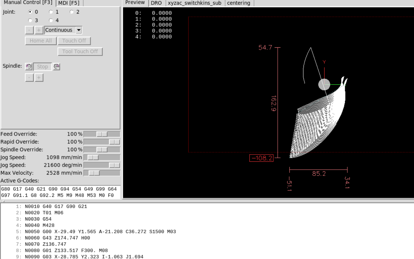

I wrote a simple G code to process a blade, but after importing LinuxCNC, the tool path displayed was completely incorrect. I verified that there was no problem with the G code on CIMCO Edit software, so I can't think of my mistake, please help me.
This is the path I verified in CIMCO_Edit software:
This is the tool path generated in LinuxCNC:
This is my G code:

21 Jan 2022 09:06 #232612 by tommylight
There are 5 joints in that screenshot, how are your axis set in the ini file, display and traj section ?

I installed version 2.9So I ran the xyzac Kinematics directly in version 2.9The configuration in INI looks like this:
[DISPLAY]
            GEOMETRY = XYZ-A
           OPEN_FILE = ./demos/xyzac_switchkins.ngc
               PYVCP = ./xyzac-trt.xml
            JOG_AXES = XYZC
             DISPLAY = axis
MAX_ANGULAR_VELOCITY =  360
 MAX_LINEAR_VELOCITY = 1000
     POSITION_OFFSET = RELATIVE
   POSITION_FEEDBACK = ACTUAL
   MAX_FEED_OVERRIDE = 2
      PROGRAM_PREFIX = ../../nc_files
          INTRO_TIME = 1
             #EDITOR = gedit
         TOOL_EDITOR = tooledit z diam
               TKPKG = Ngcgui 1.0
         NGCGUI_FONT = Helvetica -12 normal
      NGCGUI_SUBFILE = xyzac_switchkins_sub.ngc
      NGCGUI_SUBFILE = centering.ngc
[TRAJ]
                COORDINATES = XYZAC
               LINEAR_UNITS = mm
              ANGULAR_UNITS = deg
    DEFAULT_LINEAR_VELOCITY = 20
        MAX_LINEAR_VELOCITY = 35
    MAX_LINEAR_ACCELERATION = 400
DEFAULT_LINEAR_ACCELERATION = 300
21 Jan 2022 09:45 #232619 by jess

Seems to me you have some settings in your CAM/Postprocessor/CimcoEdit that do not agree with the 'xyzac-trt' kinematics in LinuxCNC.
The only idea I can come up with to maybe find out what is wrong is to turn the workflow around and import the demo file /sim/axis/vismach/5axis/table-rotary-tilting/demos/boat-xyzac.ngc into CimcoEdit and see what that looks like. Likely it will not look as it should using your present settings so you will need to adjust those settings until you get a correct toolpath for the demo file and then use those in your CAM/PostProcessor.
Sadly there has been a lack of user feedback regarding 5axis machining which has greatly hindered development in this area.
So all feedback is welcome!

I did a quick test using the settings as seen in the screen shot that seem to give a reasonable backplot for your code:
And here the boat-xyzac.ngc which is clearly not happy with the same settings:
[2.edit]
Also note that, as has been recently suggested, the rotation direction in the 'xyzac-trt' and 'xyzbc-trt' kinematic might be opposite to the standard definition in that positive rotation is in reference to the machine coordinate system and not in respect to the tool.  But since the original author has not been heard from for several years and only sporadic feedback trickles from users who may or may not be competent the question has not been resolved.
[3. edit]
Just dawned on me that you are probably using trivial code (ie the kinematics was calculated in the CAM, while the boat-xyzac.ngc file is TCP code. So my approach above might not very useful.
But maybe this thread contains something of interest:
forum.linuxcnc.org/38-general-linuxcnc-q...aneous-setup-in-lcnc
Last edit: 23 Jan 2022 13:25 by Aciera.

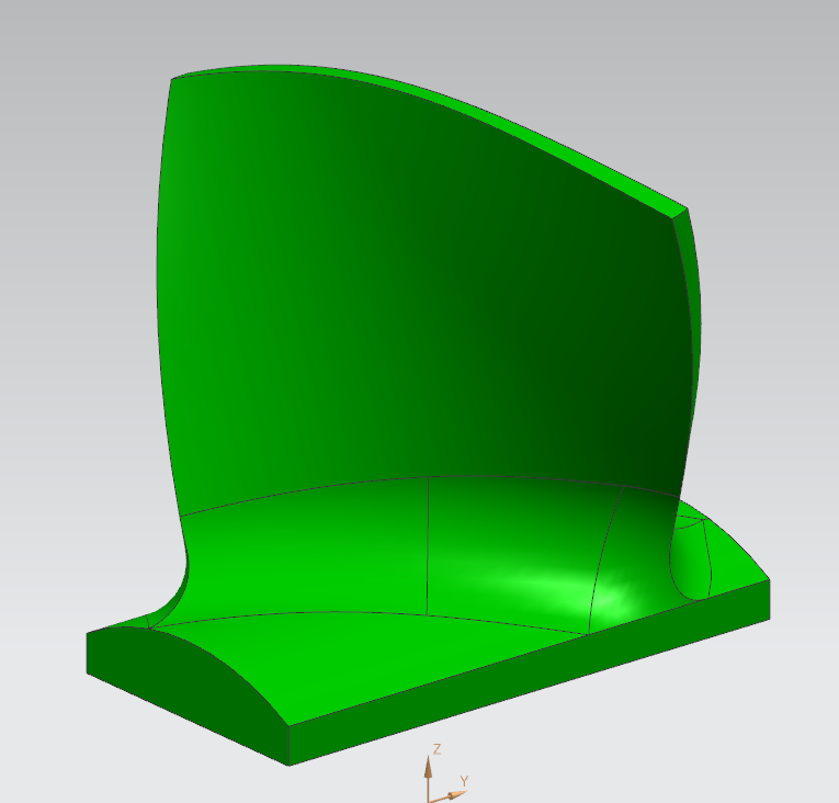

Grotius post=232906 userid=23278嗨,我测试了 gcode,预览对我来说似乎还可以。https://user-images.githubusercontent.com/44880102/150702166-d3bb010b-47d7-4201-b948-8af0d7c784f9.mp4Thank you for your test, but the result is not correct, the two ends of the blade are disjointI have attached a demo of my model to make it easier to understand
Thank you for your test, but the result is not correct, the two ends of the blade are disjointI attached a screenshot of my model to make it easier to understand
