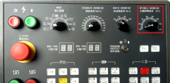

Hi everyone, I need a little boost and help.
I need a manual knob to set the feed override and spindle speed override. But I only found M48-M49 these M codes, I want to implement a manual knob on the operation interface to achieve this function.
Where should I go to see these things? Hope someone can help me.
Thank you all in advance.Similar to what the picture below shows.

Replied by rodw on topic Can the feedrate override function be set manually?
Hakui has pins to support that
linuxcnc.org/docs/devel/html/man/man1/halui.1.html
