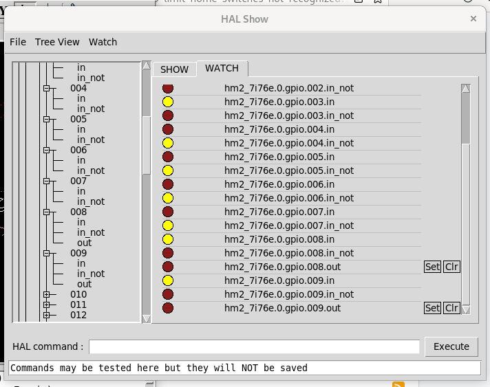

- Posts: 4811
- Thank you received: 2164
13 Feb 2022 20:13 - 13 Feb 2022 20:16 #234737
Replied by Aciera on topic Limit/Home switches not recognized
No point in connecting the proximity sensors if it's not working with the mechanical switch.
So if you setup a halshow watch on all inputs of the 7i76e and use the mechanical switch (or even better just a wire) on each input in turn, can you see any changes in halshow?
Could you maybe post a screenshot of the halshow 'watch' window?
Also note that you want to make the connection to the cage inside the connector on the board and not just to the screw.
[edit]
Don't know the answer to your last post. Seems strange that some signals would work but others not.
[edit]
Last edit: 13 Feb 2022 20:16 by Aciera.
The following user(s) said Thank You: Jalapeno56
- Jalapeno56
- Posts: 101
- Thank you received: 17
13 Feb 2022 20:35 #234743
by Jalapeno56
Replied by Jalapeno56 on topic Limit/Home switches not recognized
Just a wire from the power supply to each of the pins yields no changes on halshow. I even pulled the green connector to ensure I was making contact with the pin on the board. Attached is a screenshot of the halshow pins I've been trying. I have also tried the inputs on TB5 with the same result.
My question on the last post was just some brainstorming trying to think of anything that could be causing this.
