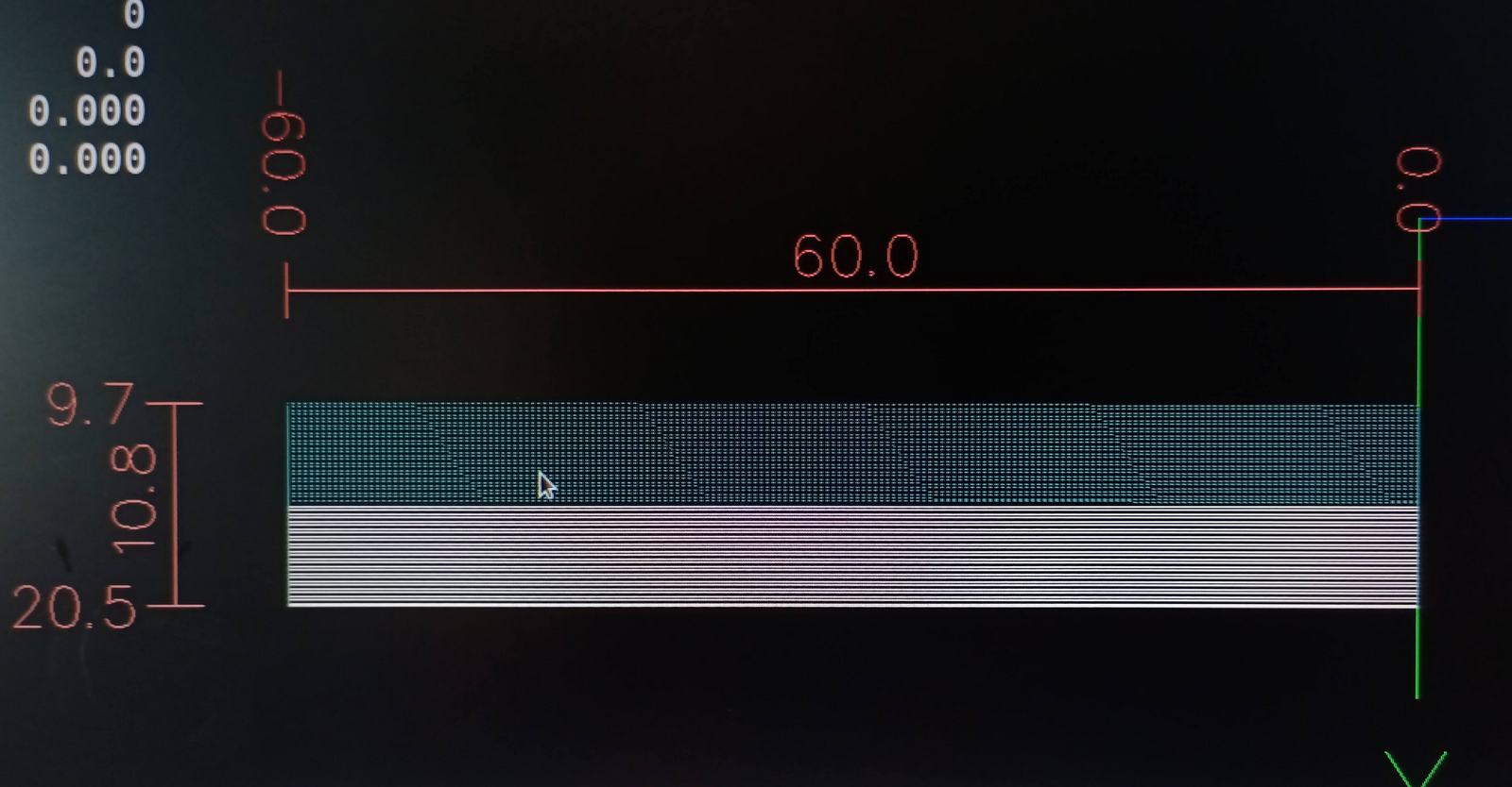

Is it possible to modify G76 so it actually stays on the drive line when doing retract path?
I have been using G33 for internal threading ever since because with G76 with every cutting pass you end up retracting further away for the driveline, so when you have small clearance between tool holder and bore diameter you end up running tool holder into the work after few retract passes
so now for whatever reason I want to use G76, can I modify source code to make that work properly?

g76 p10 z-60 i0.1 j0.4 k11
I think it should be G76 P10 Z-60 I-0.1 J0.4 K10
Figure 3. G76 Threading
- Drive Line - A line through the initial X position parallel to the Z.
- P- - The thread pitch in distance per revolution.
- Z- - The final position of threads. At the end of the cycle the tool will be at this Z position.
- I- - The thread peak offset from the drive line. Negative I values are external threads, and positive I values are internal threads. Generally the material has been turned to this size before the G76 cycle.
- J- - A positive value specifying the initial cut depth. The first threading cut will be J beyond the thread peak position.
- K- - A positive value specifying the full thread depth. The final threading cut will be K beyond the thread peak position.

no, I'm cutting internal thread

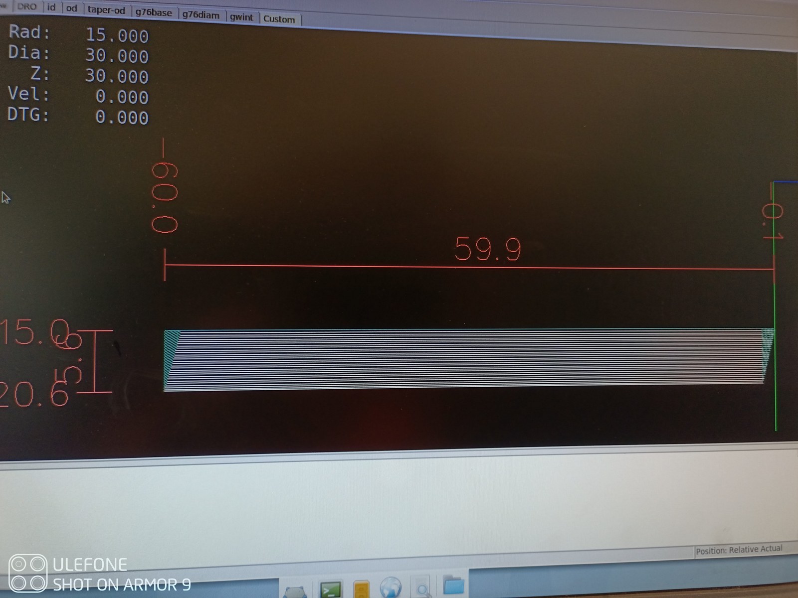

Replied by PCW on topic How can I modify G76 to make it actually useful for internal threading?
I may not understand but I think the retract drive line is moved
parallel to the cut driveline to equalize the sync time available
before the tool starts cutting.

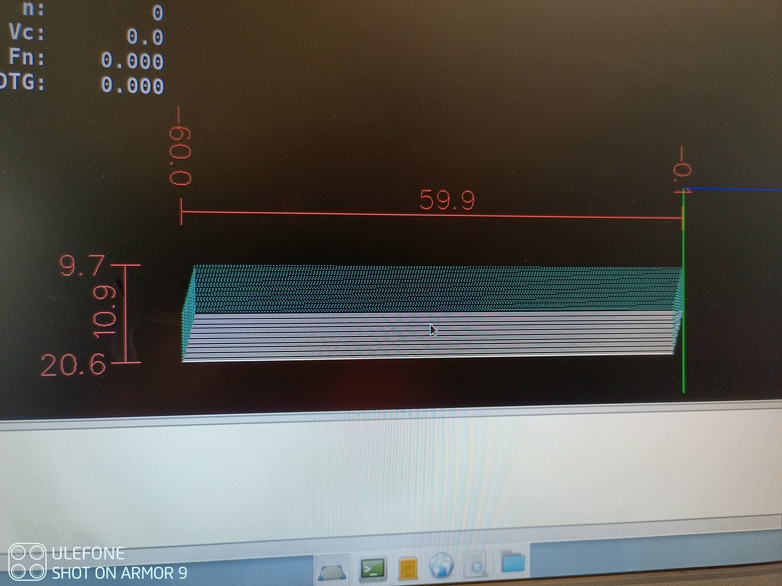

Ok I found solution for my problem,
11 years ago
www.mail-archive.com/emc-developers@list...ge.net/msg04863.html
now only if I knew how to recompile the source
11 years ago
