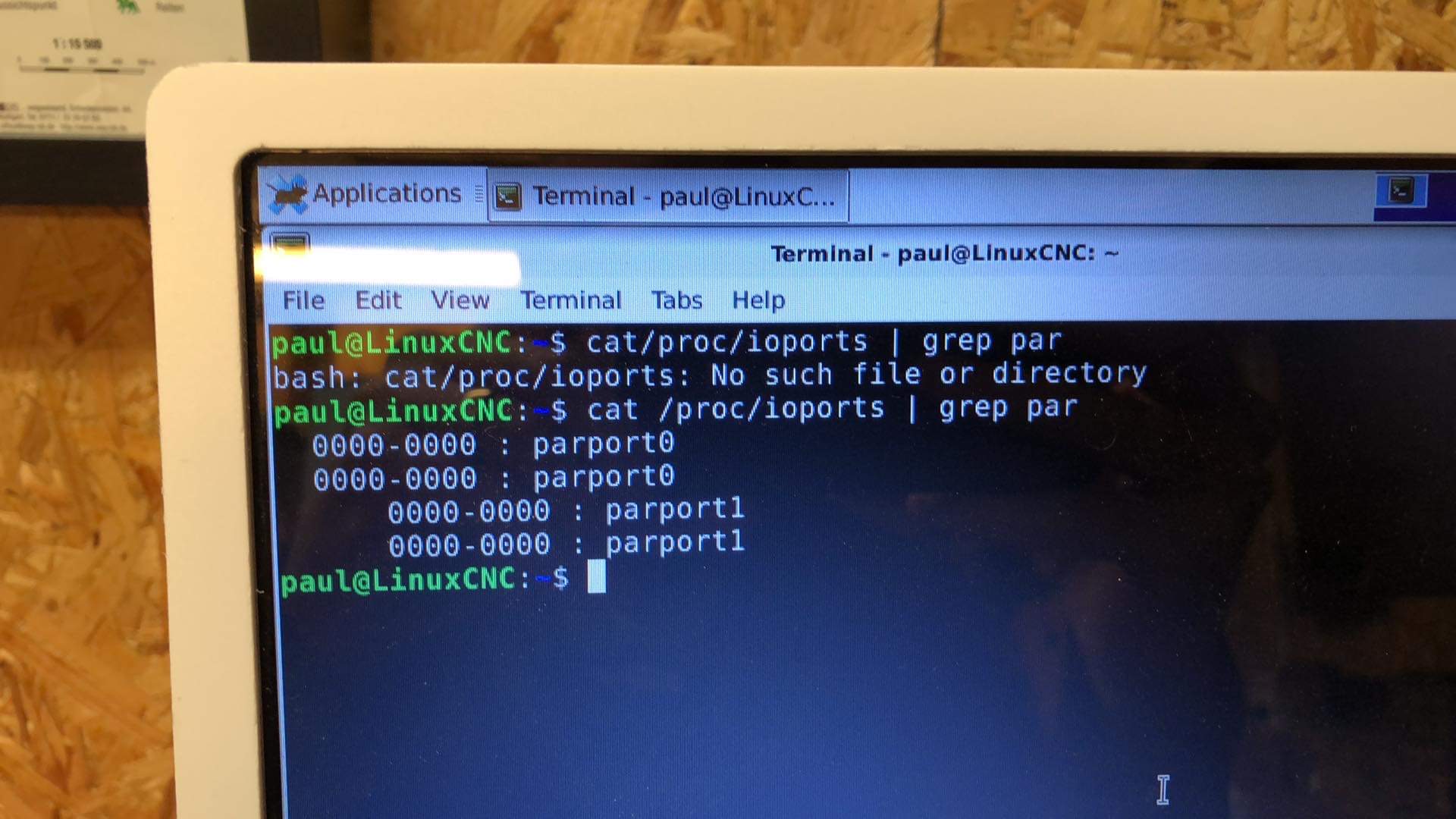

“In a terminal
cat /proc/ioports | grep parport
post the result”
Hi again!
I tried that yesterday and I only have a picture of the result but I attach it here. It finds both ports but I do not know if the result looks right, do, does it?
post the result”
Hi again!

Yes - you have 2 printer ports - it would not be 9 pin.. There is probably a header on the motherboard.. (see picture)
photos.app.goo.gl/UHVroBCd5H4jey2x8
I did a command for my pci printer port card... You get a punch of output - you should see something like this..
sudo lspci -vnn
01:00.0 Communication controller [0780]: MosChip Semiconductor Technology Ltd. PCI 9835 Multi-I/O Controller [9710:9835] (rev 01)
Subsystem: LSI Logic / Symbios Logic 1P2S [1000:0012]
Flags: medium devsel, IRQ 20
I/O ports at e050
I/O ports at e040
I/O ports at e030
I/O ports at e020
I/O ports at e010
I/O ports at e000
Kernel driver in use: parport_serial
Kernel modules: parport_serial
I just started going down the ports until I found the one that works..
loadrt hal_parport cfg="0xe030"

I am very glad to tell you that the mystery is solved!
It was my friend who did it so I am not sure I can describe the solution in great detail but I will try.
Line 8 or 9 in the HAL-file says:
loader hal_parport cfg=“0x378 out “
which instructs LinuxCNC to use parallel port 0x378.
My computer did not have a parallel port called that so we had to change the line to:
loader hal_parport cfg=“1 out “
which made LinuxCNC to use the correct parallel port.
I don’t know if it was the best or only solution but it seems to work just fine. Thank you for all the help you have provided me with, I really appreciate it!
