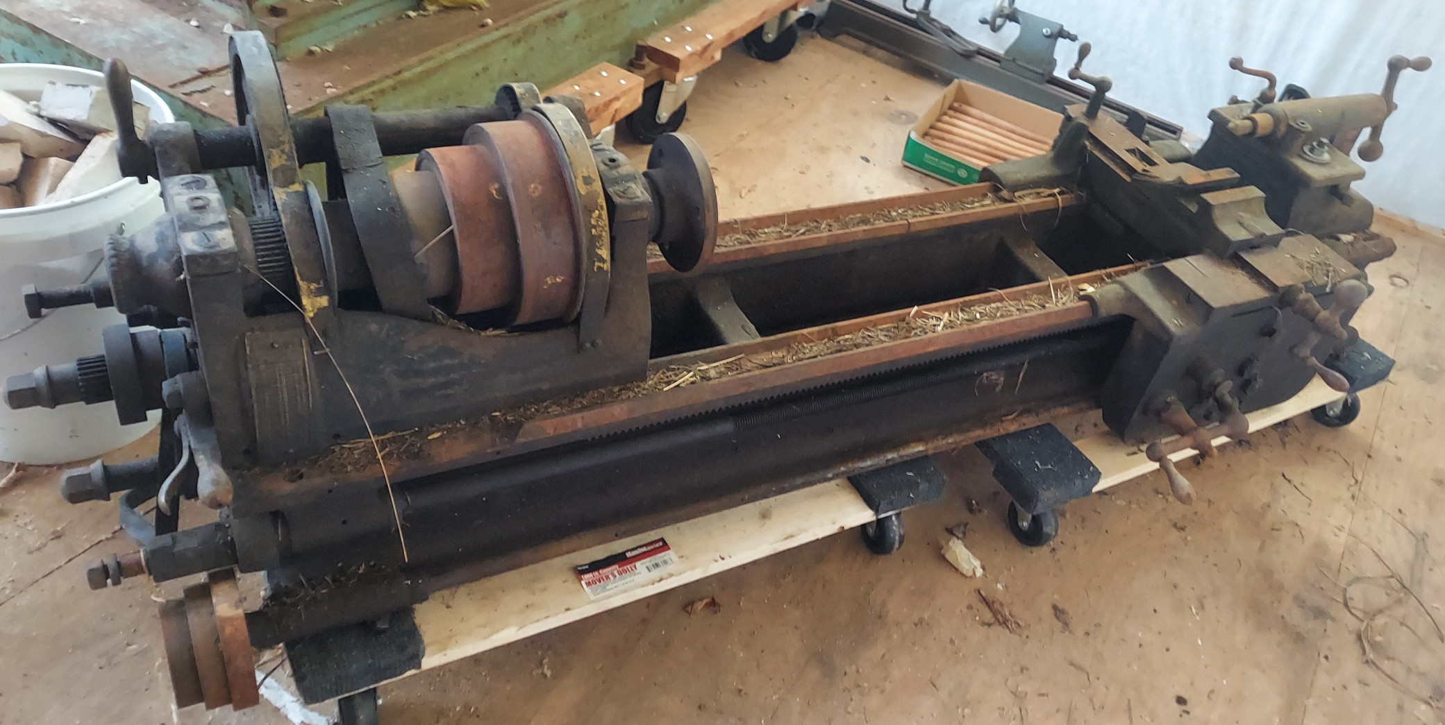

2 machines keep crossing mind. A mill and lathe. Making either of them CNC would make my year. Honestly, I would have to set aside time for them and I might finish one in a year. Perhaps, the one that would be the most important would be the CNC lathe, but I am unsure how to be able to configure it to be able to create threads without some sort of closed loop on the spindle. Also, multiple tools (would this be done with offsets?) or a tool changer would be fantastic

Do the lathe, lathe retrofits tend to be easier.
You don't need closed loop control of the spindle for threading. You just need a spindle encoder and then the axes move to follow the spindle. (even if you are turning the spindle by hand)

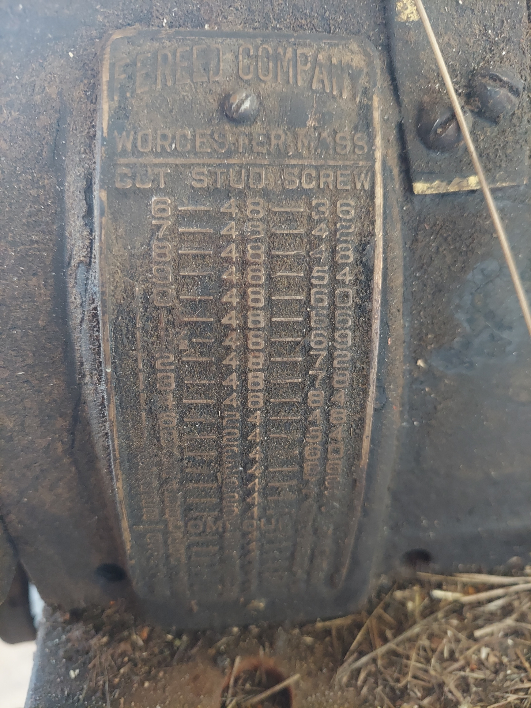

How old is the lathe? All the F E Reed I can see online are Victorian...

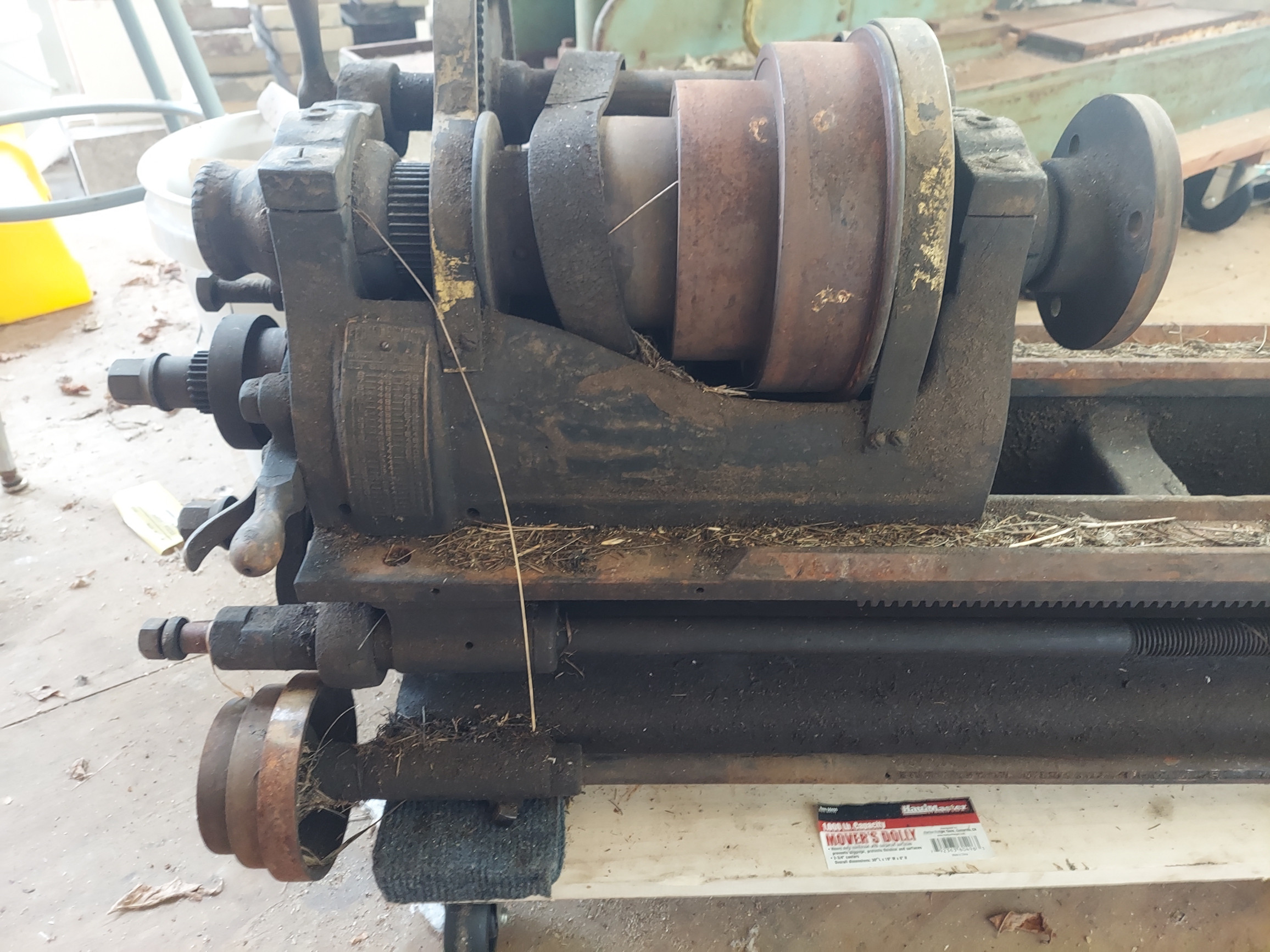

LOL...true. I hadn't thought of how old the lathe was, just that it was a lathe. Calling it "Victorian" puts it into perspective for me. The spindle does rest within babbit bearing material. I did see a 901 on the lathe once. I'm not sure if it was actually 1901 or serial number 901. It is my understanding that babbit supported spindles are more accurate than ball bearing races when they are of proper clearances and lubricated. My question is how much power will be required to turn the spindle. This is why I suspect I may need a powerful spindle motor to overcome friction and automatically adjust IPM speeds to efficiently cut parts as large as the lathe will allow all the way down to center.
Not a lot. It was common to have lathes powered by foot-treadles at the time.
A 1/2hp induction motor would be plenty for such a lathe running directly from the mains. I would perhaps go to 1hp for running below rated speed with a VFD. The structure of the lathe is probably not stiff enough to use much more than that.

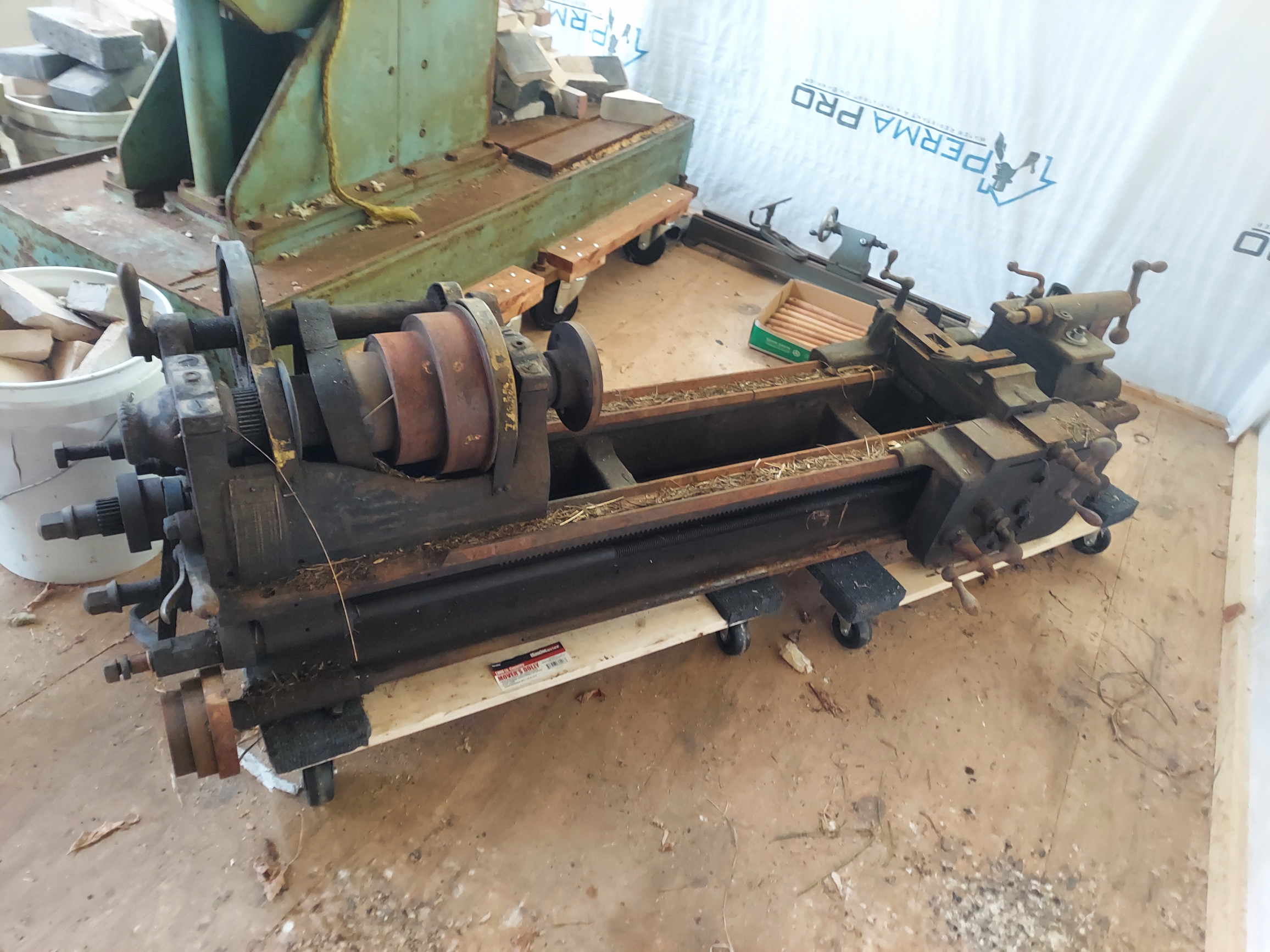

Do you have a picture of the lathe?
You could even consider taking a set of photos and sending them to Tony Griffiths at www.lathes.co.uk which seems to have a gap in its database where F E Reed is concerned.

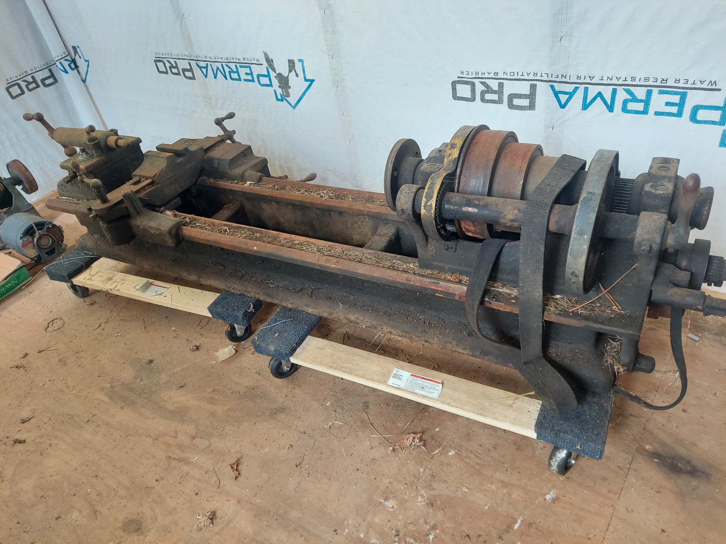

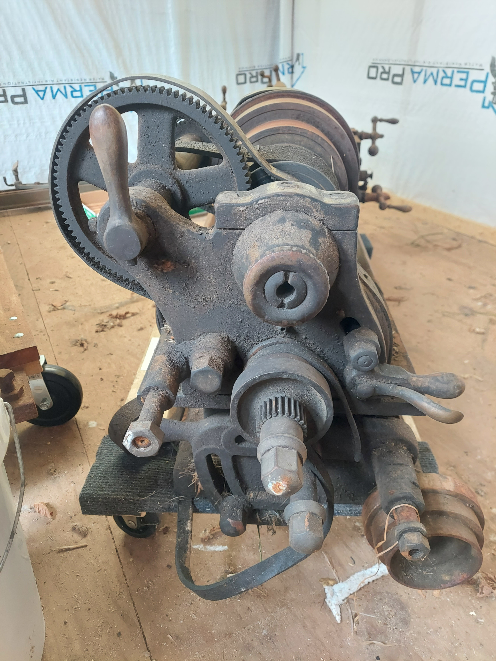

This lathe is not the dainty lathes you might see in the images found online of the FE Reed lathes. While certainly of the Victorian era, it is not small like those I have seen elsewhere. It is bulky and heavy enough two men don't want try to lift it. When I bought it, the seller said the legs had already been sold to make a table. "Oh, POO!" I said as I saw them leaning against his house awaiting the buyer to arrive. Well, for $100, it would still be a nice project I could build and learn CNC on.
If the lathe can be identified, I would appreciate the information. Also, as I will not require the parts removed to make my lathe CNC, anyone that needs parts to restore their own lathe, I am willing to part with the parts for the cost of packaging, shipping and, if the buyer desires, a small gratuity ;)
My lathe has sat for a while and will need to be cleaned up but everything moved when it was stored. I will need to determine what is required for use as a CNC lathe. The remaining parts will be stored if not requested by someone else.

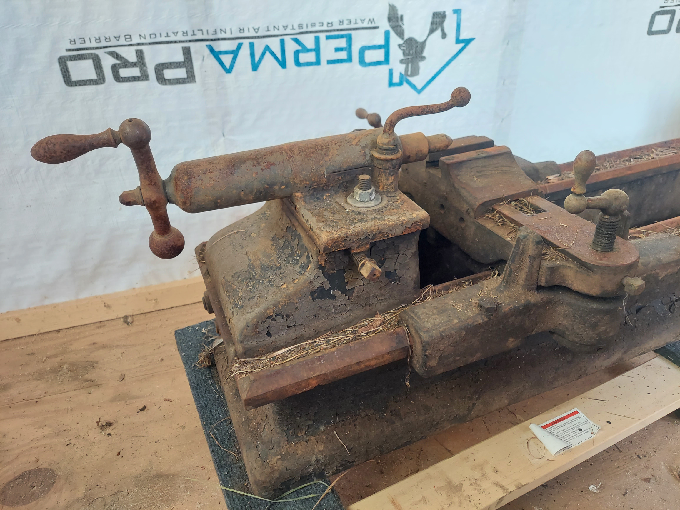

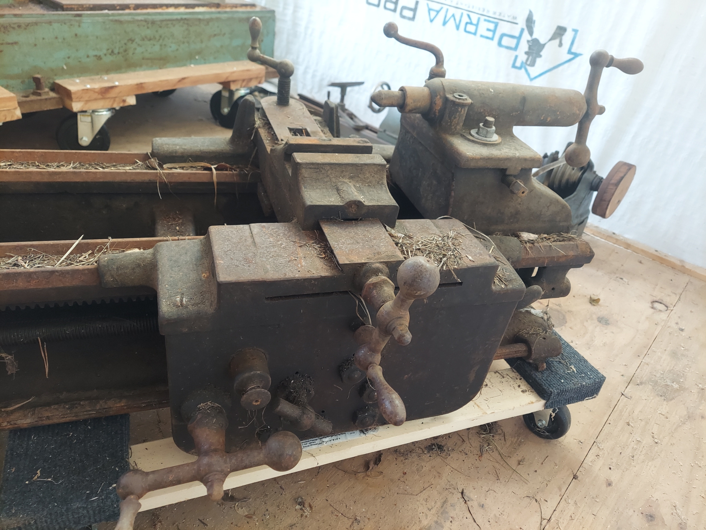

The vertical adjuster on the cross-slide is unusual. And inexplicable.
08 Apr 2022 20:13 #239695 by aefriot
Replied by aefriot on topic Have hardware...would like CNC
It adjusts the height of the cutting tool to the proper height for cutting. At least that is what I can think of. Before the assembly line and factories making all parts identical, there seemed to be a need for height adjustment. Cutting tool holders from differing manufacturers were often of different heights. Therefore, this was a simple way to adjust the cutting tool height rather than relying on shims under the tool holder in the lantern? There was an adjustment screw on the 1890 Cody lathe I owned as well. That lathe was small enough for two men to easily move about. Attractive too!
But it seems to tip up one end, so it would only be right at one diameter.

11 Apr 2022 17:25 #239941 by robertspark
Replied by robertspark on topic Have hardware...would like CNC
en.m.wikipedia.org/wiki/Francis_Reed_(inventor)
explains the pivot below:
www.hobby-machinist.com/threads/old-f-e-...h-metal-lathe.55201/
think it's called an "elevated rest"
archive.org/details/FEReedLathes/mode/2up
(learned something new, nice bit of kit)
