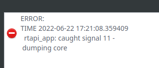

22 Jun 2022 22:00 #245617
by spumco
Replied by spumco on topic ATC Project - (not again...)
Ok, so motor-vel is an output. No low-hanging fruit there.
Noticed that carousel had 18 sense pins in halshow. Checked the hal file and sure enough, I had
loadrt carousel ... num_sense=18
Figured it couldn't hurt to fiddle around and dropped that down to 1; I've only got 1 pocket/index pin, right?
Then I start getting this:
and LCNC starts locking up and getting really laggy. Have to shut it down, can't really do anything (jogging, mode selection, MDI).
Edited hal again to num_sense=18, and the error goes away.
Tried with num-sense=0, error gone. What the heck?
Also... narrowed the continuous rotation error down to the following speeds:
fwd-dc=28, it acts as intended (one pocket)
fwd-dc=29, it rotates at least one extra turn
rev-dc=-31, ok
rev-dc=-32, extra rotations
Odd.
