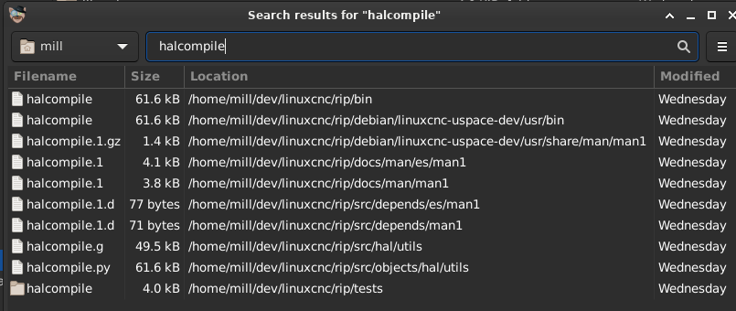

Thanks Tommy. Navigating to the folder and adding the ./ seems to get it working.
Still got an error - just seeing if it worked - but at least it's responding.
I've attached a screenshot of the catfish search results. Would you mind having a look and seeing if it looks like I've got multiple installations or some other new user screwup? While I'm starting to pick up on LCNC a little, Linux is still driving me crazy.
Andy - the update.sh script is the one from the github site I downloaded, right?

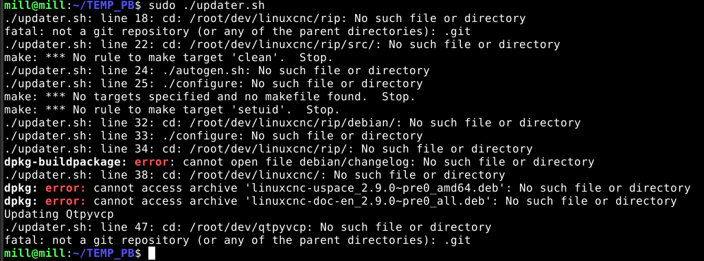

Ran the updater script.
- Posts: 21901
- Thank you received: 7465
22 May 2022 02:06 #243524
Replied by tommylight on topic ATC Project - Debug phase
FIY, next time you install Debian, when it asks for RooT password just click next.
You are running as root on a Linux box, most user software is made to be used as a user not an admin(root in Linux).
