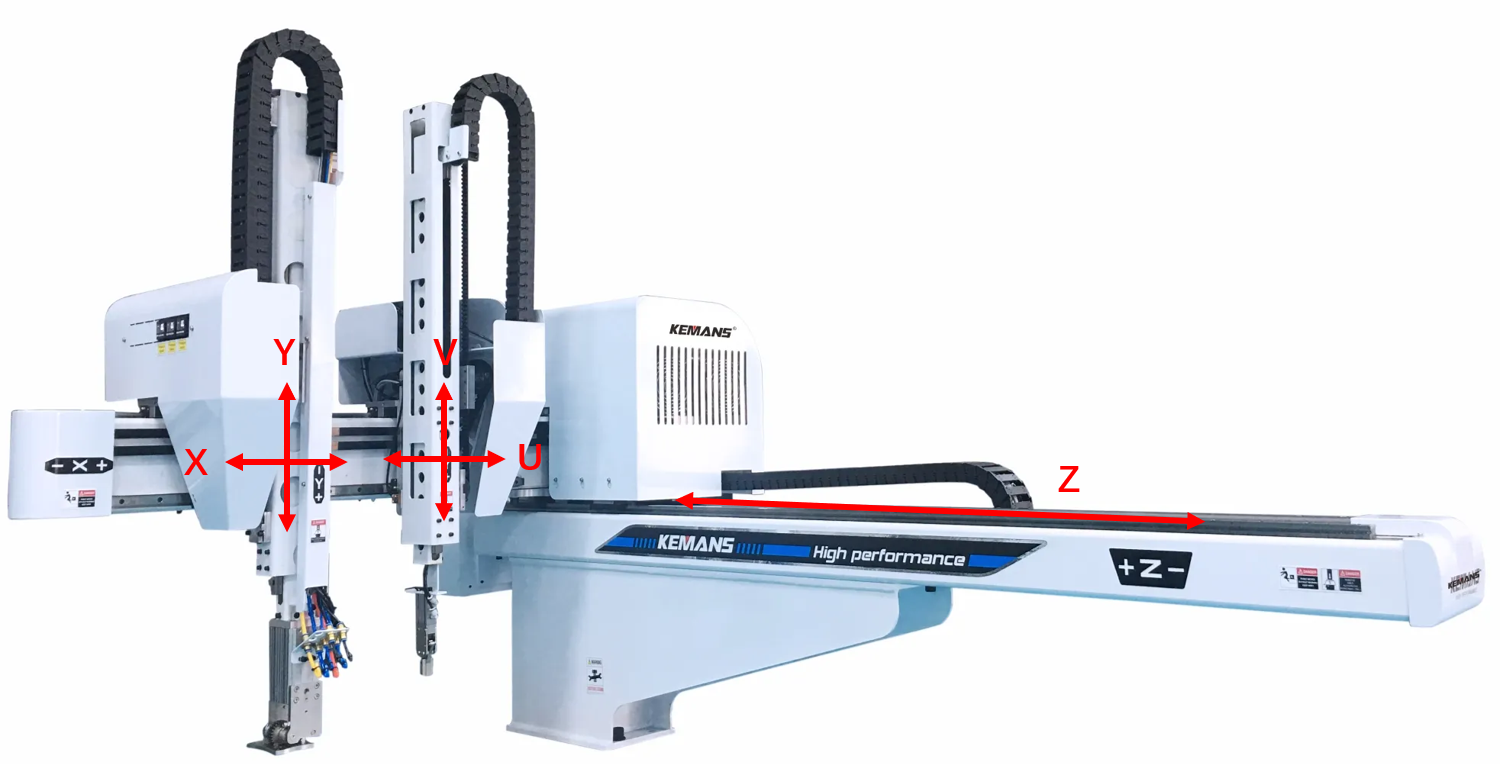

Hi
GCODE is interpreted one by one, next motion command won't be interpreted until last one moved to target position.
I got a situation that two independent motion sequence need to move at the same time.
For example, While X axis is moving to 100, U axis is moving to 200, and after X axis is in target position, Y axis need to move to 100, same in V axis, need move to 200 after U axis is in target position.
Such as following GCODE, o1001 and o1002 need to move at the same time.
o1001
N1 G01 X100 F1000
N2 G01 Y100 F1000
o1002
N1 G01 U200 F1000
N2 G01 V200 F1000
Is there anyway to implement it in linuxcnc?

- Posts: 7341
- Thank you received: 2164
12 Apr 2022 04:10 #240007
Replied by cmorley on topic How to implement two independent motion sequence moving at the same time?
If you mean something like a twin turret lathe that moves the turrets independently but coordinated - then I would say no.
But could you explain more about the machine or a pic?
- Chase13
- Posts: 4
12 Apr 2022 04:25 #240008
by Chase13
I am developing injection molding machine manipulator with two arms, X/Y and U/V can grab products at the same time to enhance efficiency.
Replied by Chase13 on topic How to implement two independent motion sequence moving at the same time?

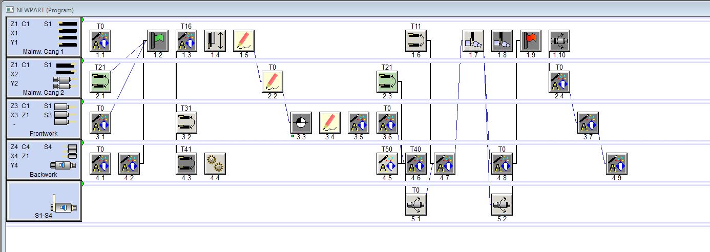

- MJZRPR
- Posts: 1
24 Apr 2022 16:21 - 24 Apr 2022 16:24 #241077
by MJZRPR
Replied by MJZRPR on topic How to implement two independent motion sequence moving at the same time?
hi
swiss type machin is good example for this topic.
swiss type machine with two spindle
swiss type machin is two (or more) cnc station. each work separately. Except in cases where the part wants to be moved, the two station are separate. Only when cutting the part, the two spindles should have same speed rpm.
On older machine , the G-codes of the two stations were merged, and the path of all the axis was created in a file every 10 milliseconds and transmitted to the machine. In this case, the G-codes are not displayed at runtime.
merging axis to one file.
on newest machine. the controller separate to two controller.
newest controller with two station
Last edit: 24 Apr 2022 16:24 by MJZRPR.
