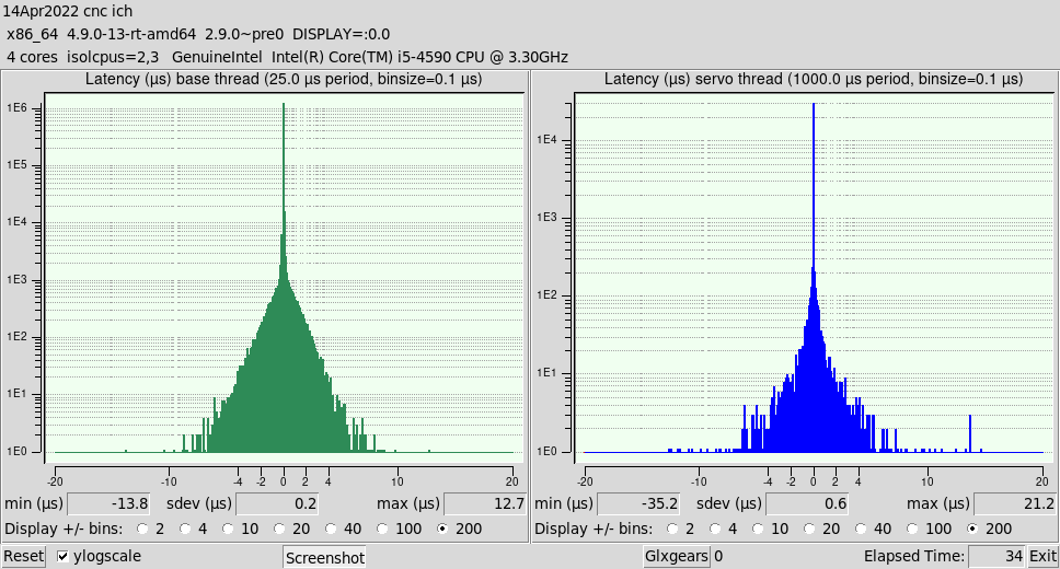

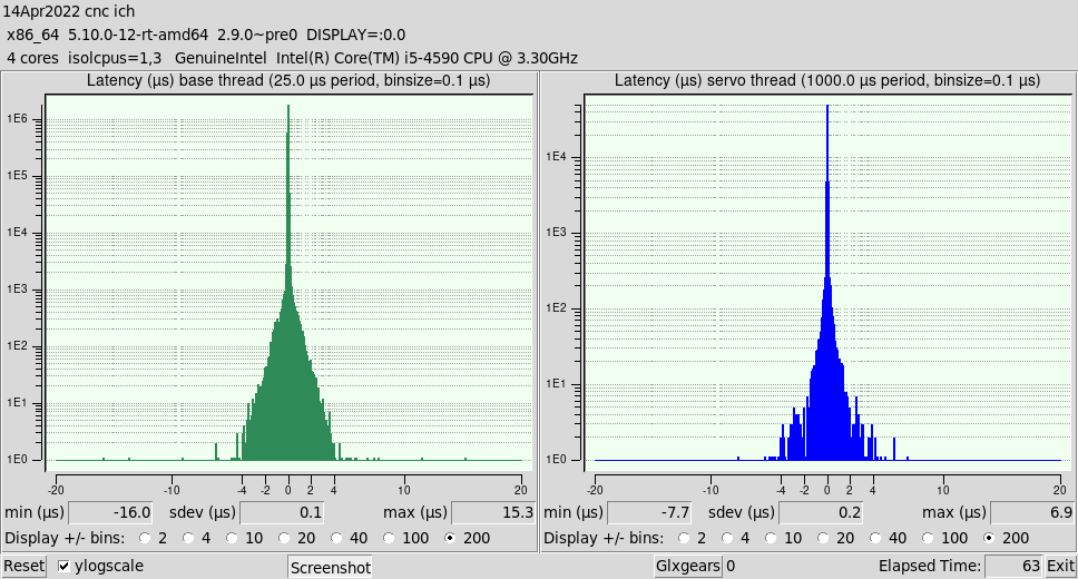

I wanted to investigate this in more detail and could kernel 4.9. and 4.19. install in bullseye.
Did some latency test today. Comparison of servo thread times with kernel 4.9, 4.19. and 5.10. The result is: I haven't measured the same times with any of them as with kernel 4.19. without isolcpus in stretch with linuxcnc 2.8.2 and the same hardware. The latency histogram looked in kernel 5.10. significantly better than under 4.9. but sporadically there are very large peaks in the servo thread. in 4.9. the peaks are only half the size. I guess there must be more why there are so big differences between stretch + linuxcnc 2.8.2 and bullseye + linuxcnc 2.9.
Does anyone have better times in master?
measured values in stretch + liunxcnc 2.8.2. + 4.19.0-0.bpo.18-rt-amd64 + noisolcpus
This was max data after one working day.
The network card is a PCI express card with rtl8111h chip but it seems r8169 driver is loaded
ping times and max servo thread
kernel 4.9.0-13-rt-amd64 and isolcpus=1,3 in bullseye and linuxcnc 2.9. last build
kernel 4.19.0-0.bpo.18-rt-amd64 isolcpus=1,3 in bullseye and linuxcnc 2.9. last build
kernel 5.10.0-12-rt-amd64 isolcpus=1,3 in bullseye and linuxcnc 2.9. last build

20 s32 RW 951840 servo-thread.tmaxkernel 4.9.0-13-rt-amd64 and isolcpus=1,3 in bullseye and linuxcnc 2.9. last build
64 bytes from 10.10.10.10: icmp_seq=9 ttl=64 time=0.135 ms
64 bytes from 10.10.10.10: icmp_seq=10 ttl=64 time=0.131 ms
64 bytes from 10.10.10.10: icmp_seq=11 ttl=64 time=0.130 ms
36 s32 RW 952614 hm2_7i76e.0.read.tmax
36 s32 RW 215580 hm2_7i76e.0.write.tmax
29 s32 RW 190532 motion-command-handler.tmax
29 s32 RW 285531 motion-controller.tmax
30 s32 RW 1456206 servo-thread.tmaxkernel 4.19.0-0.bpo.18-rt-amd64 isolcpus=1,3 in bullseye and linuxcnc 2.9. last build

30 s32 RW 1745328 servo-thread.tmaxkernel 5.10.0-12-rt-amd64 isolcpus=1,3 in bullseye and linuxcnc 2.9. last build
64 bytes from 10.10.10.10: icmp_seq=5 ttl=64 time=0.113 ms
64 bytes from 10.10.10.10: icmp_seq=6 ttl=64 time=0.078 ms
64 bytes from 10.10.10.10: icmp_seq=7 ttl=64 time=0.085 ms
36 s32 RW 2742591 hm2_7i76e.0.read.tmax
36 s32 RW 291285 hm2_7i76e.0.write.tmax
29 s32 RW 206667 motion-command-handler.tmax
29 s32 RW 278103 motion-controller.tmax
30 s32 RW 3067704 servo-thread.tmax
