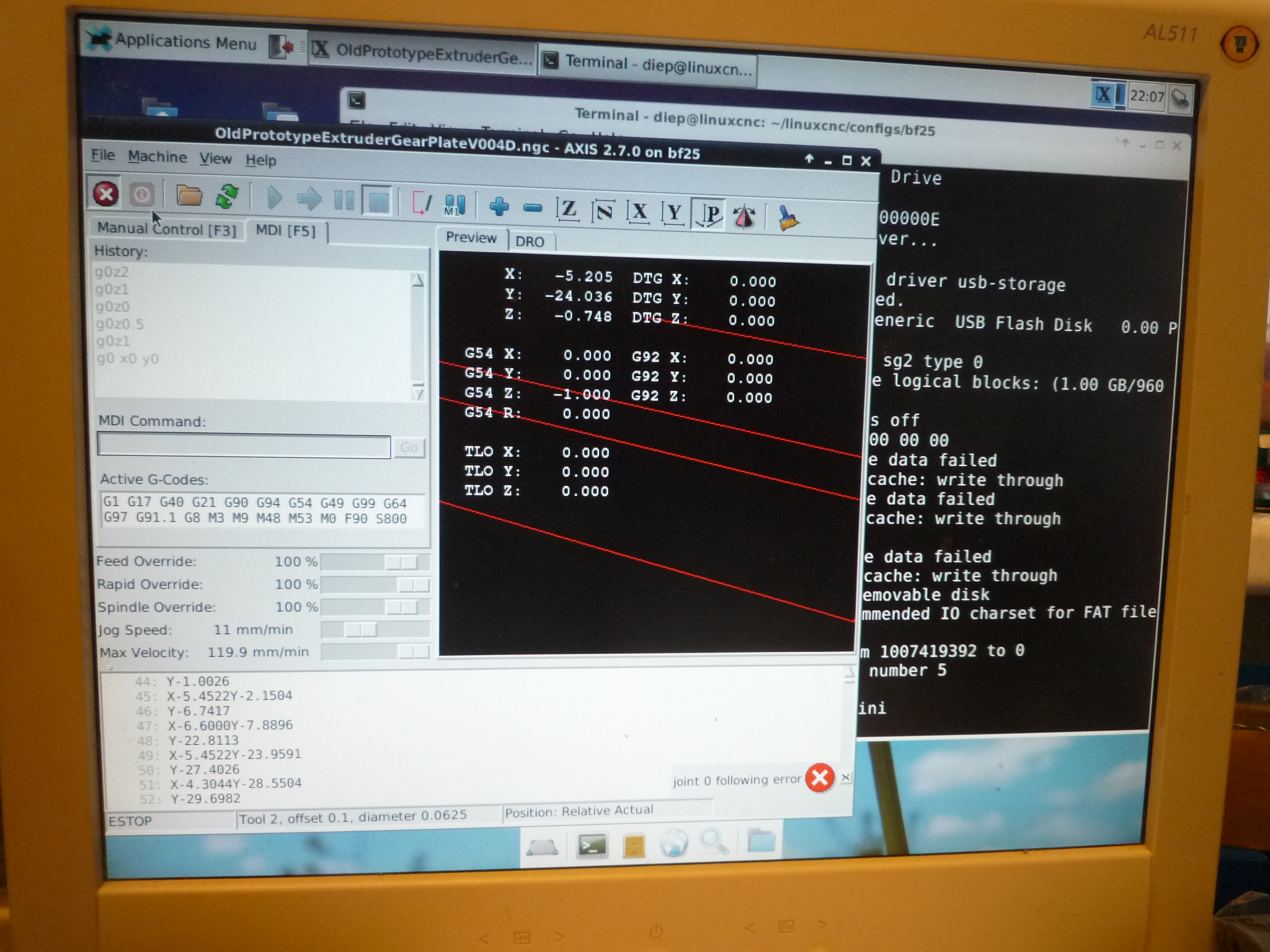

Hello!
I get each time after it starts program a joint following error.
most of time joint 0. sometimes joint 1 or joint 2.
This thing worked before like dream with linuxcnc.
What causes linuxcnc to display this error?

Usually this is a result of a joint setup error in the hal or ini files.
(Often the step generator is being asked to do something it cannot
so the feedback position lags the commanded position, causing
a following error)
Can you post your hal and ini files?

What LinuxCNC version is this?

At one of photos attached at first posting it is 2.7.0 i suppose.

MAX_ACCELERATION = 0.3
STEPGEN_MAXACCEL = 0.3
I believe the STEPGEN_MAXACCEL = 0.3 needs to be 25% more than the MAX_ACCELERATION. on each axis

If you have backlash compensation enabled
you must set the stepgen maxaccel value to double
the axis maxacceleration value

Seems have done the job putting those higher!!
Initial speed/acceleration values of machine were really slow. Had tuned those higher past days and then also modified the stepper motor driver values!
Much thanks - would never have figured that one out!
