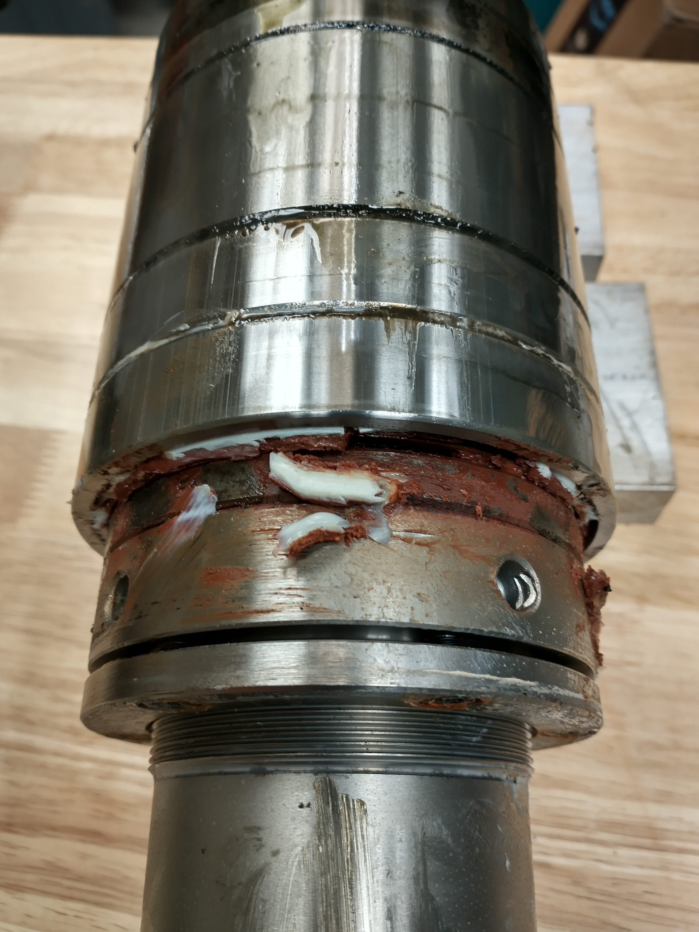

I just need more time to get QTD setup. I have analog 3D taster and tool setter so having a "tool touch off" button like Axis would be great. I want to get a full Renishaw probe system for this machine, the analog touchoffs work they are just a little slower. Hopefully I will get some time with it this week, spindle bearings are going out in that machine and I need to pull the spindle first and get a plan going on it.

Yeah spindle not happy. Lots of broken Belleville's which blows my mind how I still had good tool tension. That upper duplex bearing has checked out. The thickeners and oil have separated in the grease and killed the upper set. Tomorrow is looking expensive.

Yeah that looks a mess.
I replaced my spindle bearings about a year ago. The lower was a tapered roller and the top was a radial + ball thrust bearing. I replaced the top with a tapered roller. So far so good. The mill was designed to run 2500 rpm max. I'm running it at 5400. I replace the original motor and gear box with a DYN4 1.8kW servo motor geared 1:1.8 via a toothed belt.
